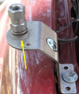

Been reading on here about the proper grounding. The mounting piece has a teflon spacer, and two washers. I need to know on which side of the mount these parts go. It would make the most sense to me to have them on the bottom (which is in the first photo) so that there is not a risistive material from the antenna to the mount, but I see others have the hardware on the antenna side.
Any help would be appreciated. I did steal these photos from the threads, so sorry if that angers anybody!
This is the way I did mine because it shorted out the antenna the other way.
