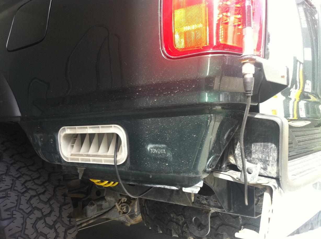

Just a photo for some of the people who wanted help running their coaxial cable. The vent that was mentioned earlier is pictured here, which normally hides behind the drivers side bumper end.
It is accessible without removal, so this photo is only for demonstration purposes. Mines gone because I was hit.
