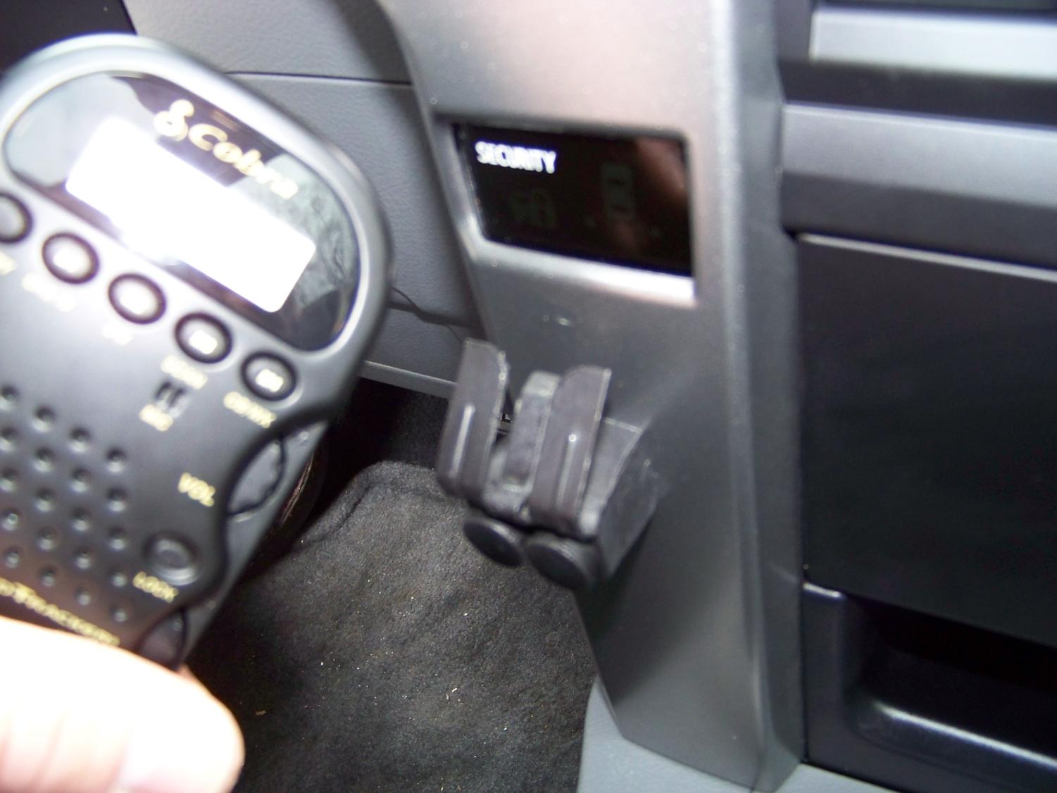

This is how I mounted my handset. Without the block, you can't see the display due to a poor angle. I made the block out of some stick epoxy. Mix it into a rough square shape.and stick it to the clip. Wait 30 mins for it to harden, and then use a belt sander to get the final shape. Then you just drill some holes and mount it...
