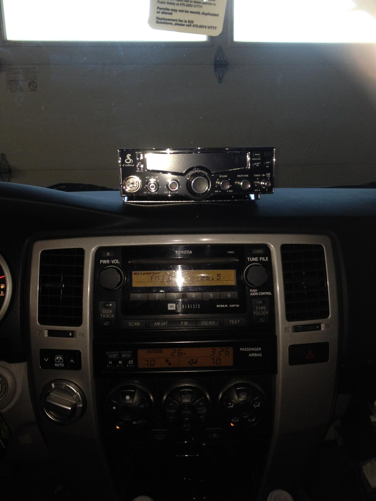

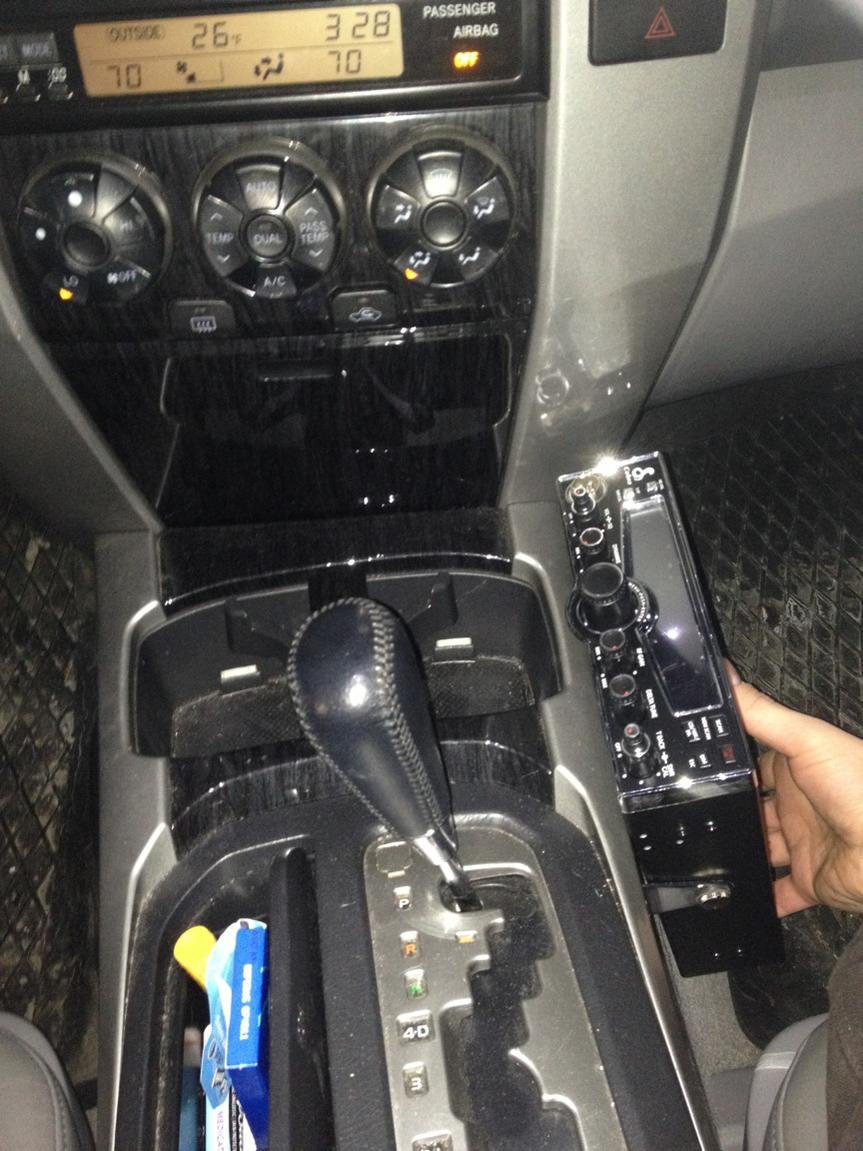

Im not completely sure the best place to mount cb radio unit. I see alot of people mounting near the center console, where as I like the dashboard mount. I looking for pros and cons of each mounting location. Also if anyone has other suggestions.

I had it in the second location for a while, but the passengers' knees always banged it and eventually messed up the mount.
Check out my build, I have my CB linked in the first post "CB install in useless pocket" or something similar. I really like it, clean and out of the way. Not sure if your CB will fit though. Having it on the dash there would drive me nuts, personally.
I vote down low. If you were to get in a crash, the lower it is the better. I have my Cb on the passenger side of my console and my VHF commercial on the drivers. I never have had any issues with my mounts.
It would also drive me crazy having it on the dash with the mic cord dangling around.

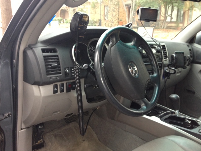

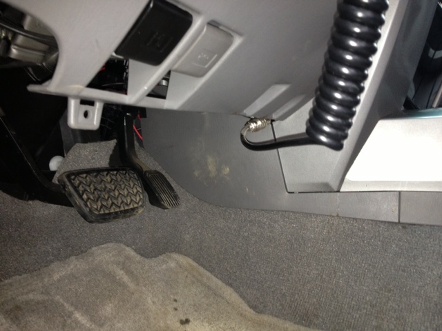

I bought the Cobra WX/ST (two piece unit) and mounted the box underneath and behind the dash. Very clean look. It was very easy to access by removing some of the trim and easy to wire in that location. I can also remove the mic and you don't know the CB is even there.
