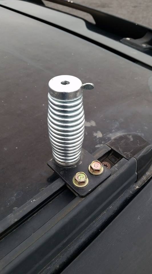

I made a little bracket to attach to my roof rack rails out of flat steel.
Then bolted this to it...https://www.amazon.com/gp/product/B005HJL94A/ref=oh_aui_search_detailpage?ie=UTF8&psc=1
And got this flag to stick in it (I cut the bolt end off)..https://www.amazon.com/gp/product/B004FR3380/ref=oh_aui_search_detailpage?ie=UTF8&psc=1
The flag with the bolt may work going through the CBI mount. I have broken too many of them to use them without a spring.
Thanks! That spring looks like it could work. I know it may be tough to tell from the image alone, but do you suspect I could get that spring bolt to fit through the (seemingly) small hole in the bracket I linked?
Pretty sure it will fit. Here is the mount on my son's 4runner for scale.
