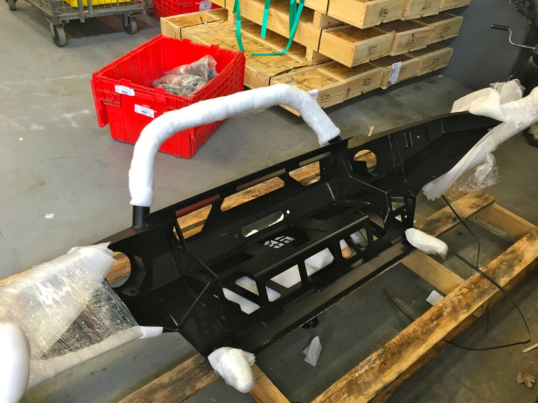

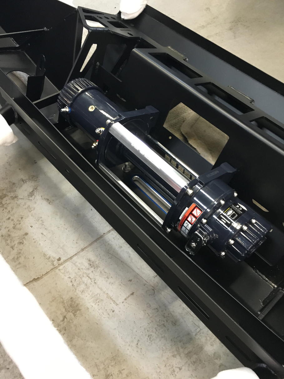

Couple more pictures of the front bumper. Began taking the solenoid off of the winch.

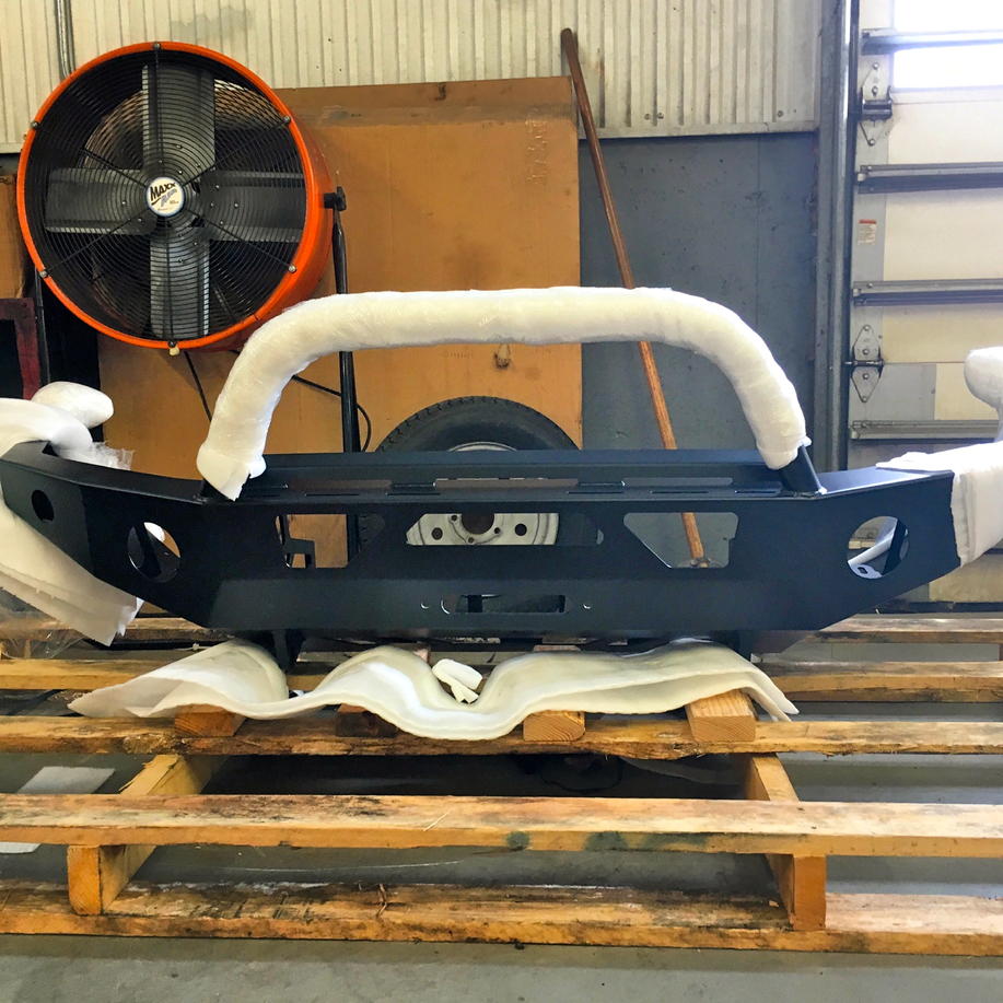

I like the design of the hoop on yours vs. the one I remember from their photos. I think it was a flat piece of steel that protruded out a little bit. This looks really nice. Excited to see it on your vehicle.
Yeah, I wasn't a fan of that design so I told them I wanted the traditional single hoop with just dom tubing.

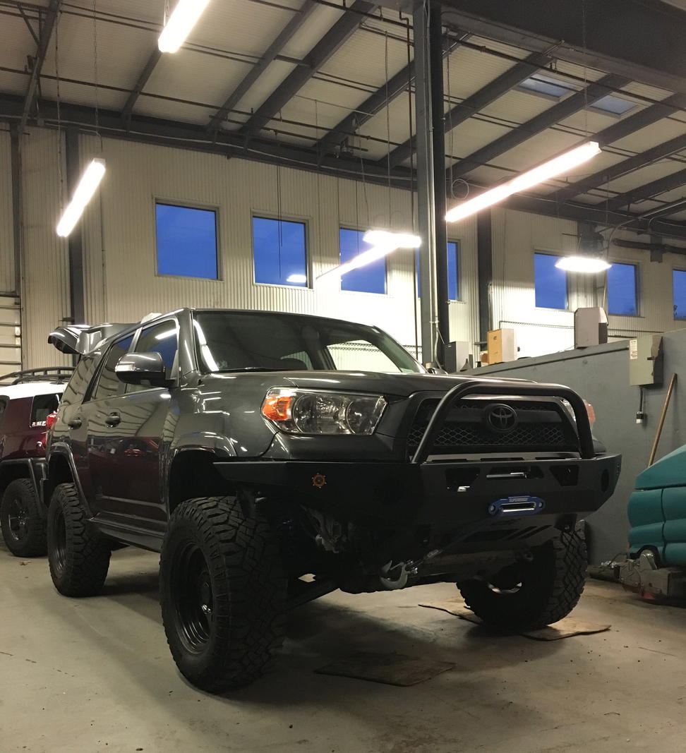

3/20/16 Front Bumper and Winch Installed
Big thanks to my friend Alex for his help with this.

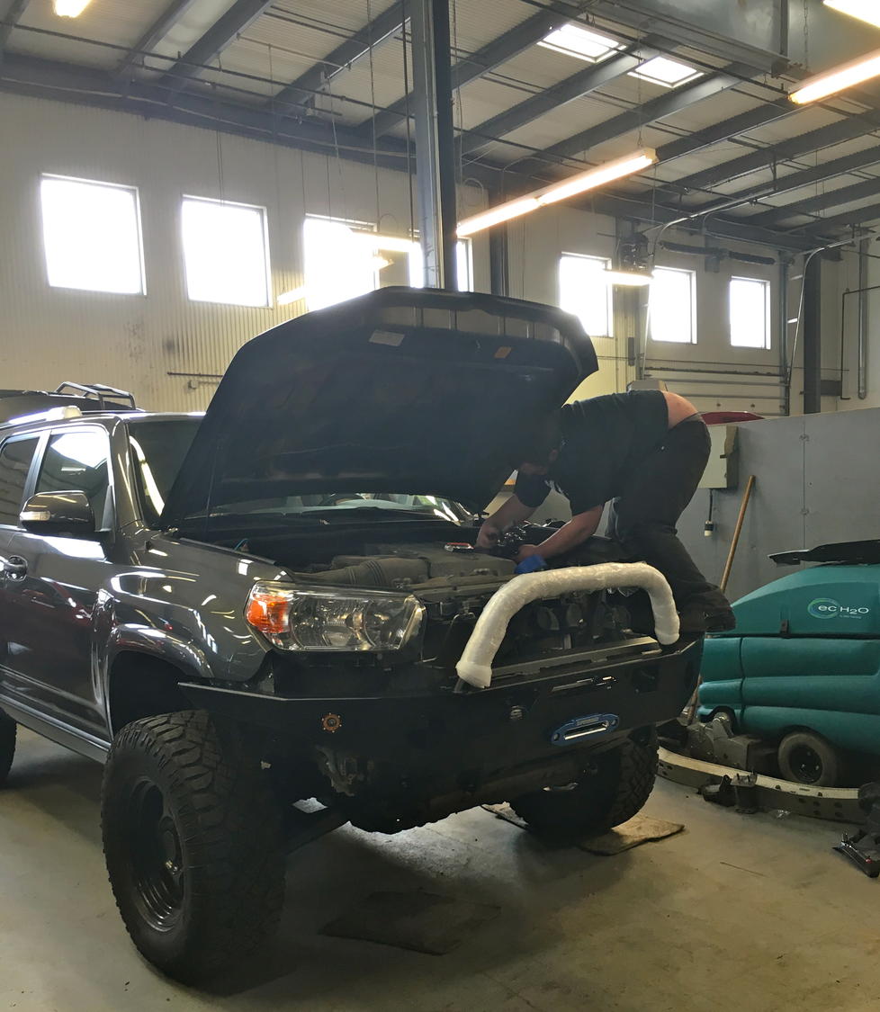

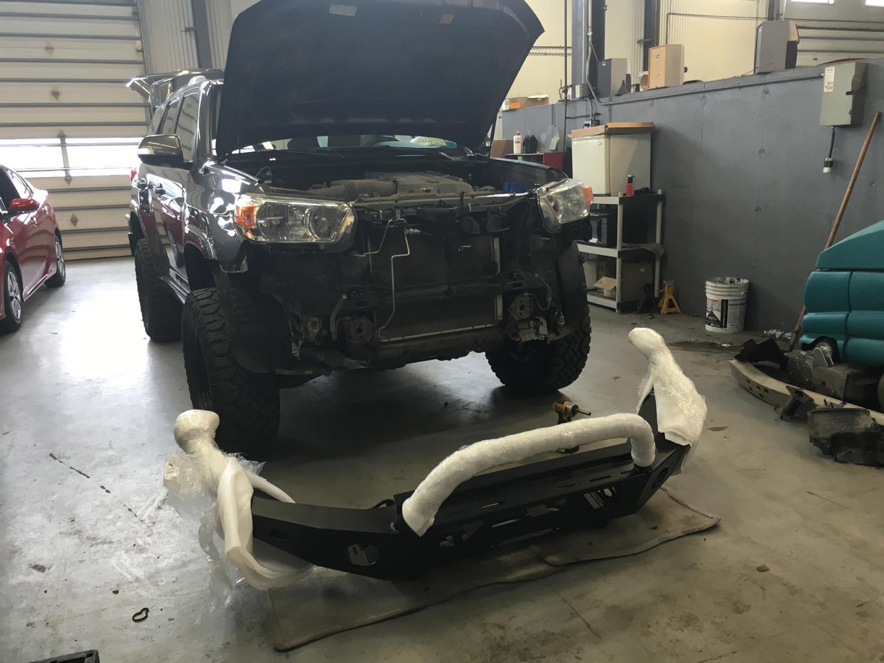

First we took off the front bumper cover and installed the winch and led markers/signals. Took the solenoid off and apart. Using the relocation kit, we moved the solenoid to the engine compartment which is what Alex is working on in the picture. Then we installed the bumper.

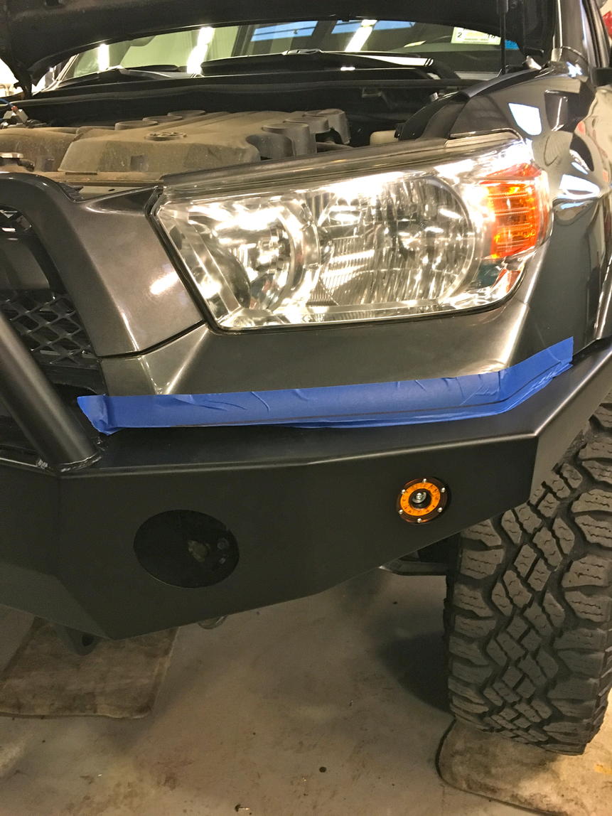

Bumper Install

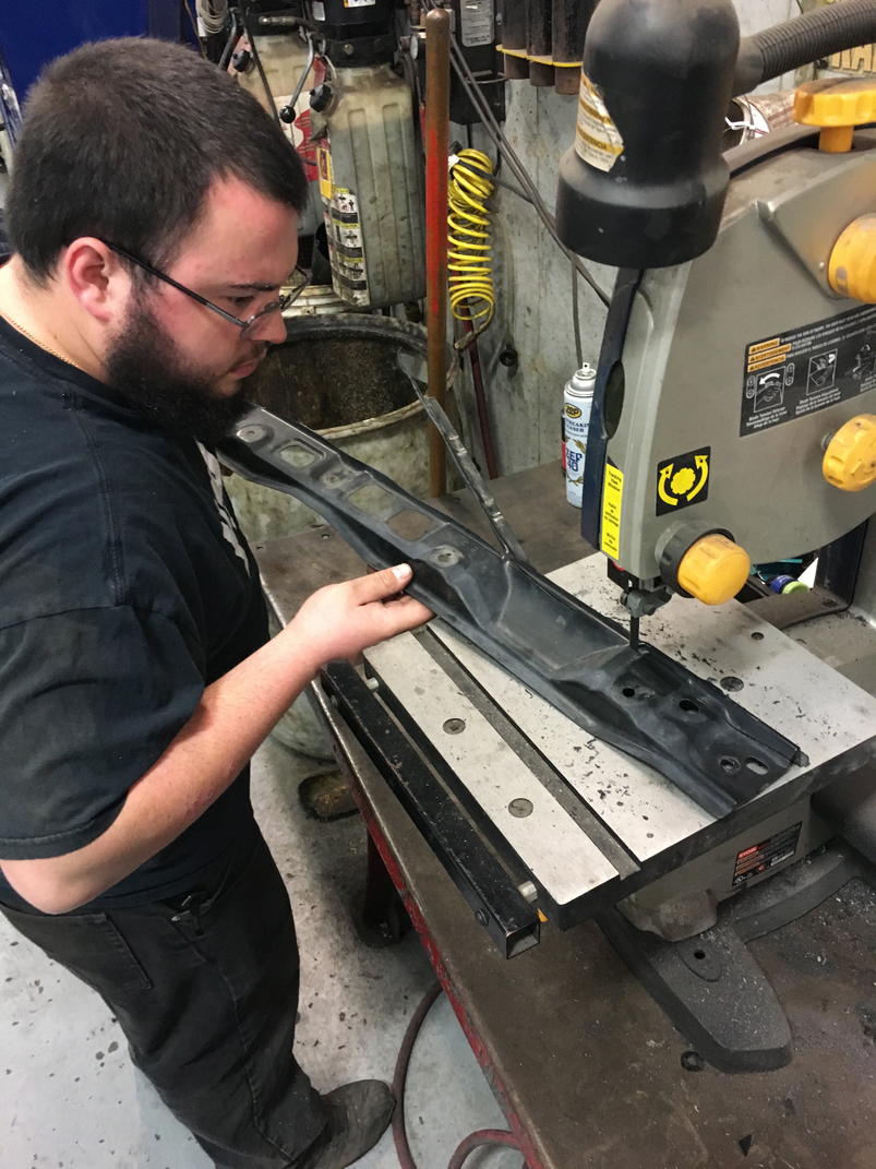

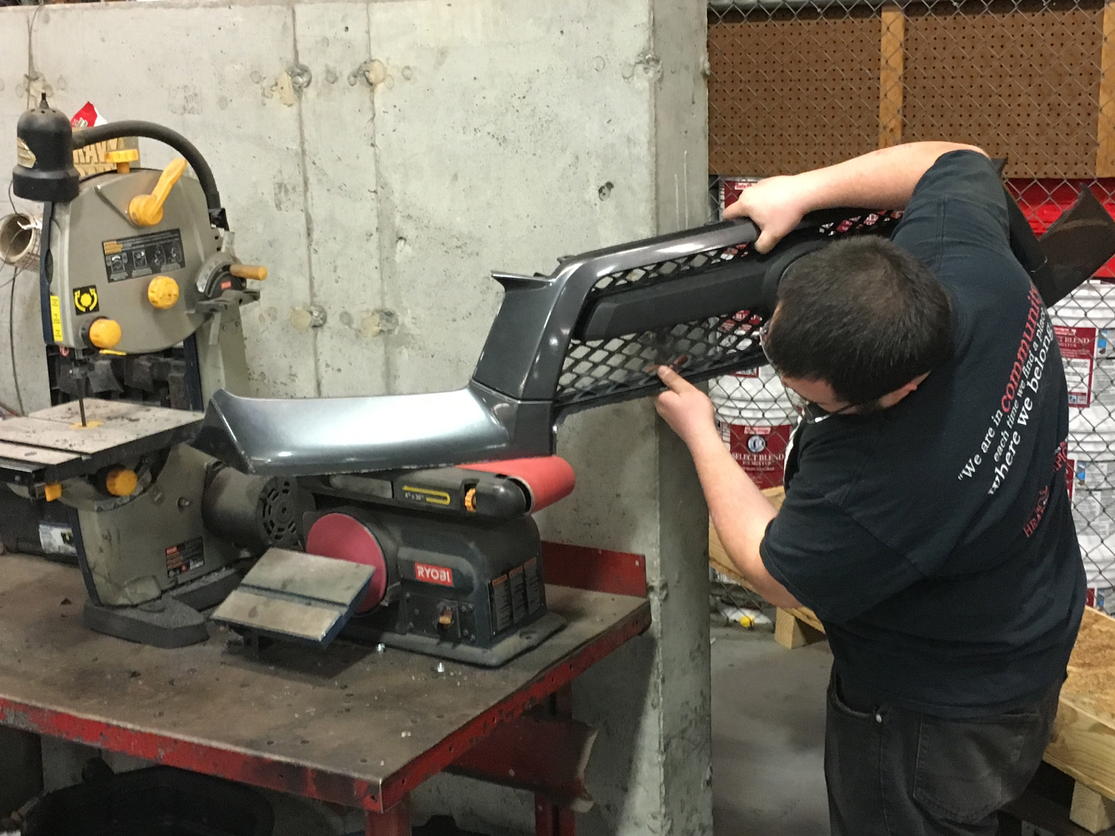

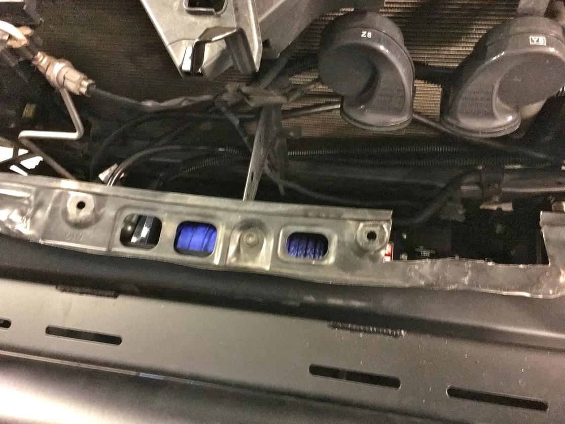

Once the bumper was installed, with the stock cover off, we cut it across with enough room for adjustment. There are no install instructions or measurements. Just a bag of nuts and bolts and two fog light brackets. It's pretty straight forward though. Once we had the cover cut, we took our time getting as precise of a fit as possible. Left the corners attached to the grill. It worked out great. Used a cut off wheel for the cuts to the bumper and then sanded it down on a table sander. We used a soft/fine grit paper. We went back and forth on this about 6 times making sure it was right. Not sure if I was supposed to get rid of the metal bottom grill mount but we did. Cut out a section so I could reach down to get to the winch engage/disengage lever. It's a difficult angle to lift up on the lever but doable do to the placement on this winch inside this bumper. I decided this would be a good idea if needed.

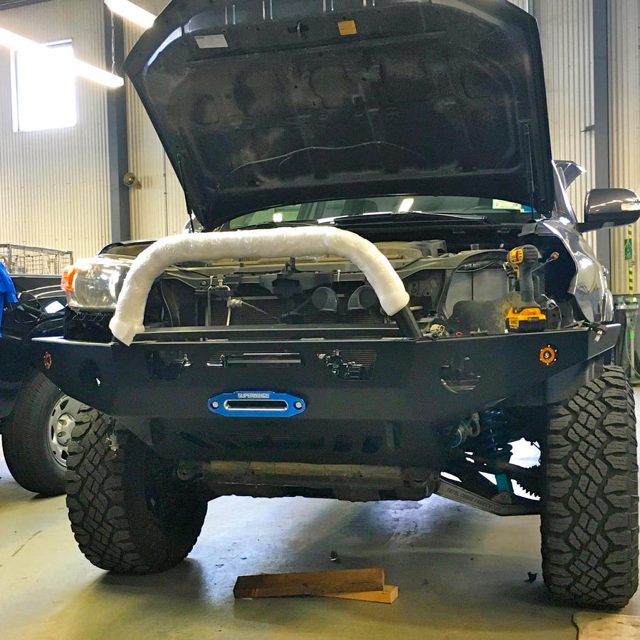

Bumper Install Continued

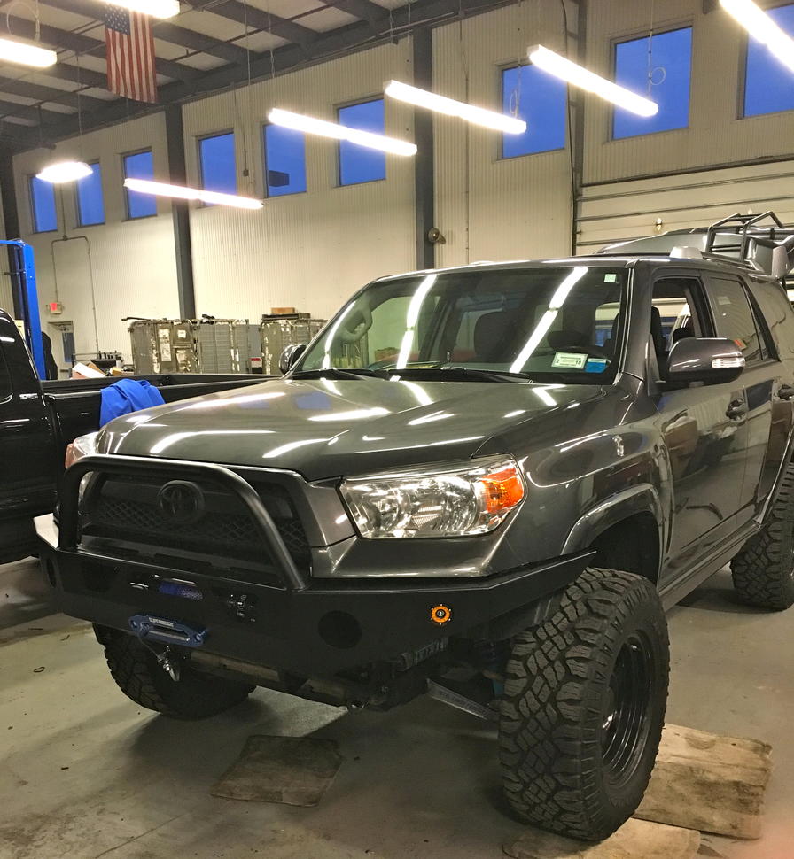

With the bumper on, we then spooled up the winch. Need to figure out which lights to put into the bumper.
