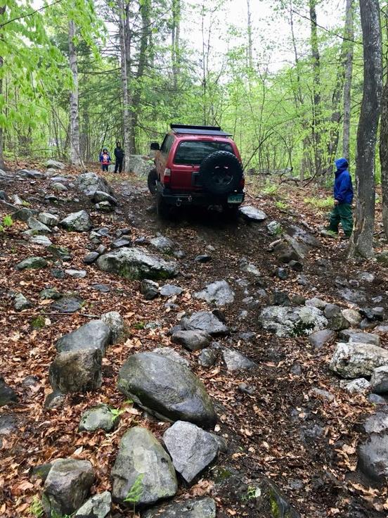

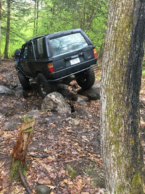

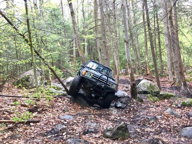

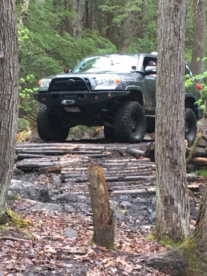

Yankee Toys Club Day 5/12/18
Another rainy wheeling day with Dave and Will.

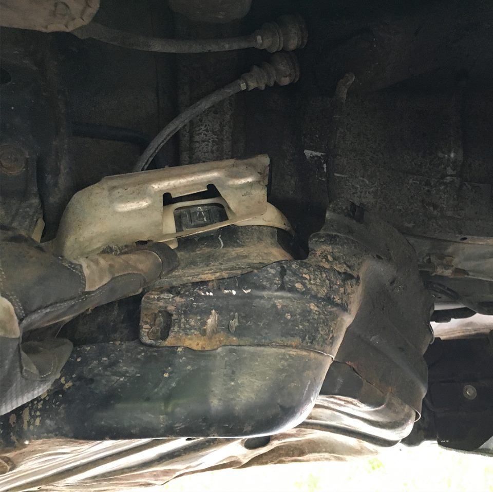

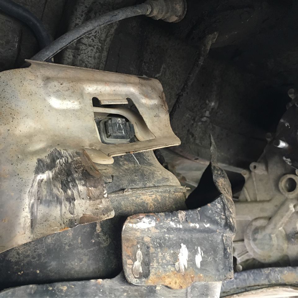

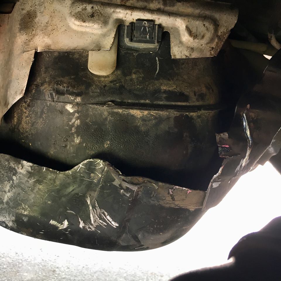

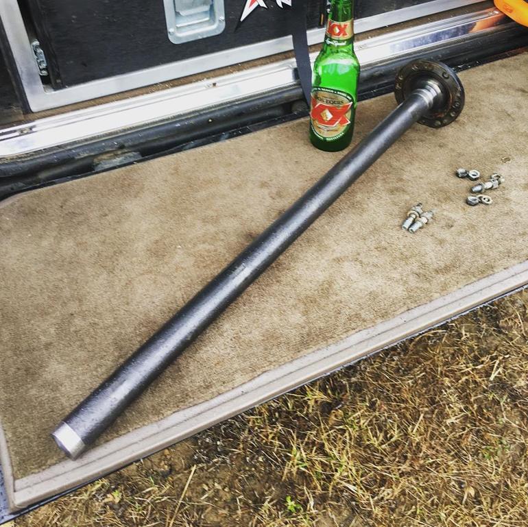

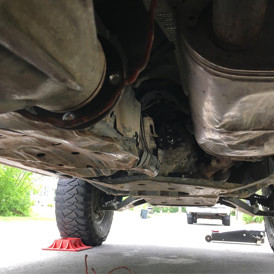

Drive Shaft Replacement 5/18/18
Changed out my rear driveshaft. Had 6 sizable dents throughout which caused vibrations. Also cut out a section of the tank skid for clearance for the drive shaft.

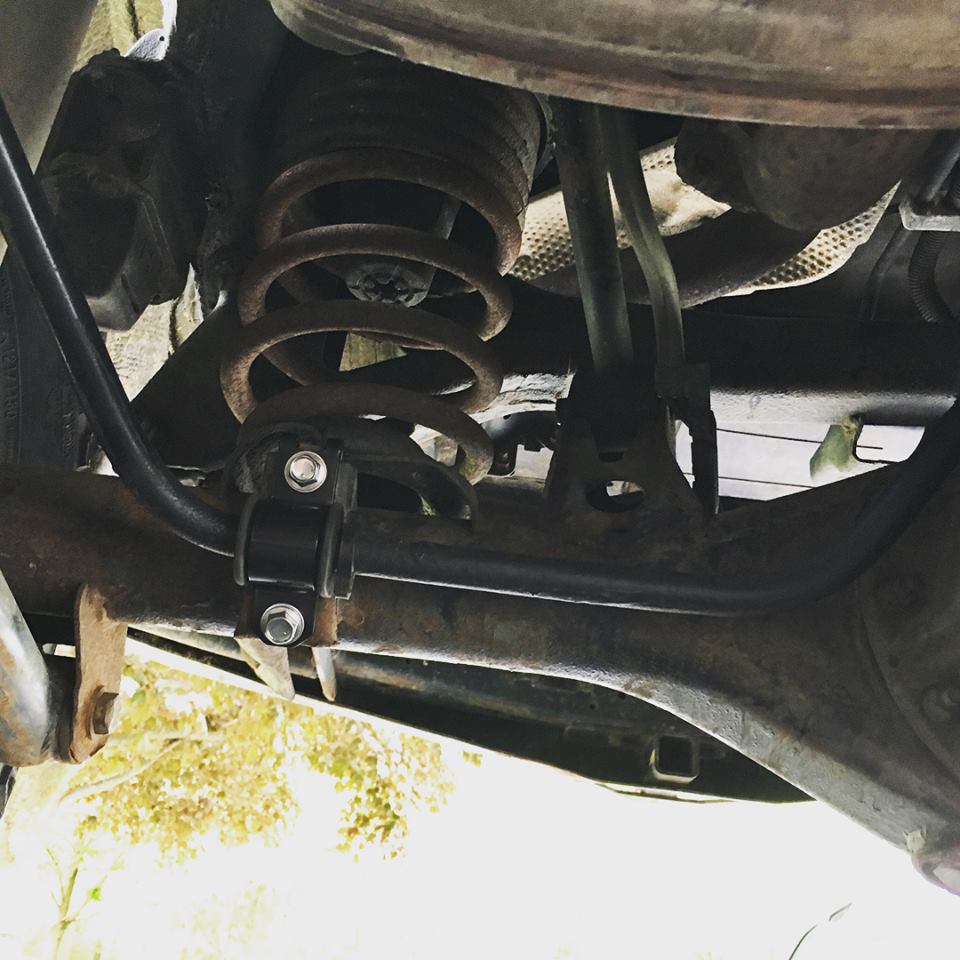

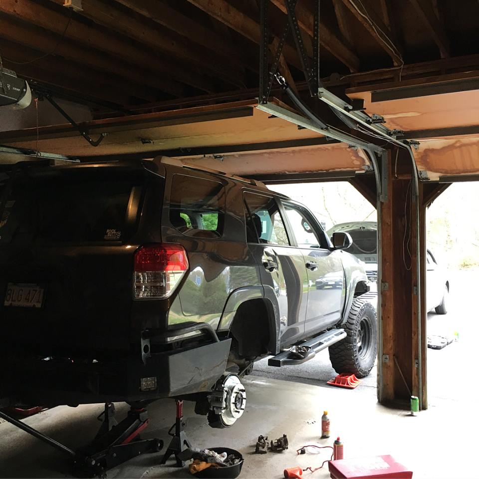

Reinstalled Rear Sway Bar 5/19/18
Threw on the rear sway bar again after over 6 years without it. Got so used to the loose ride that this makes a significant difference even if only the rear. Also notice that my muffler is separating at both ends so will be in need of a new one.

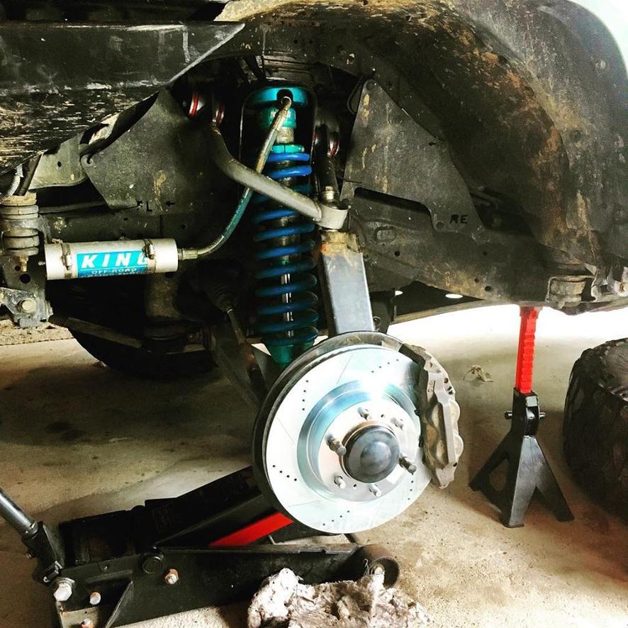

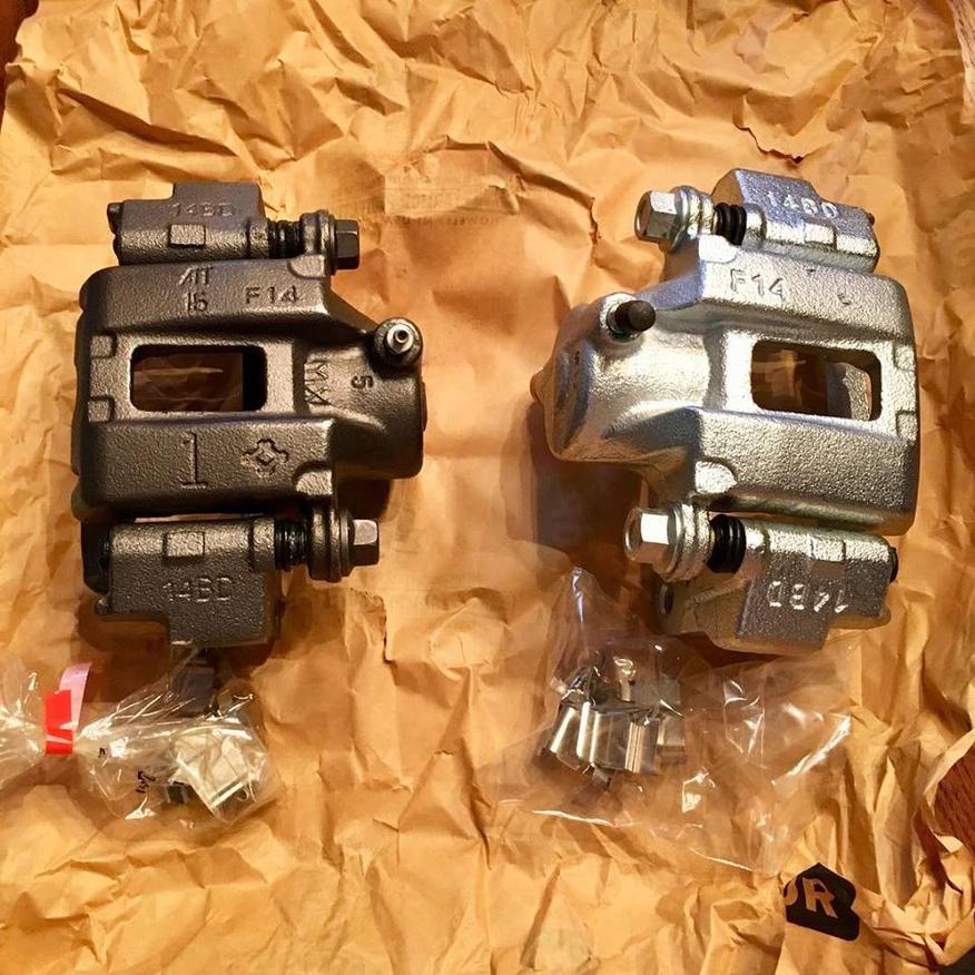

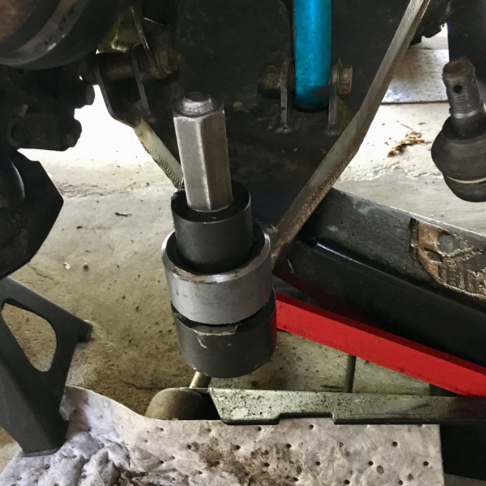

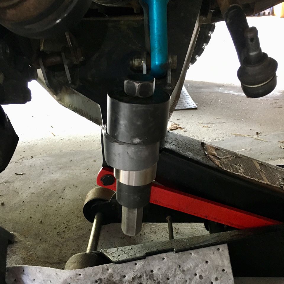

Uniball Replacement/Brake Kit 5/2018

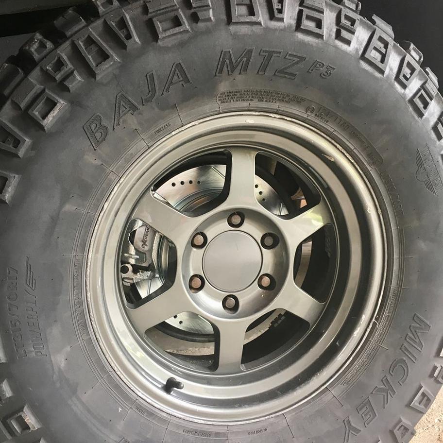

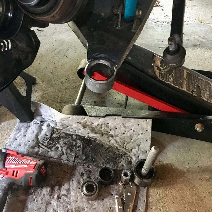

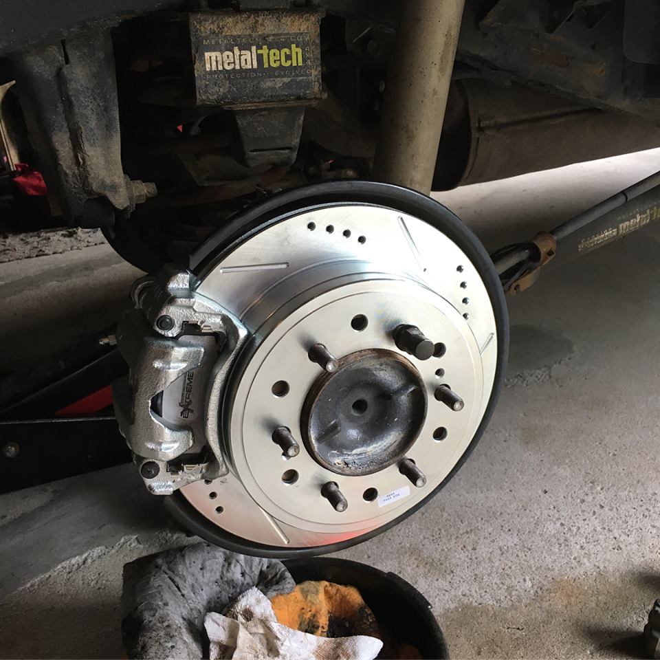

Finally finished installing the Power Stop Brake Kit. Needed two new calipers for the rear(been driving with only front brakes for quite a long time lol). The front driver could benefit from a new caliper also(will most likely just buy two new calipers for the front).

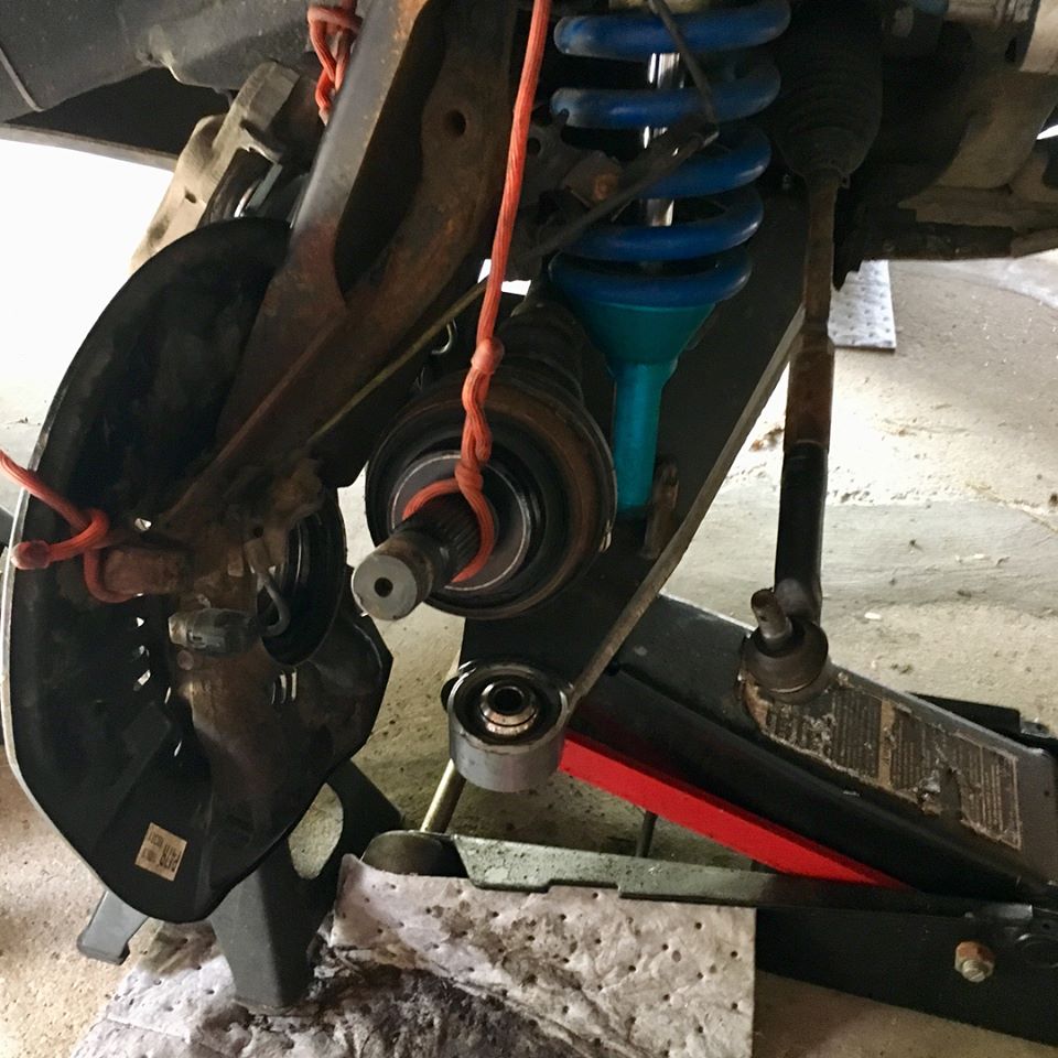

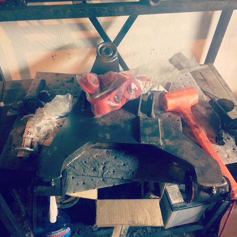

Needed to replace my uniball on the passenger side LCA and replaced the bushings at the same time.
