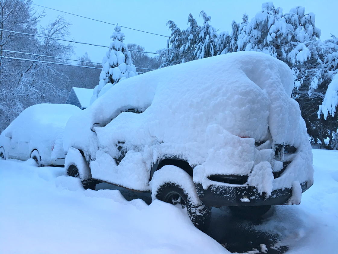

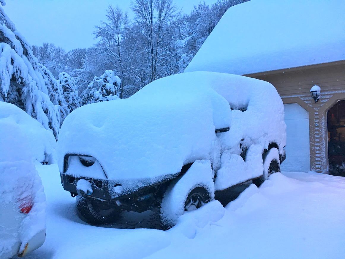

Snow Storm 3/13/2018
March definitely came in like a lion and buried my trucks with almost two feet of snow.

mmmmmmm 4Runner Snow Cone.
I was digging the pictures of your last outing and was very jealous of the terrain you have up there. Now? not so much.

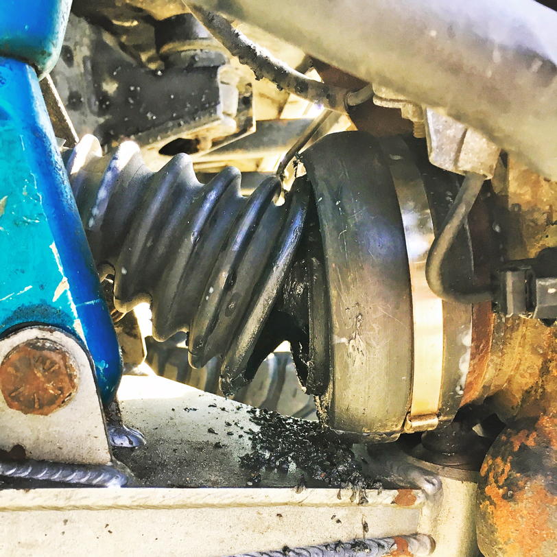

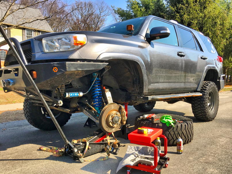

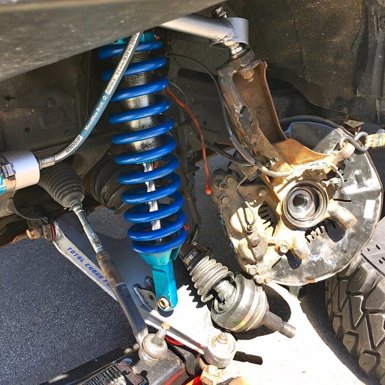

4/14/2018

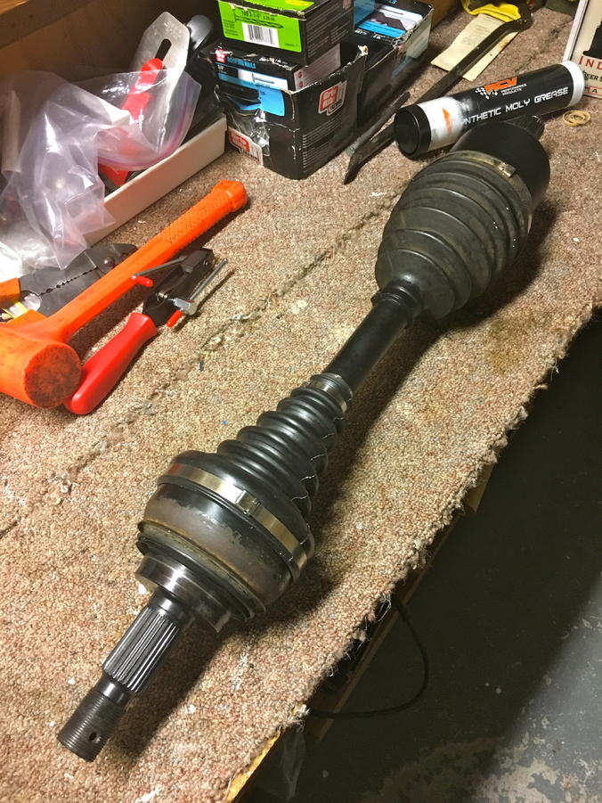

My RCV axle boot had torn. Looks like they had dry rotted. Lowered the front end a bit.

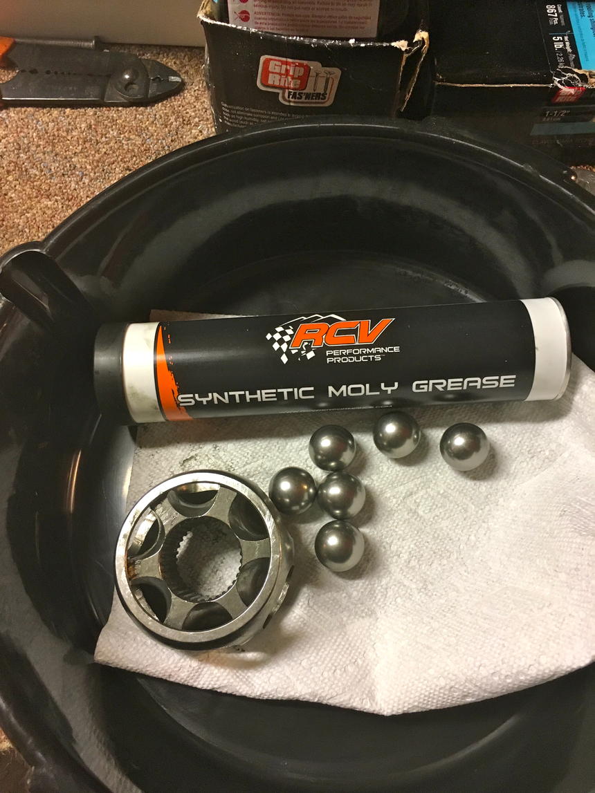

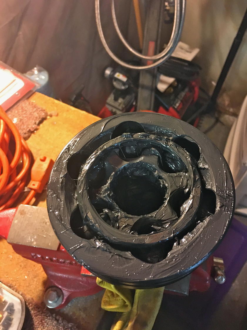

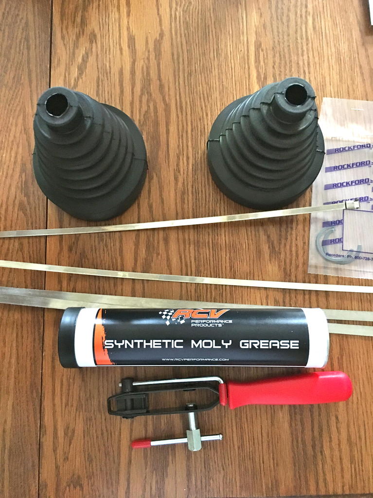

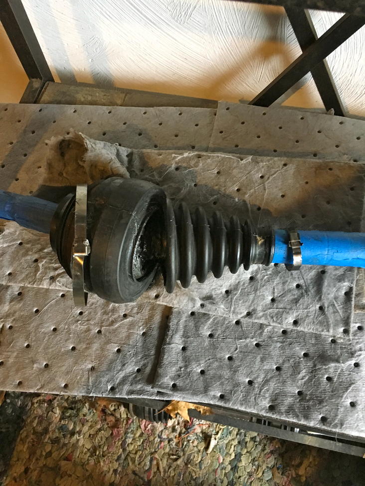

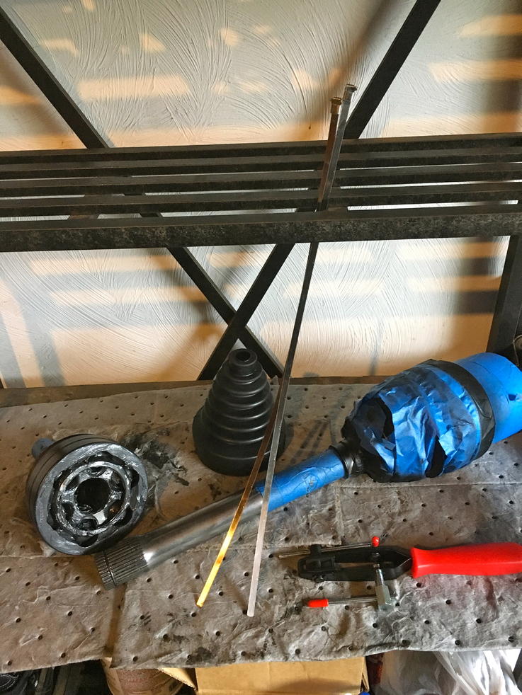

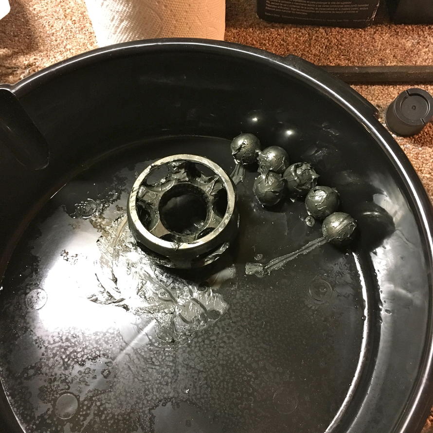

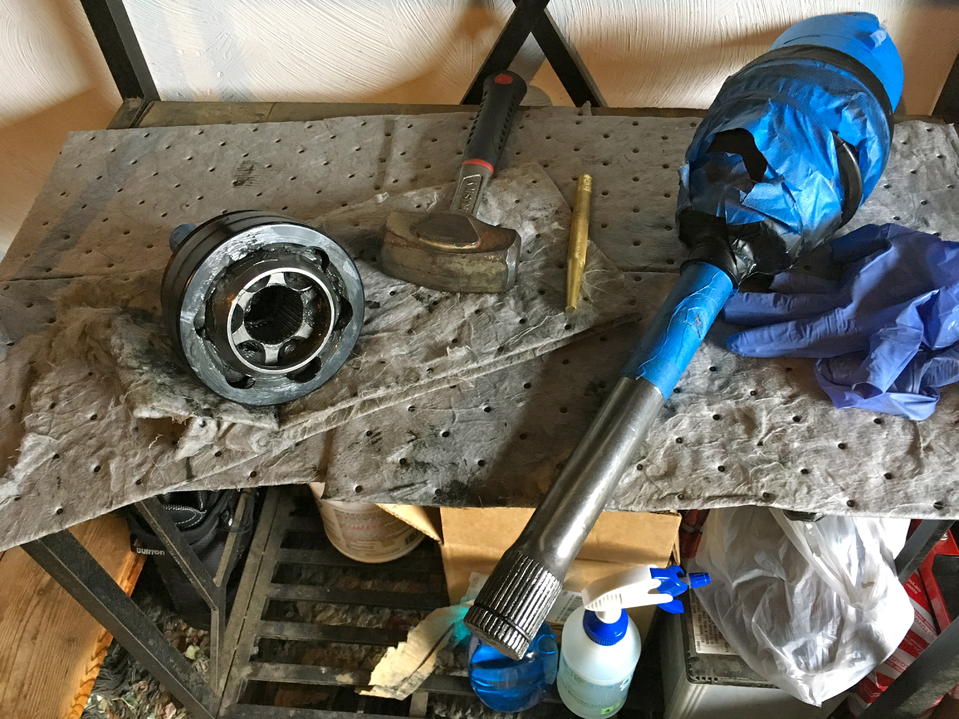

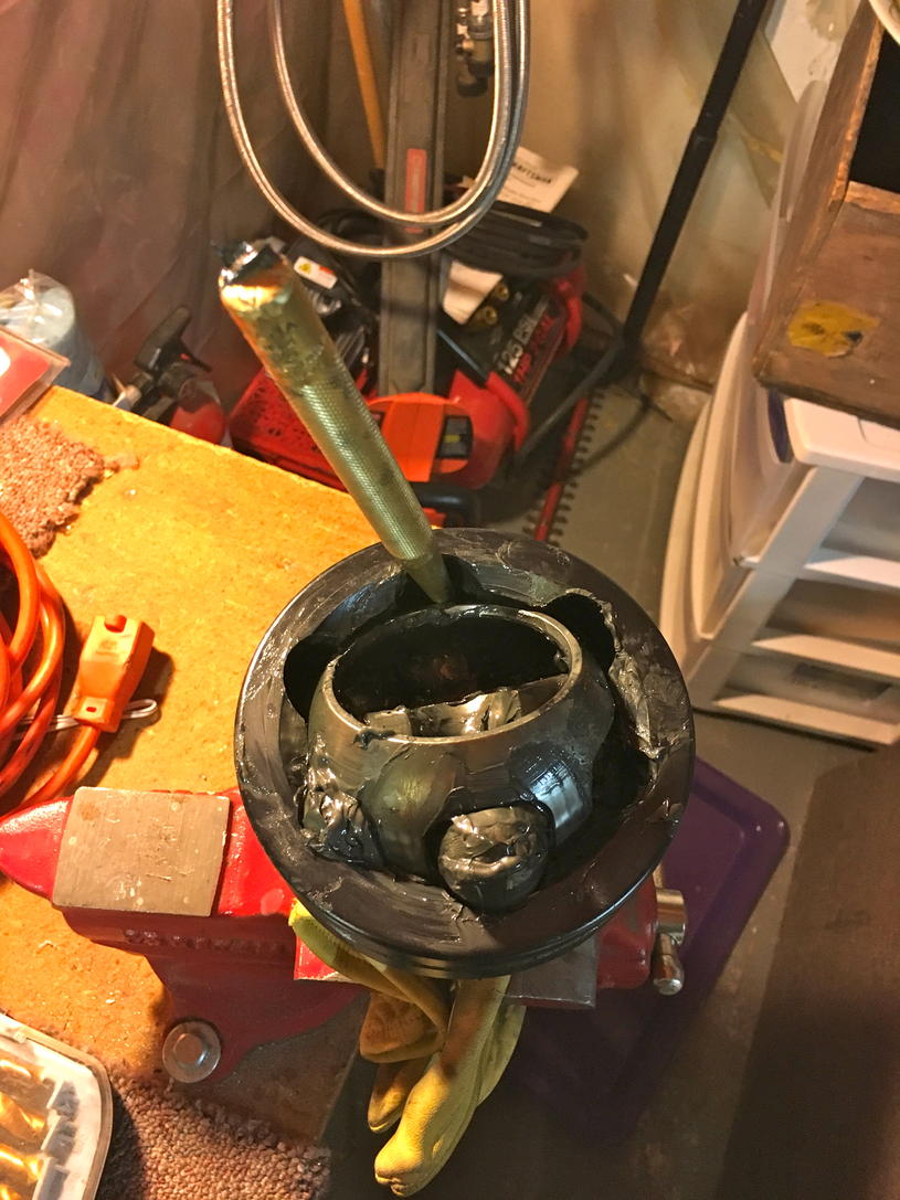

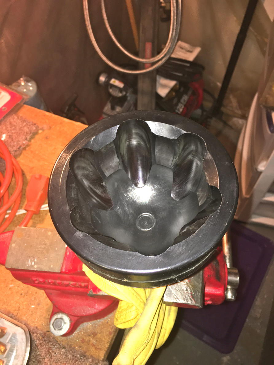

Rebooted RCV axle 4/25/18
RCV sent me everything to reboot my torn outer cvj. Bought the banding tool off of Amazon. Disassembled the the entire outer(race, cage, bearings and housing), cleaned out re-greased and reassembled and back in the truck. The boot was definitely a ***** to get over the shaft.

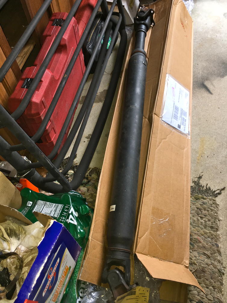

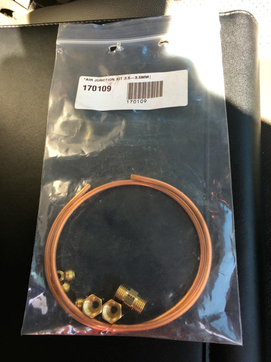

Spare Parts 4/25/18
Picked up a couple of spare parts. ARB air locker parts and a rear drive shaft.

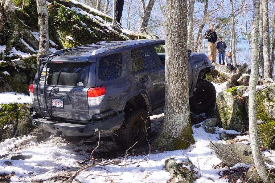

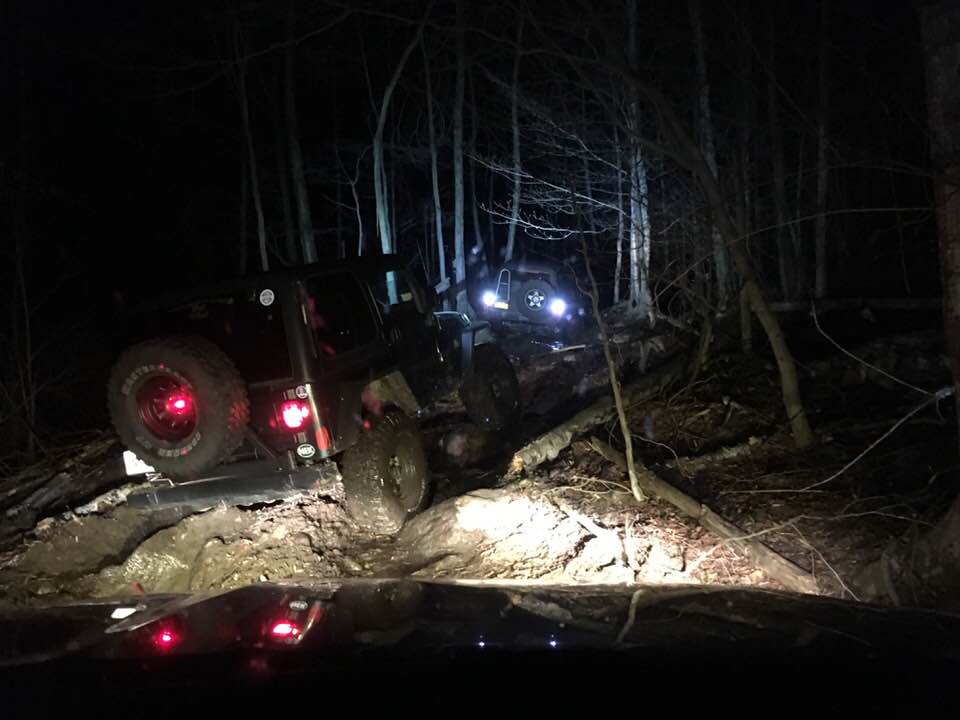

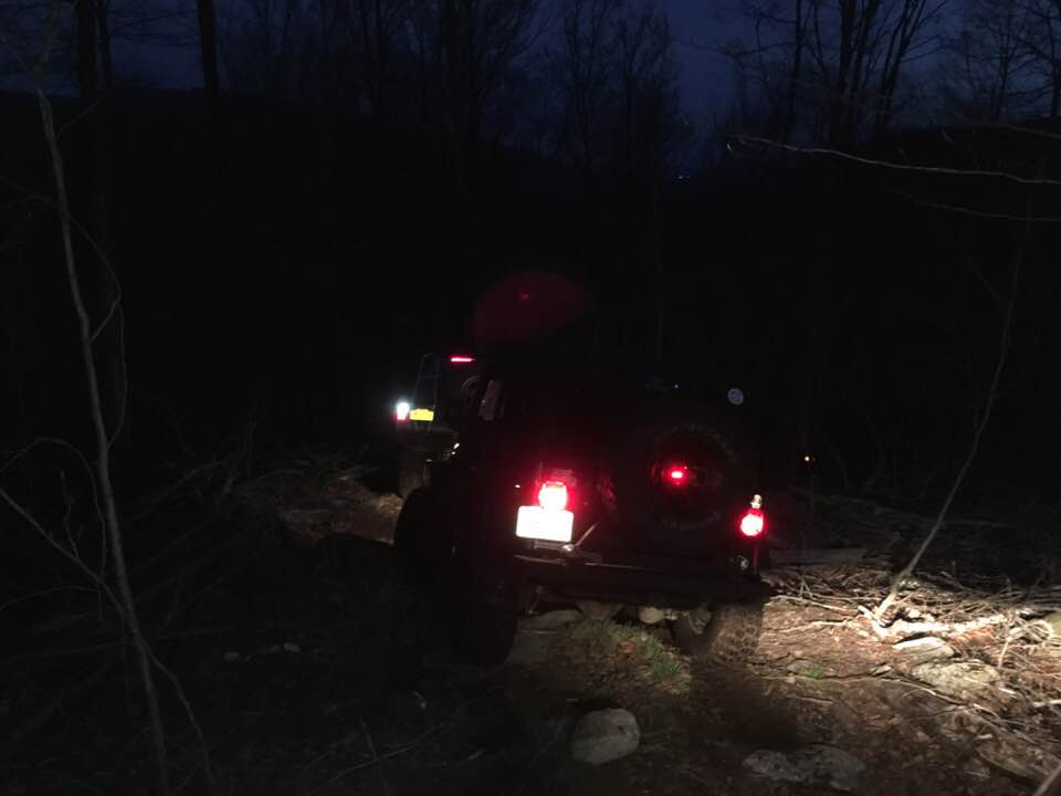

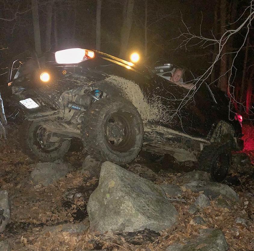

NEA Property 5/5/18

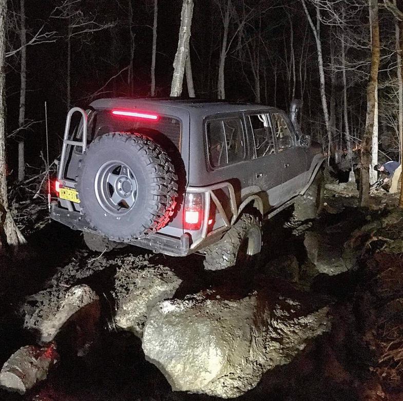

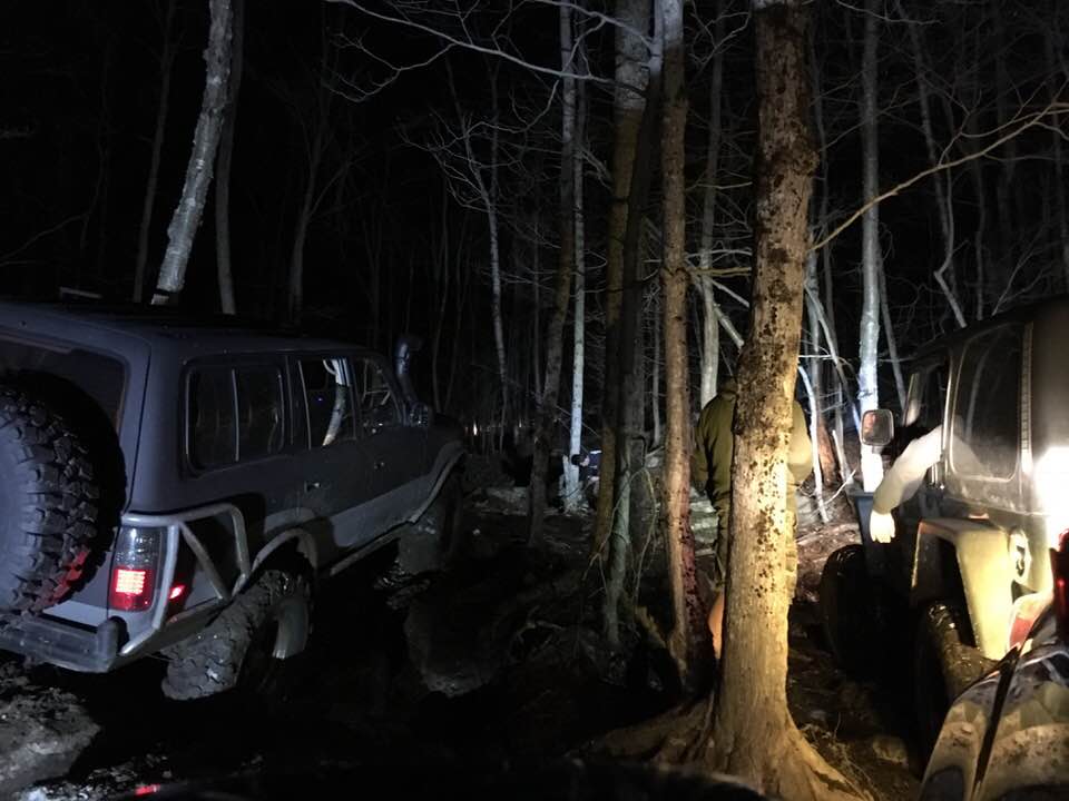

Hit up another NEA property in VT with a bunch of friends. Wet, muddy and slippery made everything challenging and we had to use the winches more than we had liked to. Place is no joke. Second day was cut a little short due to Jared shearing an axle shaft.
