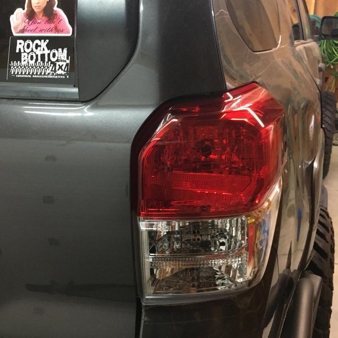

New rear tail light replacement and door flare back on.

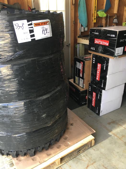

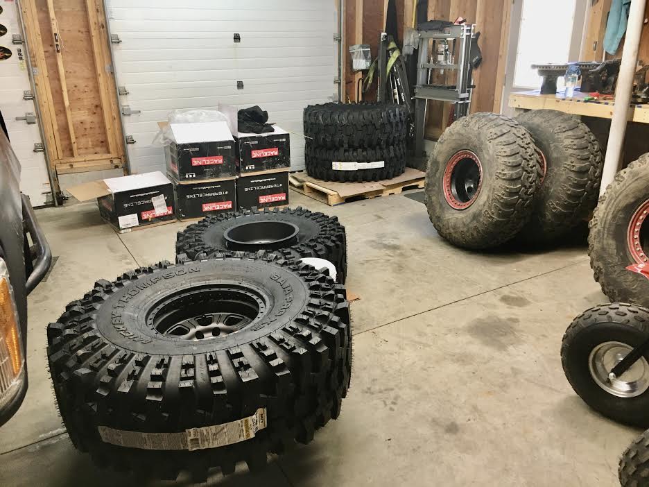

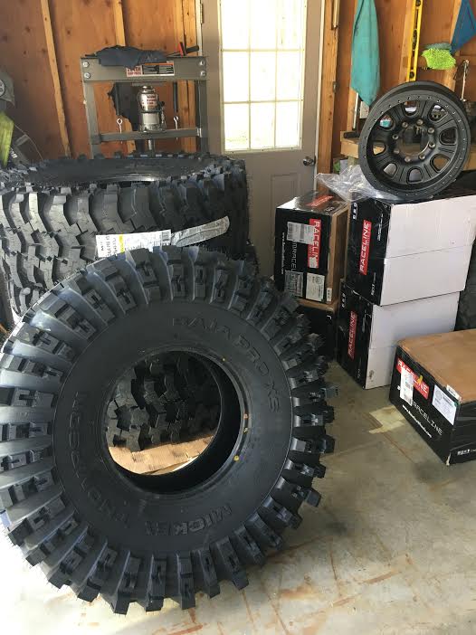

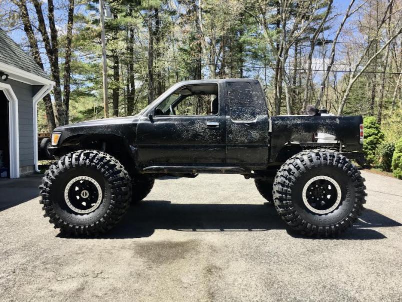

Crawler

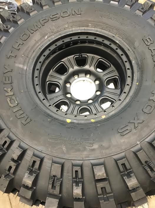

15/43/17 Mickey Thompson XS Tires
Raceline Wheels Monster 8x6.5 - 4" backspacing
All new hub studs 60/14

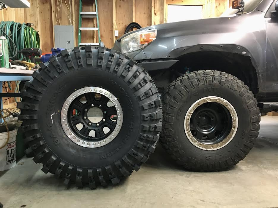

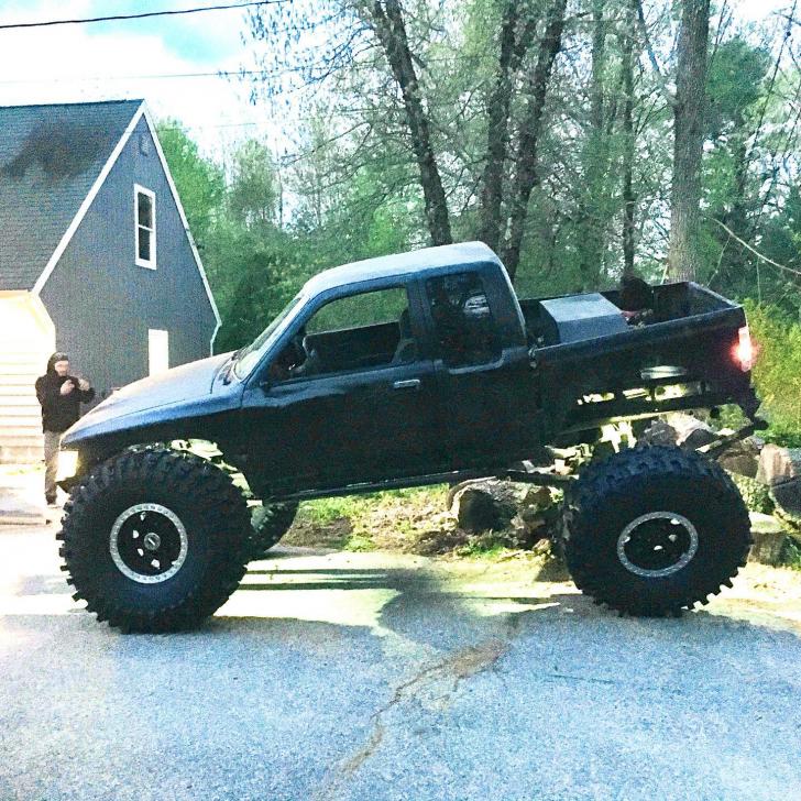

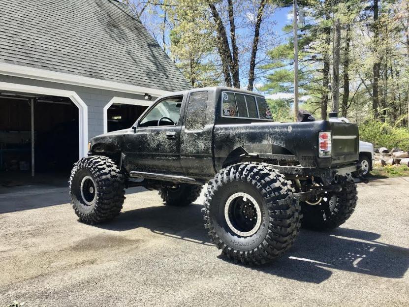

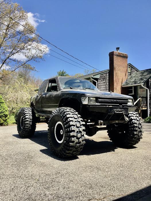

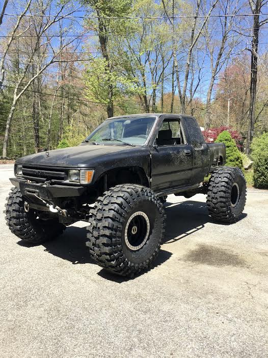

Crawler - 5/12/2021

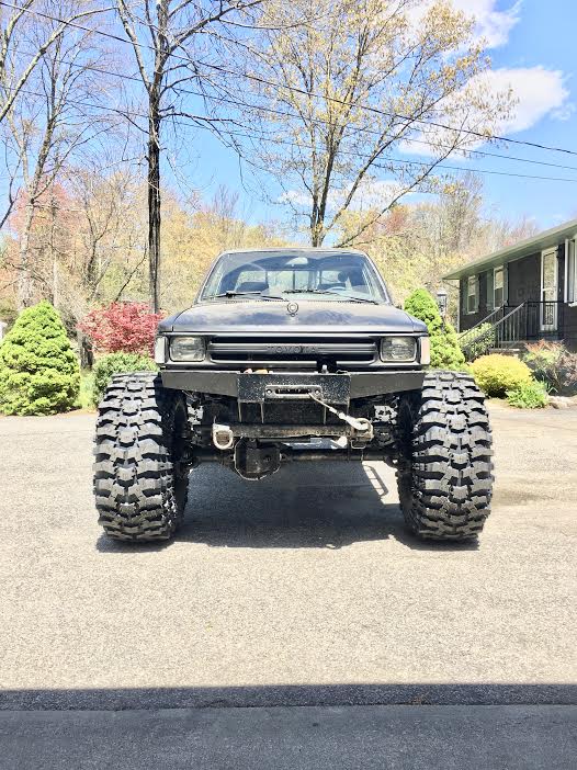

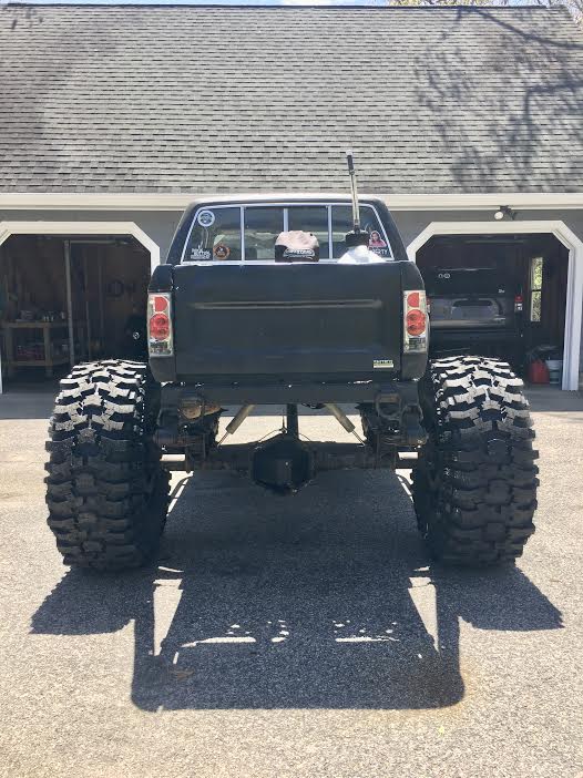

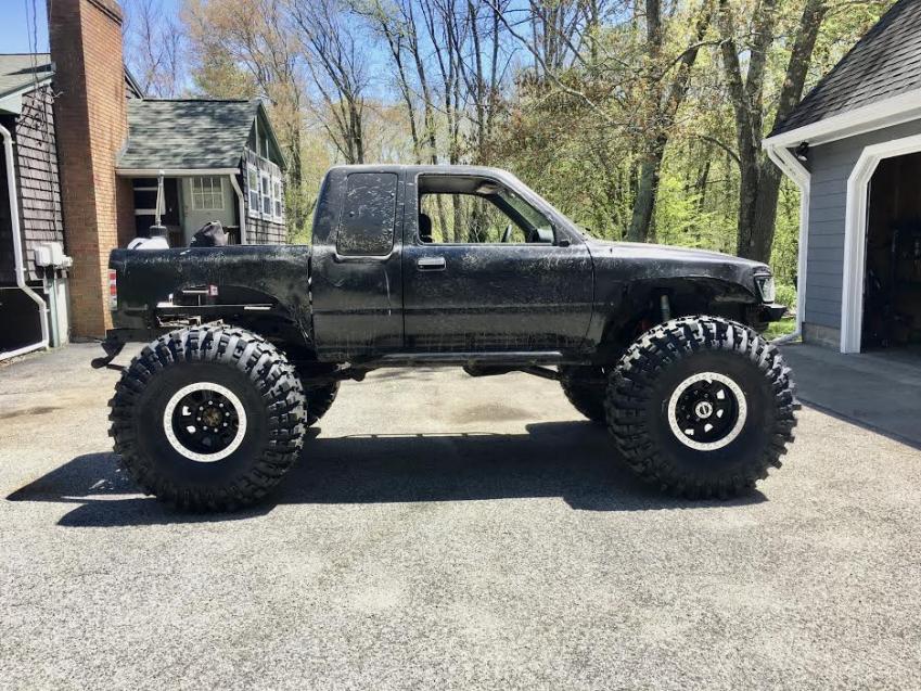

To this point I have recently rebuilt the front Dana 60, new front leaf spring bushings and sized up from 15" wheels and 39.5" Irok tires to 17" Raceline Wheels and Mickey Thompson Baja Pro XS 15/43/17 tires.
Finally got it all back together and moving again.
