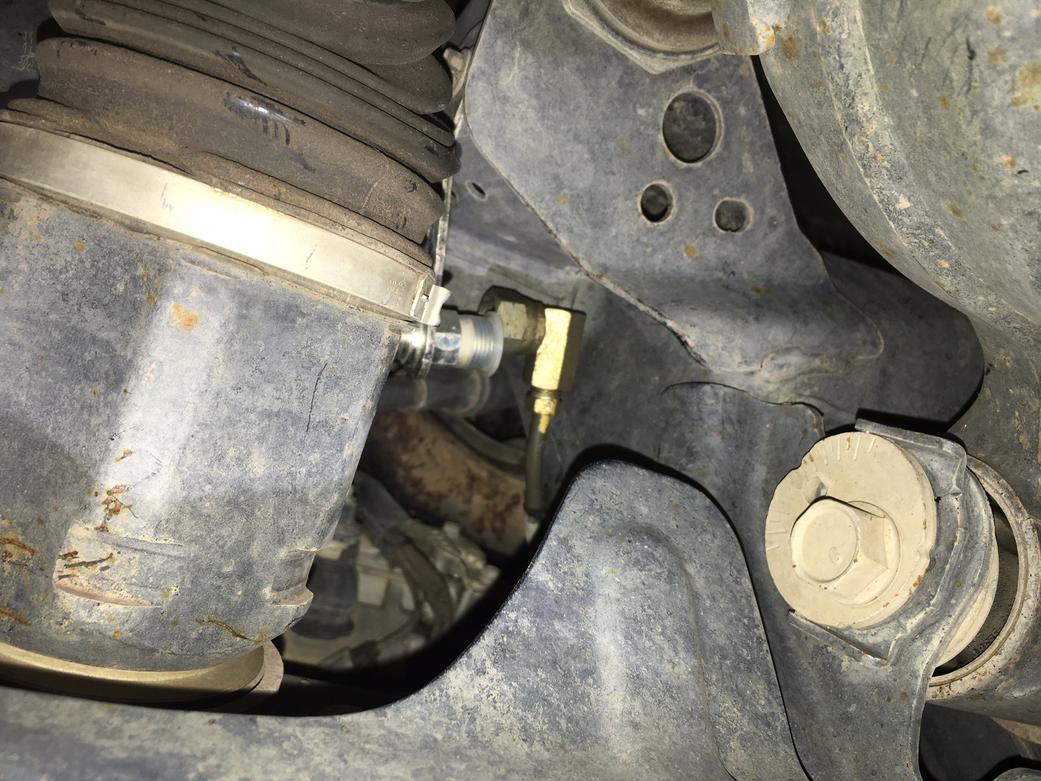

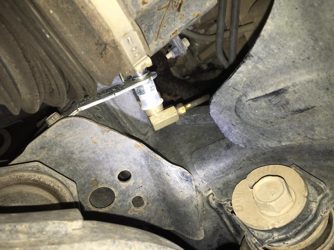

I took it to the dealer and they found out what the issue was. The hydraulic hoses were not hooked up to the front shocks (XREAS)!
Since I bought this 4runner as a certified pre-owned from an out of state dealer, my local dealer says I should send the out of state dealer the paperwork and ask for them to pick up the tab. Tax and everything for the complete XREAS suspension rebuild is around $3300.
The Toyota mechanic says you cannot simply hook these hoses back up and it just work. It requires a complete rebuild from a new XREAS system.
I let the out of state salesman know about it tonight and he said they should've seen this during their inspection before it got marked as certified pre-owned. He is going to get his manager to call me and my local dealer tomorrow. We'll see what happens. Hopefully I won't get shafted.
Pics...

If the xreas was disconnected at the correct union fittings and with all 4 wheels off the ground then they can be reconnected without issue, as the unions fittings are self sealing. If they were removed at the fittings closest to the shock then there would have been loss of fluid and yes, they would be practically toast. See the instructions in this PDF for more information. I just had mine disconnected according to the instructions in the PDF so I could sell the xreas unit or reattach when I sell the truck.
I agree with one of the earlier posts and if the system does need replacing, then have them replace the shocks with Bilstein 5100s or the 6112/5160 combo for a lot less (or suspension of your choice). With many of the reputable aftermarket suspensions you will see better performance and you now have the option to add a lift .
Also you can usually find people who just upgraded their stock LE suspension and are giving their xreas away for practically nothing. Myself included.
