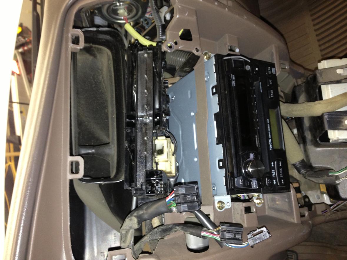

So I've been looking all over the Internet to find out how to replace the burnt out bulbs behind the climate control area on my '97 SR5. I've gotten the bezel out, but not sure where to take it from here. The picture shows where I'm at now.
Sorry the picture is sideways, my phone puts it in like that automatically.

You took a 5 min job and made it a 2 hour job lol
The clear thing there in your climate control comes out, pull of on the passenger side there is a single bulb behind it there ya go.
All you had to do was pull all the knobs and the face off to get to this point not the whole dash

Thanks for the reply, got it back together lol and the bulb out. Shoulda seen that one!
