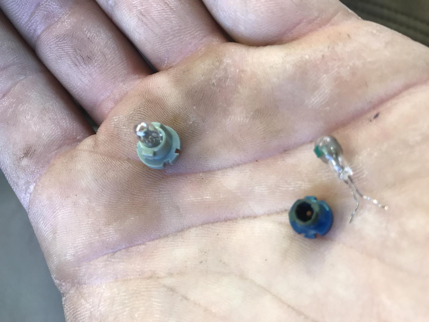

My 99 limited is WAY different then your setup. I had to take the dash apart, pull the climate control unit off, then seperate the two main pieces and ended up with 4 screw bases with a small halogen (looks like a single led with leads bent over the screw in base) have them in hand and can take pics of the back if need be. Now I'm having the fun part of trying to find a replacement around here. I thought I read somewhere that we need a 4mm LED but idk exact specs. image.jpg

Here you go this chart should help you.
