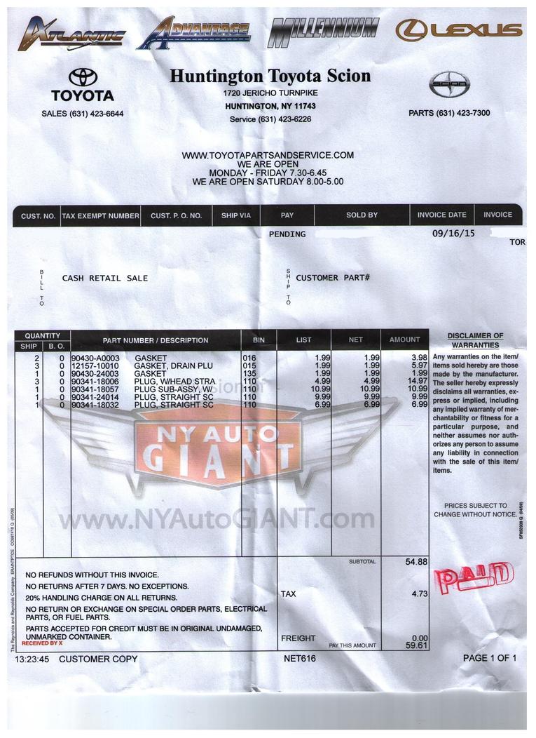

Literally just what I'm about to go do. Do you have a receipt from dealer you can send/scan/fax or post?
Sure here it is.

I have a 2004 V8 and called my dealer. Here's the part numbers he quoted me for the CRUSH WASHERS for this year/model.
Front Fill Plug, Rear Fill plug and Rear Drain plug all use the same washer:
Part - 12157-10010 @ $1.45 each, x3.
Front Drain Plug:
Part - 90430-24003 @ $1.99 each, x1.
Transfer Case Fill plug and Drain plug:
Part - 90430-A0003 @ $1.81 each, x2.
So for the six washers involved, three styles, comes to just under $10 before tax.
This is what I purchased too for all my gaskets.
Are you sure you got all the parts and correct number of gaskets?
I ordered verbatim what you had on your recpeit and it seems not all the gaskets are there. I guess just reuse the "breather plugs", whatever they do lol.
The only things i didn't order from the first post were the breather plugs and engine oil pan gasket and plug. I didn't see the need to purchase breather plugs since they don't need to be removed to replace the diff oil. Plus don't know exactly where they are located.
