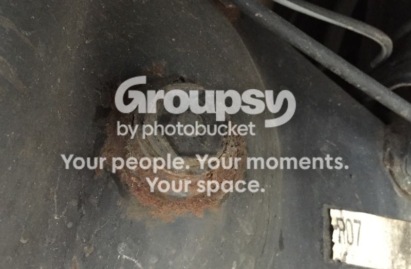

Edited to add: I found this rust around the fill plug on the rear diff. Would appreciate opinions on whether it's anything to be concerned about.
IMG_3226_zpsjngjcekh.jpg~original
From this pic that rust doesn't look that bad. You can take a wire wheel to it and then repaint it to prevent any further rust.

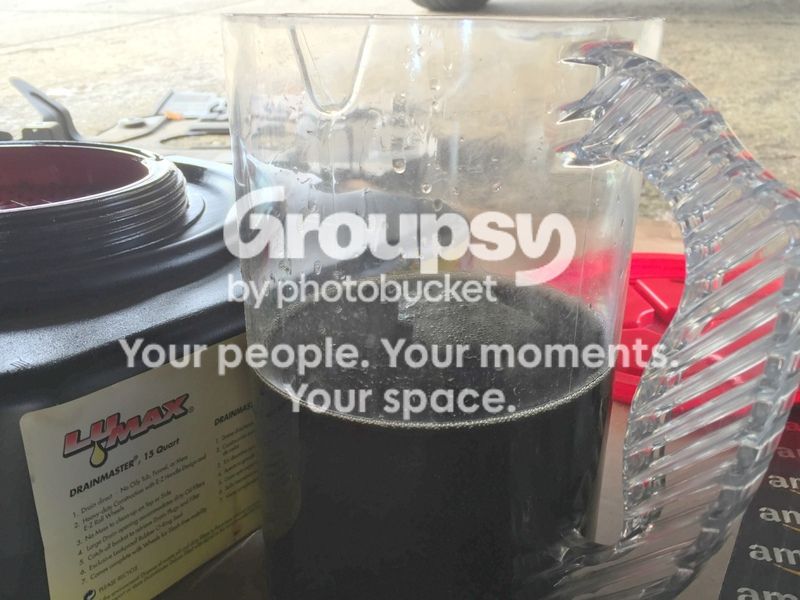

Which brings me to something I did in response to the posts about the gear oil spurting out. We had an old pitcher around the house so I held it up to the drain hole to catch the gear oil from the front diff and transfer case. Worked well - no spillage. It also allows you to get a good look at the oil and to measure how much comes out if the pitcher has markings. Finally, it's a great storage place for your bottle pump. A similar pitcher is about $3 at Walmart. (My waste oil container has one of those plastic grids across the opening so it catches the plug when the oil is poured out of the pitcher.)
IMG_3463_zpsfc7uxmml.jpg~original
As I suspected, the front and rear diffs appeared to be the factory fill. The pic, which looks like a pitcher of cola, shows the front diff oil. Not so good I suppose at 112K; wish I had thought to do this when I bought the truck at 96K. But there wasn't an alarming amount of metal sludge on the drain plugs, and since changing the past isn't one of my strengths, I'll let that go and just keep the oil fresh from here on out. :D
The transfer case oil was kind of honey colored, almost exactly like motor oil looks right out of the bottle. The dealer I where I bought the truck used had to replace the 4WD actuator so I assume they had to open the transfer case to do it.
All in all, the info in this thread made this an easy job. I hit the plugs with WD-40 that had a couple of weeks to penetrate and each broke easily. Bought this torque wrench from Amazon to be sure I got the plugs tightened correctly.
