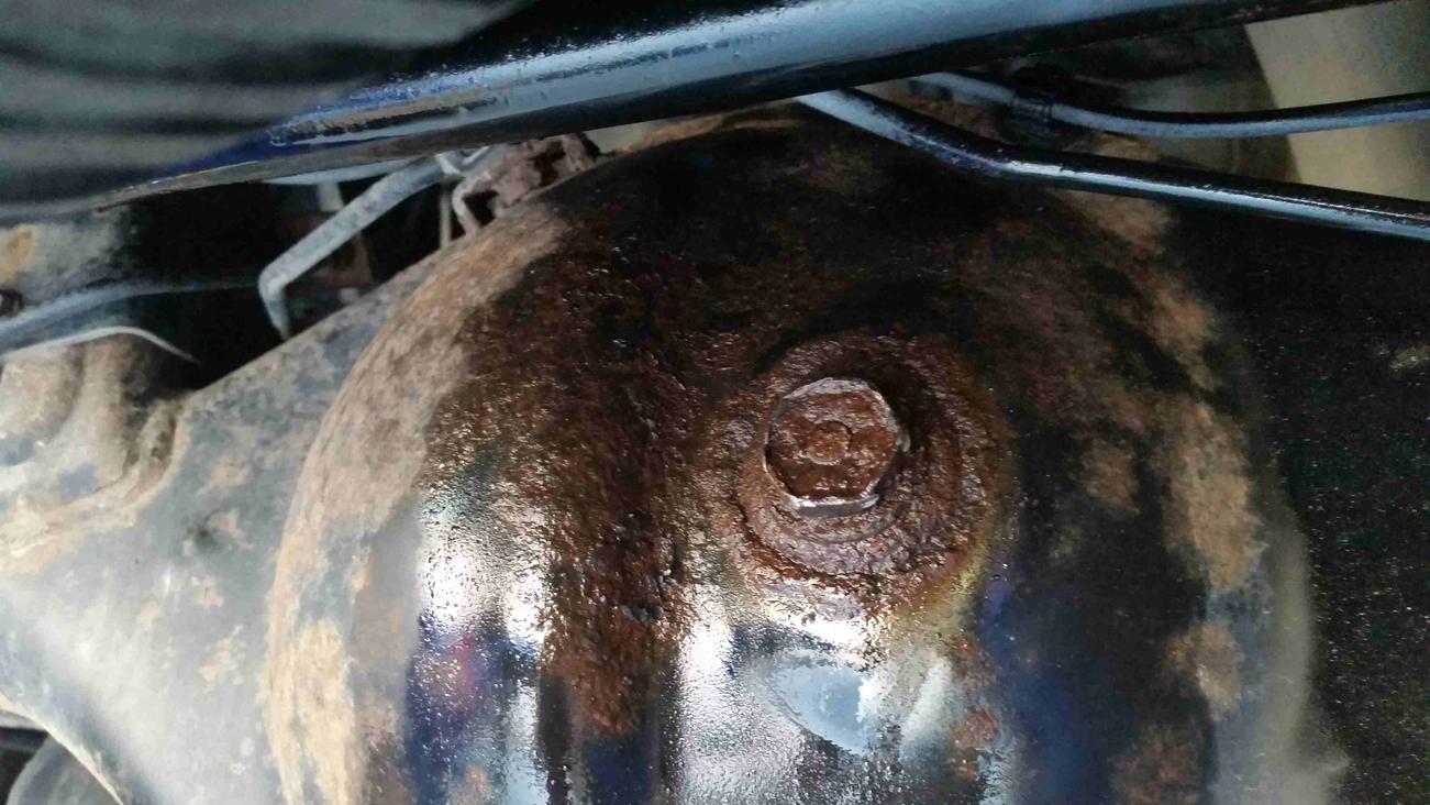

The dealership quoted me $408 to replace fluids on the front and rear diff and transfer case. I spent approximately $100 in crush gaskets, mobile 1 fluid, and renting a bay to get her up on a lift. My biggest issues was breaking off two bolts on the front skid plate (turned out they were completely seized and had to get drilled out). Other than that everything went pretty smooth. I sprayed PB Blaster on the bolts I could get to the evening before and again in the bay. Was worried about all of the rust (see pic) stripping my bolt and after gently trying with the 24mm, followed the advice on this forum and used the 15/16 which worked like a charm! I will replace the bolt next time I change the fluids. Appreciate the great write up!

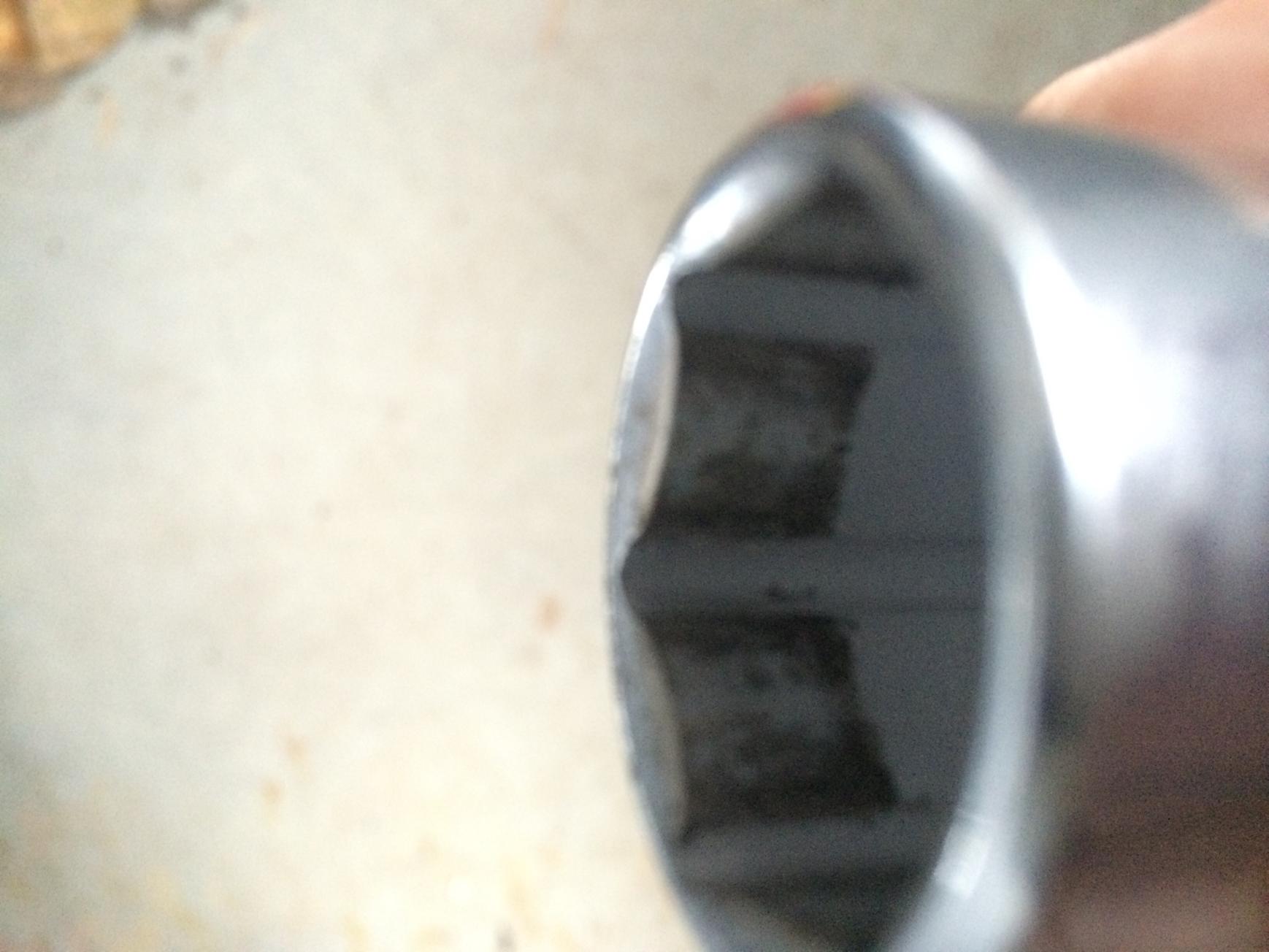

99 % of the time people strip the fill and drain plugs is because they don't have the socket on square .
if you look at the end of a socket they are beveled for a few mm and the plugs are so short there is not much grabbing on maybe 2-3 mm total especially if they are corroded and have been worked on a lot and are a bit worn , also the best way of freeing them is to hold socket on firmly and square with one hand and slap the ratchet with other hand not just put it on and pull on rachet because it will angle itself off and round off bolt head on it especially if using a socket what has a beveled end .
I took a 15/16 6pt and ground it down until it was into the actual socket area . and use this for plugs , as for the front drain I use antisizee on the threads and torque to 45 never have problems getting it out . Make sure you tap the (correct size) Allen head socket in with hammer all the way first before trying to remove the front drain.
Pic of the beveled edge i speak of , grind a 6 pt socket nice and square until that bevel disappears , much less chance of rounding plug head
