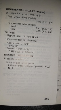

Keeping in mind that mine is a 2004 Sport V8 4wd that I use as a daily driver, for the front and rear axles I use 75w90, Redline has both options, for limited slip with friction modifiers and one without additional friction modifiers - I believe you want to use the standard - Amazon sells by the quart and gallon, Redline 75W-90NS is the standard without additional friction modifiers. It is a bit pricey, but it is quality lube.
If you are towing frequently, may want to stick with the 80w-90 (Hypoid gear oil API GL-5) or whatever is recommended in the manual for hotter temp. zones, SAE 90 I believe. *See Manual*
price is no matter, this car is my moms and is a daily and she also doesnt tow
