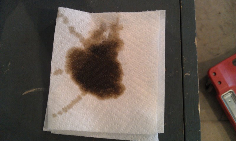

Did my front & rear diffs as well as transfer case this weekend. When I bought the 4runner last summer the dealer said they "changed all fluids". Interesting enough the transfer case fluid looked basically new as well as the rear diff. However the front diff came out black as ever. I'm assuming the front had never been changed.
With 127k now I should be good for a long time as I filled diffs and transfer case with Royal Purple 75W90. First drive out I definitely noticed a smoother ride and the cabin noise was quieter especially in the front.
Definitely agree that all crush washers should be replaced. Would hate to have to change one later on and lose $25 worth of fluid in the process. Cheap insurance indeed!
Below is a shot of the fluid from the front diff.
