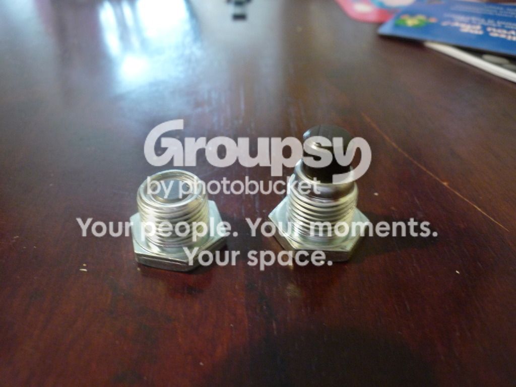

Just did the rear in my 2011 with 9000 km on it , magnet was full and fluid dark with a metallic sheen to it ,put in amsoil 75 w 90 and a magnet plug in the fill hole . Never thought it would be so bad looking this early with no towing on it . Get the rear changed right away if you plan on keeping your rig for 15 years or so like me , get the break in metal out of there .Also added extened the breather hose and put a fuel filter on it . Big hiss of air came out when I pulled the fill plug at the start of the job . It will hold pressure in there no more from now on.
Well I went magnet effen crazy today , changed out my rear fill where I had a flush magnet plug with an extended magnet plug and changed my TC and put two flush magnet plugs in it. The extended magnet plug gets the magnet out into the oil flow and will hopefully grab more metal and keep the drain plug magnet from reaching its metal holding saturation point for a longer period of time . I am going to start extending my drain intervals because I'm using synthetic and don`t want the drain magnet to fill up to much where its not doing its job anymore. I pull the fill plugs every oli change and clean them off.
Next will be the front diff , does it have a magnet in the drain plug

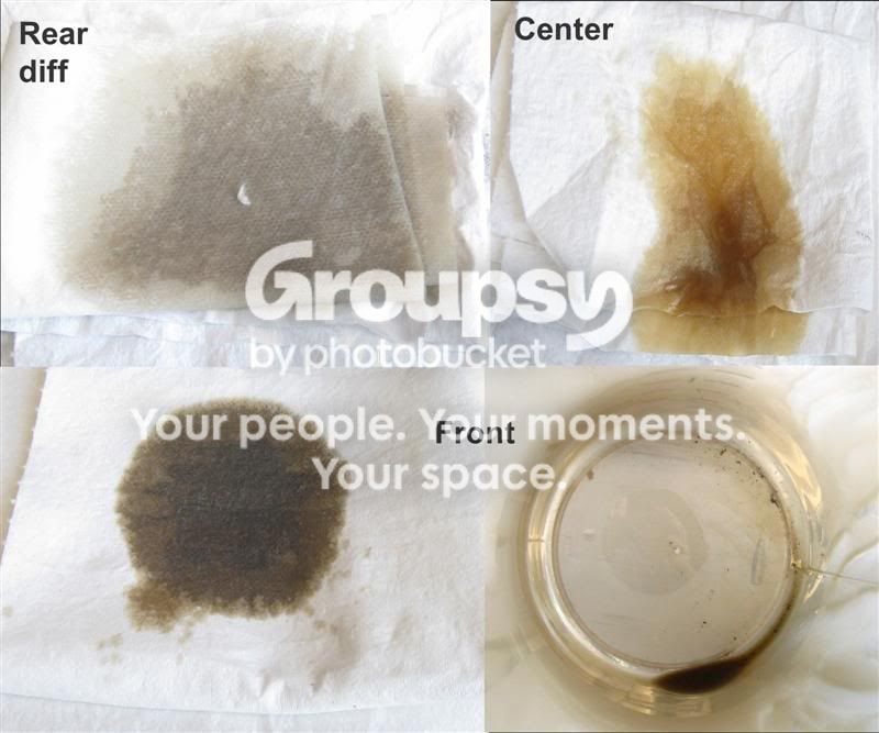

Just did this again after 36k miles for all 3 diffs on my full-time 4WD. Used Valvoline 75w-90 full synthetic because it was $2 a bottle less than M1.
Looks like the front is going to need this more often. The fluid was the darkest and had noticeable metal specs beyond what was caught by the magnet. Even though the front gets only 40% of the torque, it has to live on 1/2 the fluid of the rear diff. Throw in frequent use with center diff locked and I guess this should come as no surprise. No doubt this is mostly a concern for the full-time 4WD trucks. The situation is probably somewhat reversed for the muli-mode.
I plan on keeping the truck a long time. I think I'll go to 25k changes front and rear and hit the center every other time. Maybe I'll look into an extended magnet drain plug for the front.
