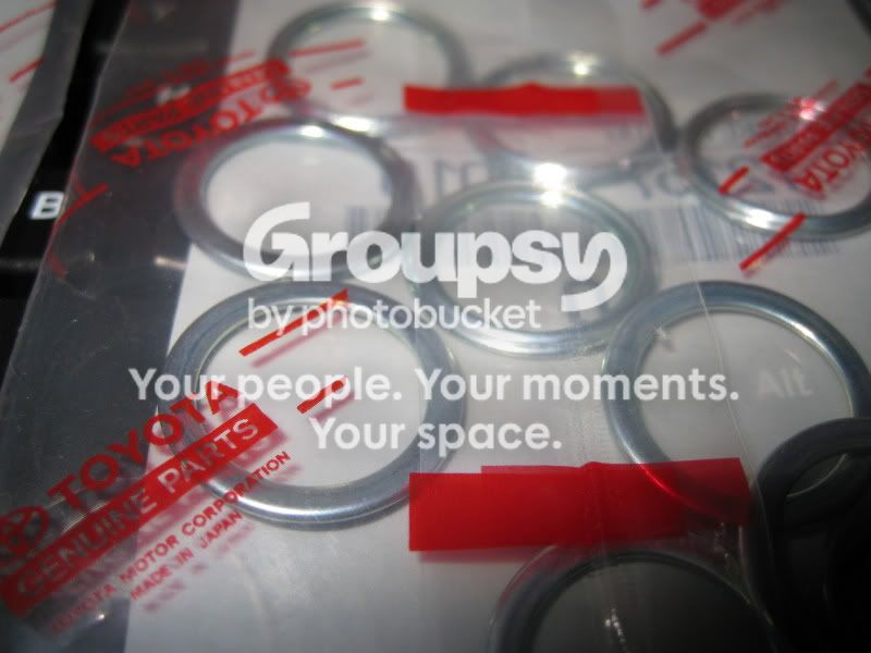

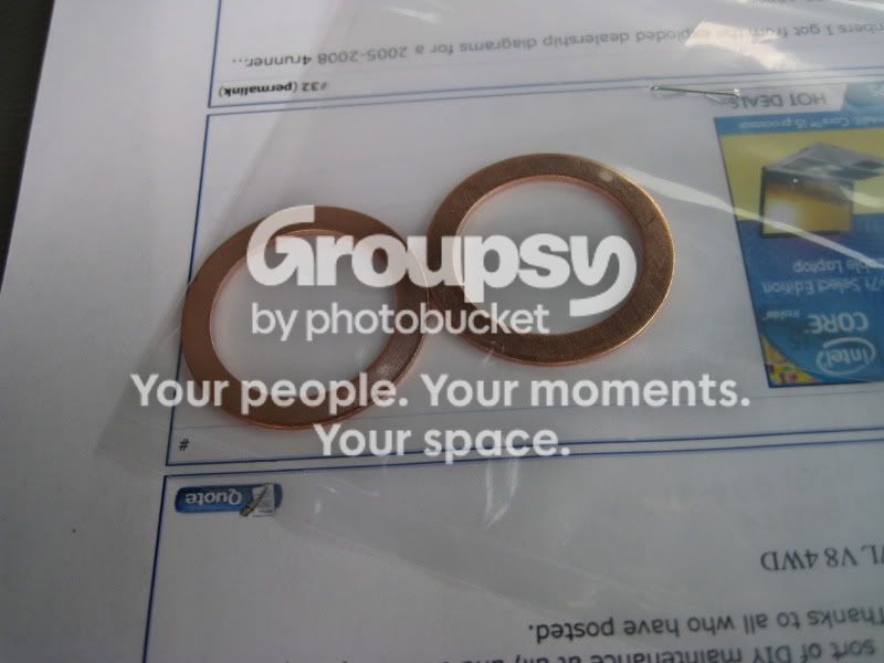

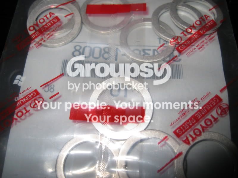

Maybe I missed it in this writeup but I couldn't find where each specific washer was actually used? It would be sweet if snowbizx could list the part numbers /washer description after each photo on his first post. That would be super helpful.
I finished the job anyway using the Toyota OEM washers and ended up with one washer at the end that didn't fit the rear diff fill port/nut. I had to reuse the old crush washer on the fill nut.
Note to the guy above asking about the torque wrench. I got one for around $50 specifically for this job. It was interesting to "feel" how little the torque was on some of the nuts when using the wrench. You would be surprised and if you are like me - probably over twisting by hand! It is one of those things that when you use it, and it "clicks" at the correct setting, you know you did the job right.
Edit: my bad here they are - just make sure when the parts guy collects them from the back parts bins at Toyota that they separate and identify them by part number.
Front Diff Drain
9043024003 (x2)
Rear Diff Drain
1215710010 (x2)
Transfercase Drain
9043018008 (x2)
Oil pan drain
9043012031 (x1)
