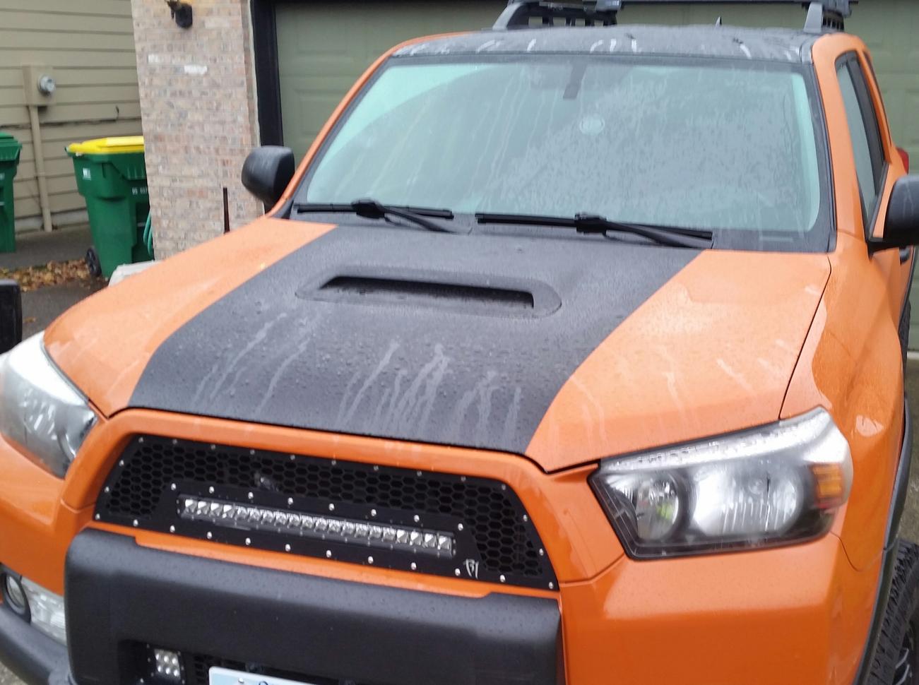

New look
plasti-dipped the hood yesterday. Second attempt. The edging was the issue the first time I let it dry before I pull the tape. Oops. This is also to try to alleviate the glare I get off the hood at different angles of the Sun.
If that doesn't work out, vinyl works well.
looked at vinyl but wanted to try this... and alot cheaper. Now that I've done it, its easy and can be retouched easily. Youtube had alot of good vids about application:peace:

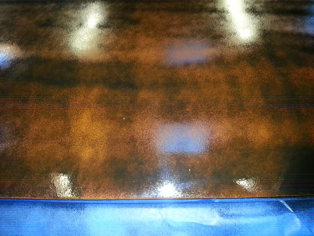

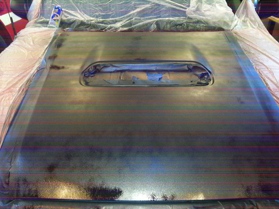

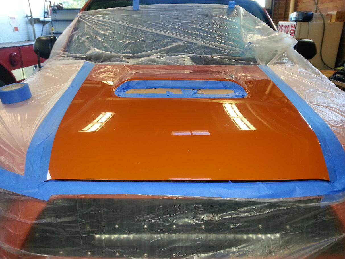

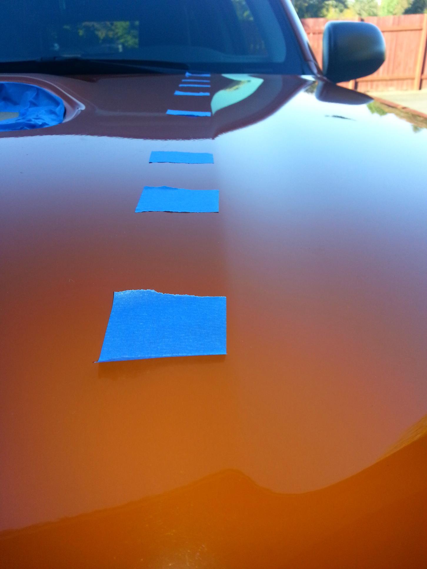

Had a request to do a write up about this so here goes:
I did the dipping to cut the glare off the hood I have experienced. I considered vinyl wrap but came across some youtube vids by dipyourcar.com and decided to give it a try.
-Couldn't figure out how to caption the pictures so here goes
-Cleaned the surface
-I used the tape pieces to get the edge curve then taped the edge
-Used plastic to cover the truck

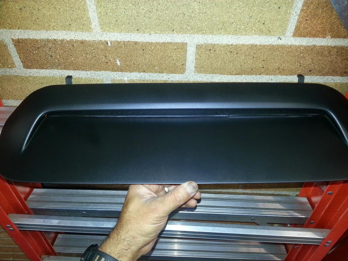

-removed the scoop and painted it first
-followed www.dipyourcar.com video instructional to lay down 5-6 LIGHT coats on the center part of the hood first (its easy to go too thick and get drip or rough surface texture, patience)

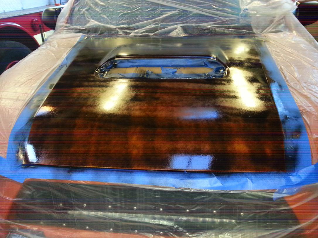

-letting each coat dry before applying the next, avoiding the edges for now (pic #6 was my first attempt, went to the edges, it dried and the edges pulled up: don't do that!)
-Then I focused on the edges (theres a vid about edging) 5-6 coats but don't let them dry in between. Careful no to go too thick here. Practice first. Once you have good coverage then peel the tape off a sharp angle to get a good edge.
-The only problem I had was that the edges (about 3-4" from the edge) look smoother and wetter than the center which has a flat/duller look. That's due to application technique (or lack of)
The end result worked, I think it looks good for now and when I (or the wife) get tired of it it peels off easily (I know this from the 2 previous attempts ;) )

So, you got a clean edge using painter's tape? I didn't think P-D did that - like it didn't separate well from the tape edge, or some-such.
Looks great!
Looks great!
If you pull it while it's still wet you can a get chance of it coming out alright
"Then I focused on the edges (theres a vid about edging) 5-6 coats but don't let them dry in between. Careful no to go too thick here. Practice first. Once you have good coverage then peel the tape off a sharp angle to get a good edge.
The end result worked, I think it looks good for now and when I (or the wife) get tired of it it peels off easily (I know this from the 2 previous attempts ;)"

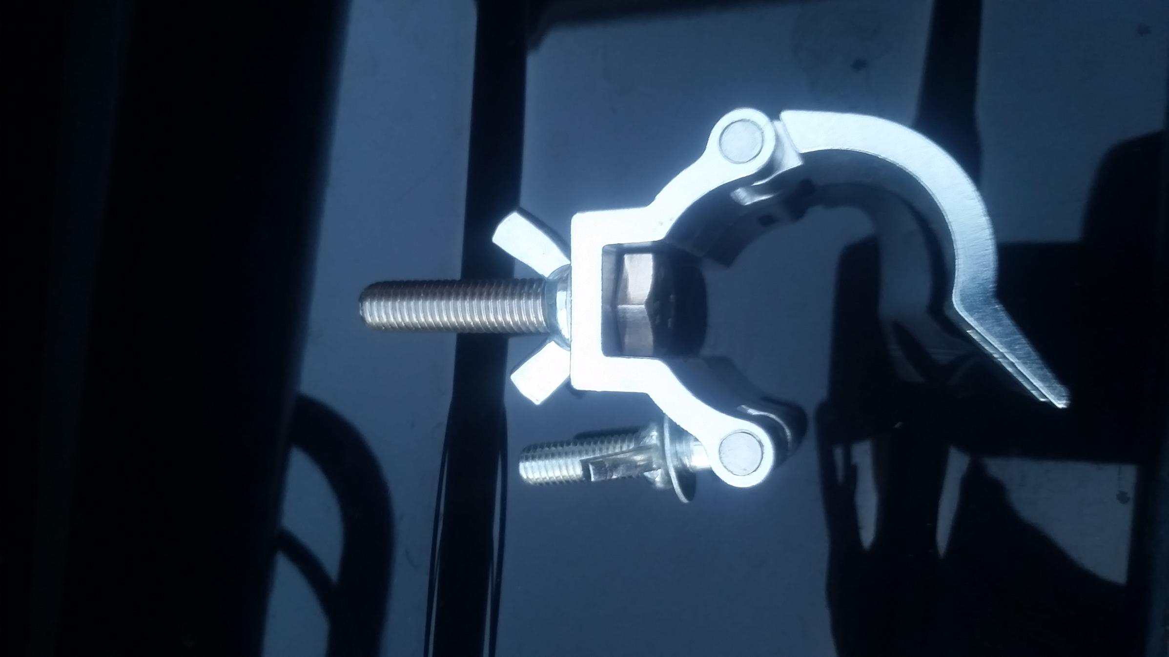

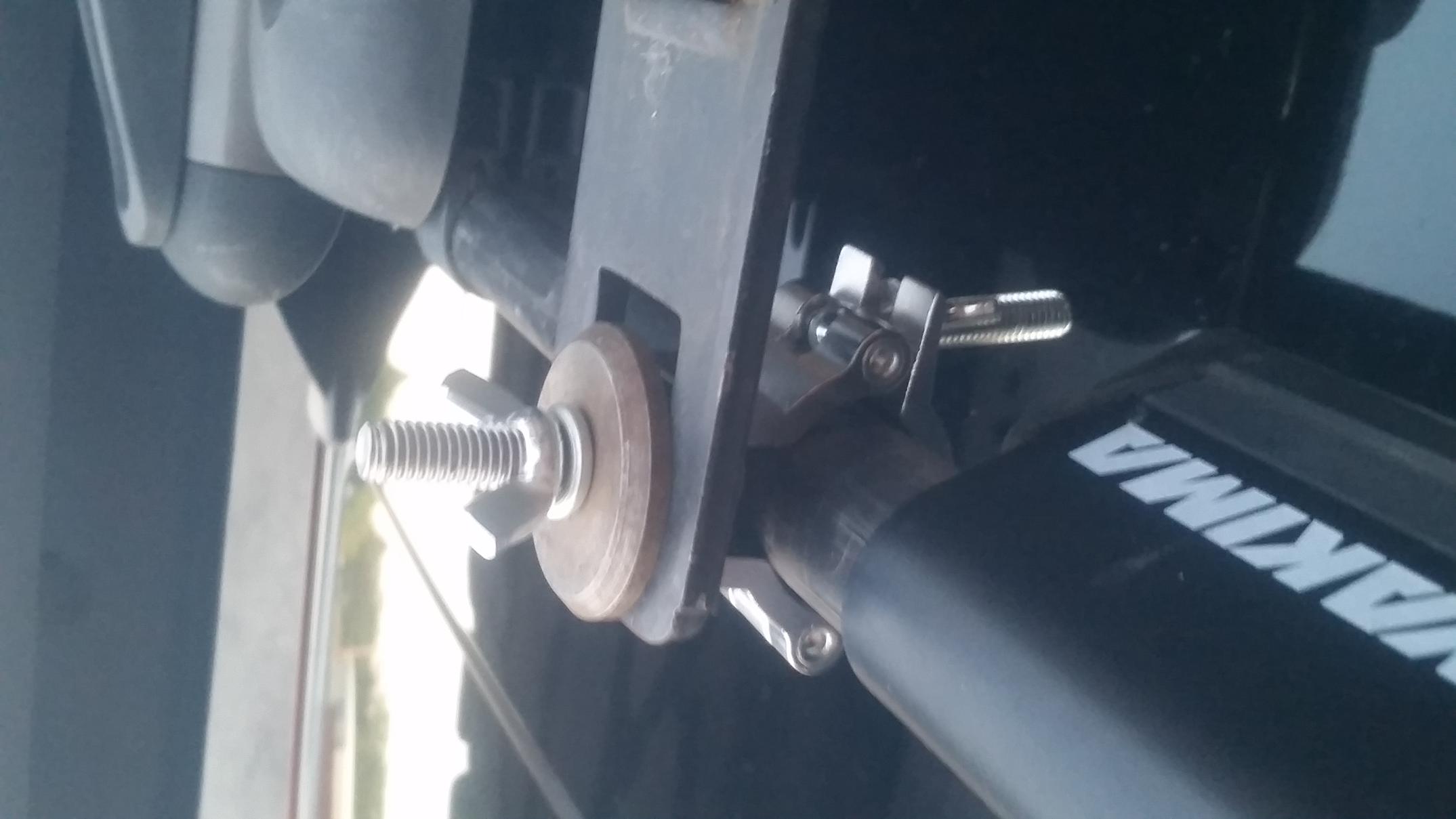

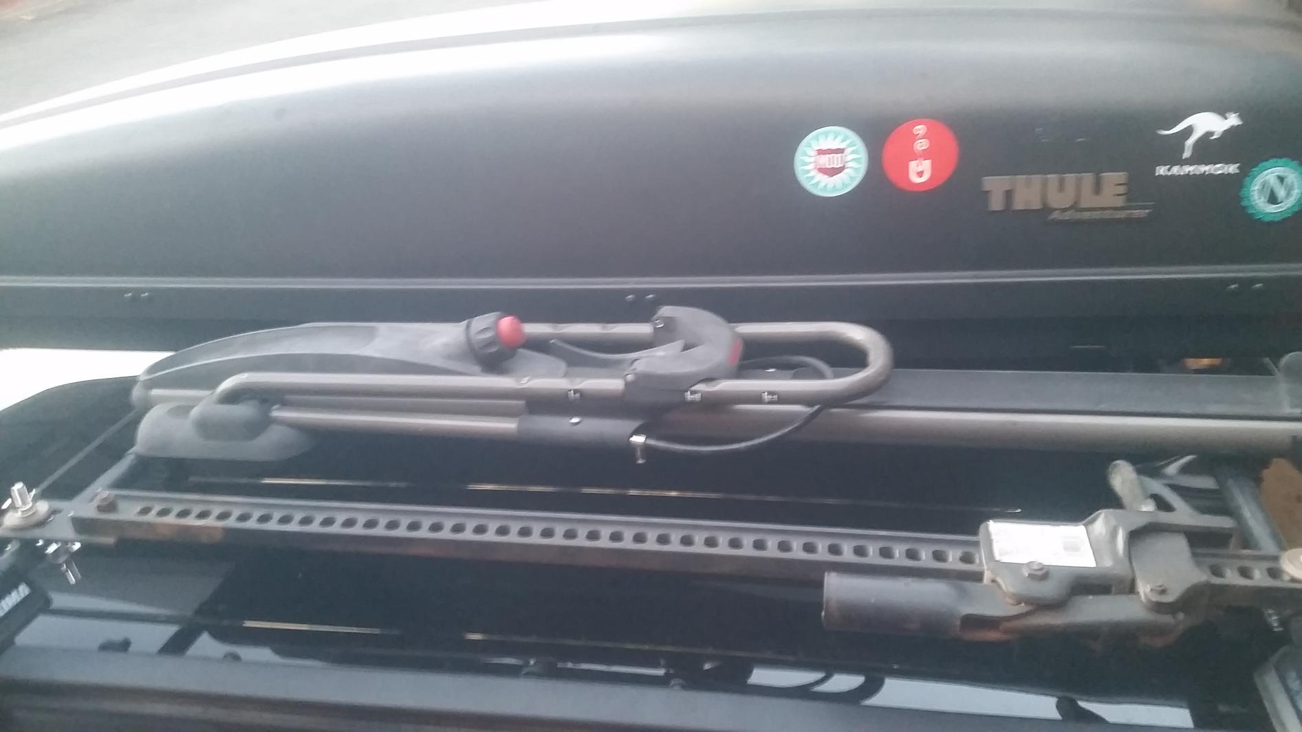

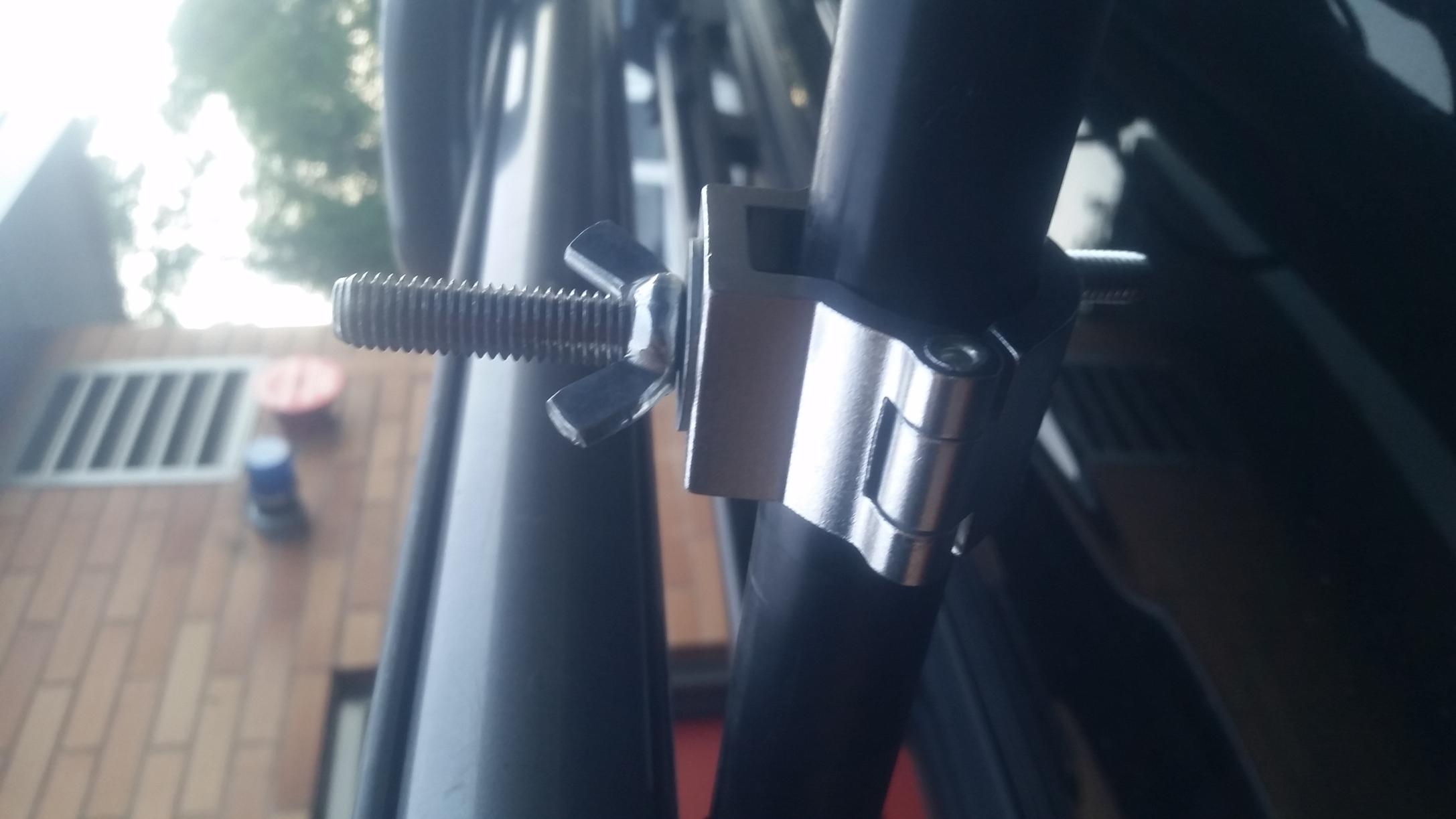

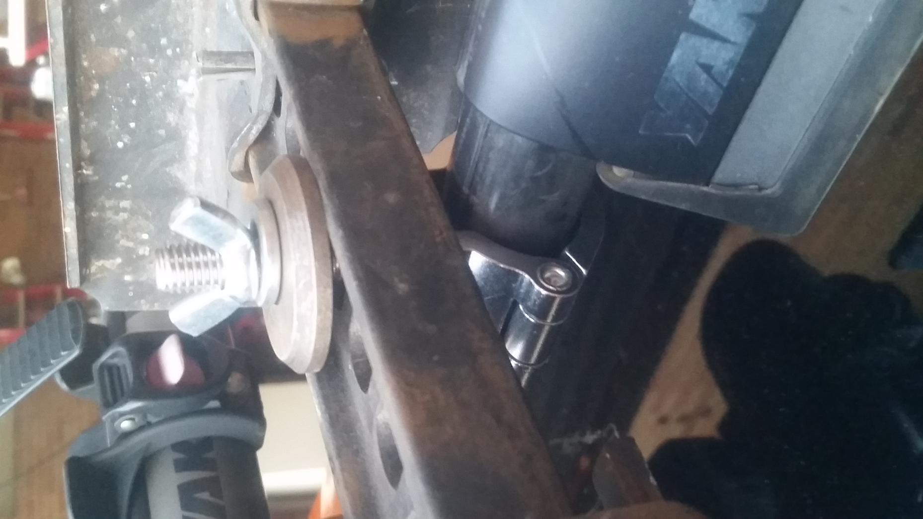

Latest mod: Hi Lift mounting
Finally:whoo: found a way to mount my i Lift onto my Yakima bars. I had to move the bars (48") over to allow for the box to be all the way over to the passenger side and allowing enough room for the jack and bike rack. I used TRUSST CLP35HC clamps found on Amazon for $10 each. I used a couple of heavy duty washers I had and longer grade 10.5 bolts. My only concern is using the top of the jack's attachment being the bolted on "eye". I may bring the bars close enough to use the beam as the anchor points for the clamp bolts to go through. Let me know if any of you have any thoughts.(:frusty: I didn't know how to shrink to pics down or to rotate them, they were straight when I downloaded the files)
