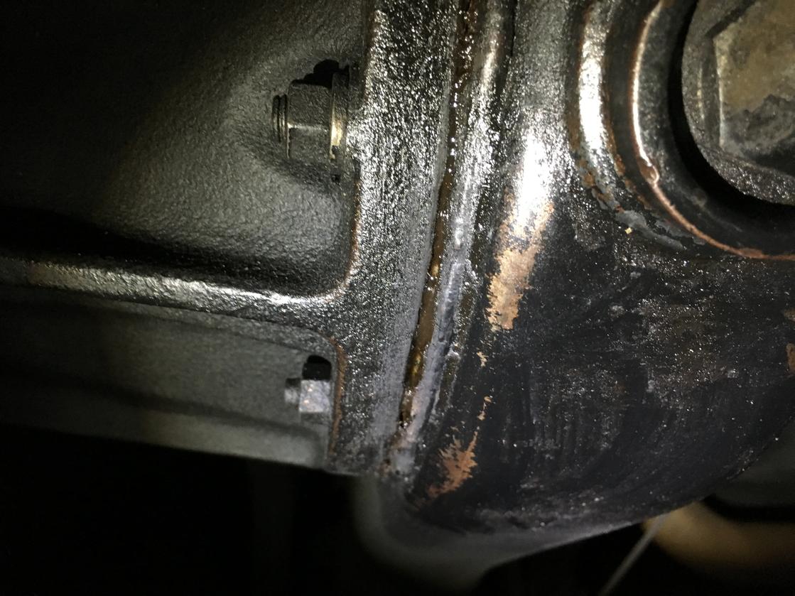

Anyone know how to change the rear diff housing? I've got a leak where the housing connects. Is this basically the same as the 3rd where it's just a sealant or is there a special gasket I need?
