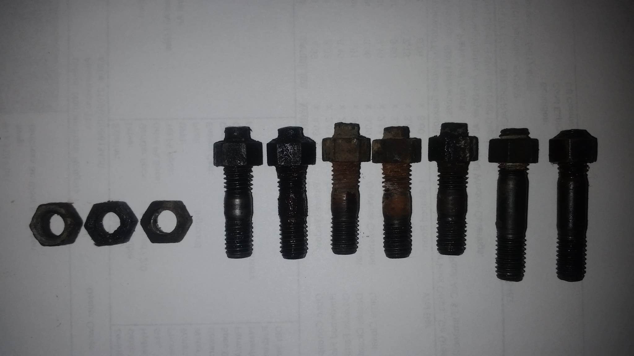

So another thing I just noticed after watching the video again is that 7 out of the 10 bolts actually came off. So now I only have 3 bolts in the axel housing. Also out of the 7 bolts that came off, 2 bolts are longer then the remaining 5.
Time for some new hardware plus I need to figure out how to thread the bolts back in.
Any input for anyone would be appreciated.

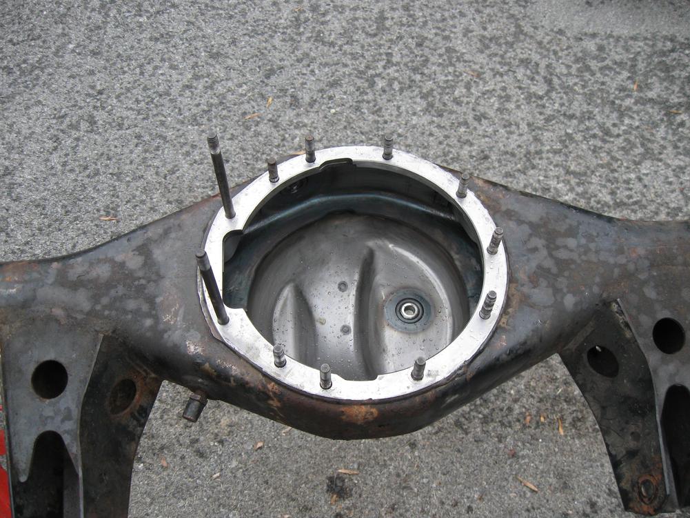

I had the same leak from the gasket so I decided to go the hard way & swap in an e-locker housing. I found a pic from my axle housing swap that shows where longer studs go. (not bolts). You wont have the 2 super long ones unless you have an e-locker. Good luck!
Nice! thanks for the pic scramble. I called up conicelli Toyota (thats were I grab all my Toyota parts) and he found 3 types of bolts. He was going through the measurements and we both concluded the super long ones weren't for me and thanks to your pic i now know what application they're used for, a diff with elocker. Unless Im missing were its located in the FSM, there's no mention of different size bolts on SA-91 and onwards.

All the studs protruding from my 2WD rear end appeared to be the same length from what I can recall being under it and negotiating the 3rd member...
When we figured out the bolts required the quantity for the short bolts according to the system was 8 and 2 for the medium sized bolts which matched what I pulled off. From what I've gathered so far the following specs determine the bolts required:
- with or without diff lock
- original wheel size 15 or 16
- 2wd or 4x4
For my config (wo diff lock, 16, 4x4) I require 8 short and 2 medium.
- 2wd or 4x4

The FSM only seems to distinguish rear ends between diff-locked and not, from what I can tell, but you are probably correct regarding different length studs - I just didn't notice it from underneath. I assume the third member has a slightly thicker flange in one area. All nuts however, are the same on mine and leave the same amount of thread showing when tightened.

When Im back in the garage I'll take a closer look at the housing to see if I can notice a thicker area because at this point I don't know exactly were the longer bolts need to go. The nuts are all the same on mine as well.
