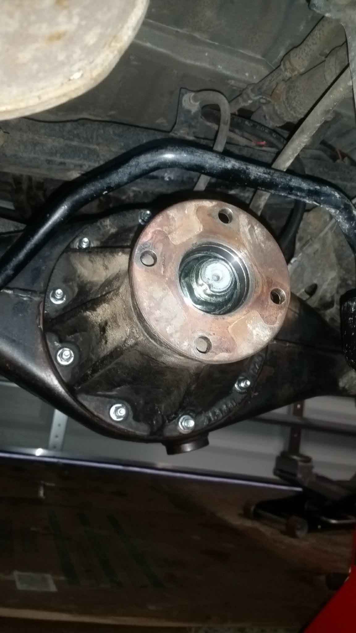

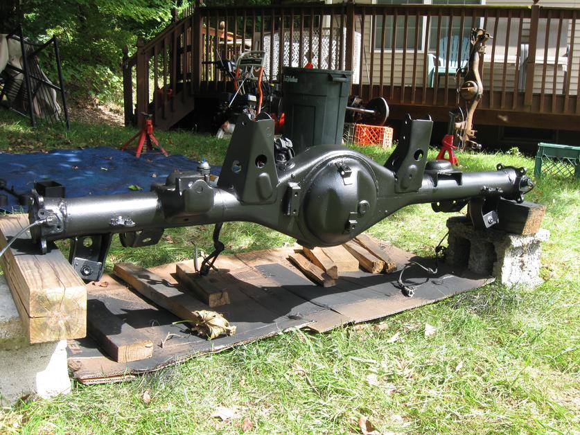

2 coats of Eastwood & 2 coats of VHT Chassis paint.

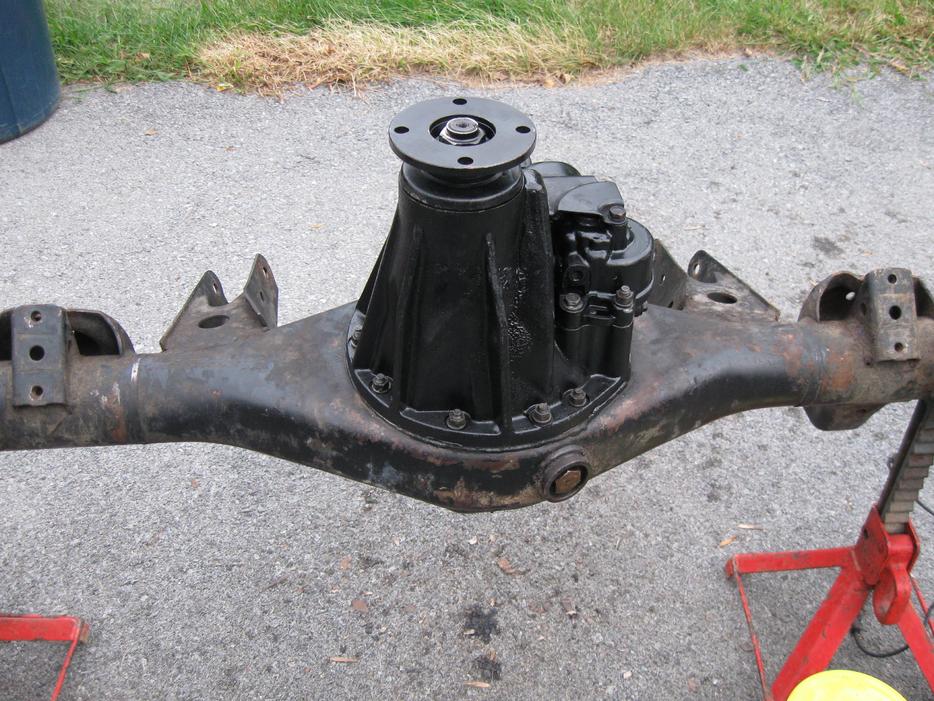

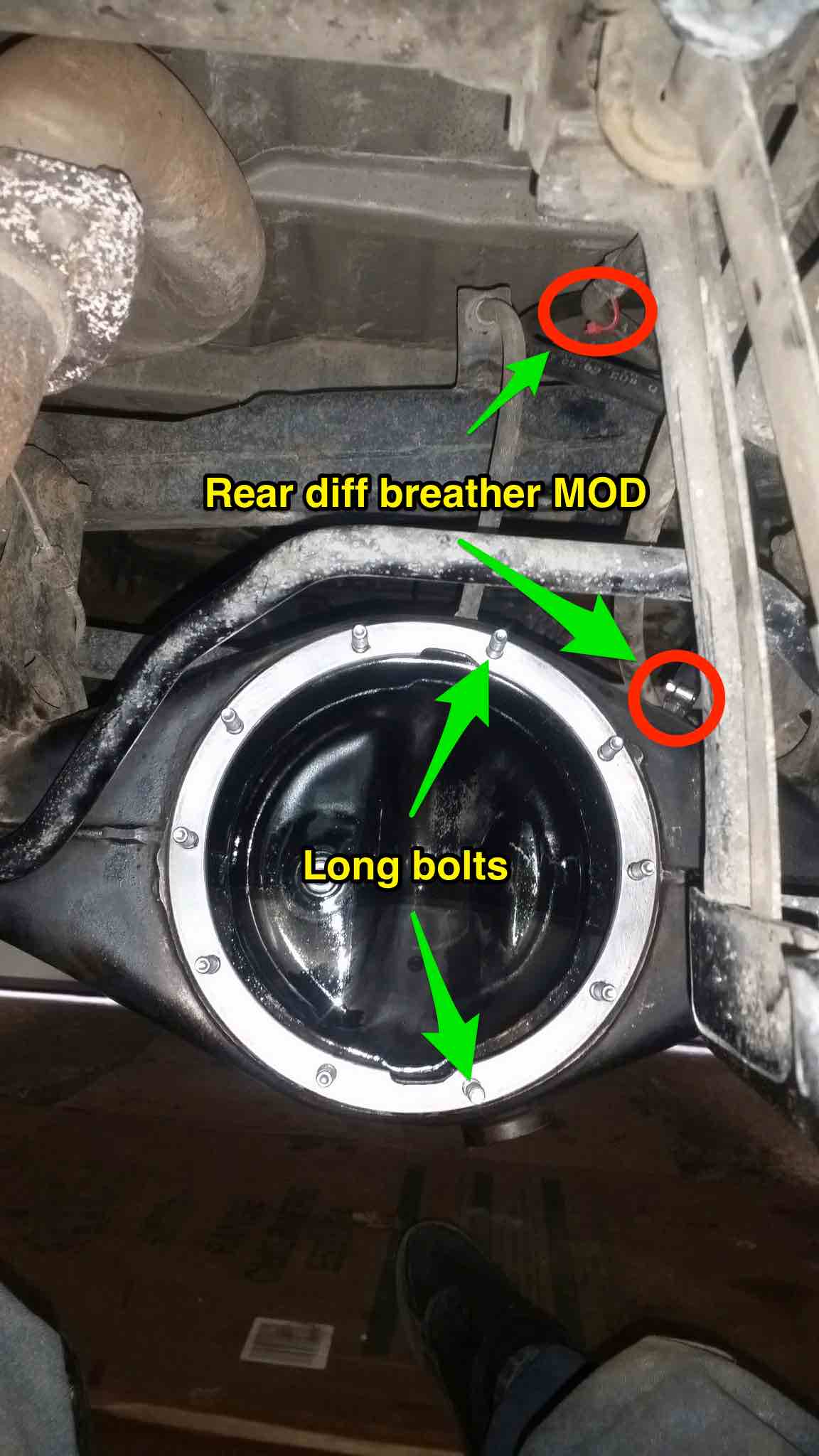

Hey folks so I just finished installing the rear diff back into its proper home. While I was at it I also did the rear diff breather MOD. Here's my feedback on the job with a few pics.
To answer [MENTION=99565]kolelt[/MENTION] yes the rear diff is heavy and more so when putting it back in but I managed. In retrospect the key is to align the bolts with the appropriate holes and just try and seat the rear diff don't try and jam it in all at once like I did because it has the potential to go in cockeyed. It took me a bit of jostling to get it loose before setting it properly.
Here's a few observations:
While uninstalling, 7 of my 10 carrier bolts came out and I also noticed 2 of them were longer than the rest when I pulled out the 3 remaining in the carrier. Since I had the bolts out I decided to get new hardware, here are the part numbers and quantity.
Toyota Part No.: 90116-A0018 x 8 (short studs)
Toyota Part No.: 90116-A0015 x 2 (Long studs)
Toyota Part No.: 90170-08204 x 10 (nuts)
Toyota Part No.: 94512-00800 x 10 (spring washers)
I wasn't sure where the longer studs needed to be placed but after examining the rear diff I noticed that 2 of the 10 bolt holes were flush and the remaining 8 were recessed slightly so that answered that question.
I guess there's a special tool to get these bolts back in but I just used two nuts and a 12mm socket wrench (tip provided by a mechanic friend). Just make sure the two nuts are pressed against each other tightly and when you wrench on the outer nut to tighten the stud back into the carrier the inner nut will prevent nut rotation on the stud.

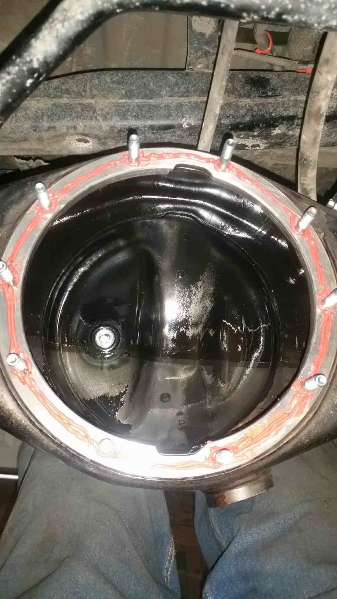

I used FIPG to create the gasket Toyota Part No: 00295-01281. It was my first time using FIPG and I probably used too much not sure if that's bad but only time will tell.

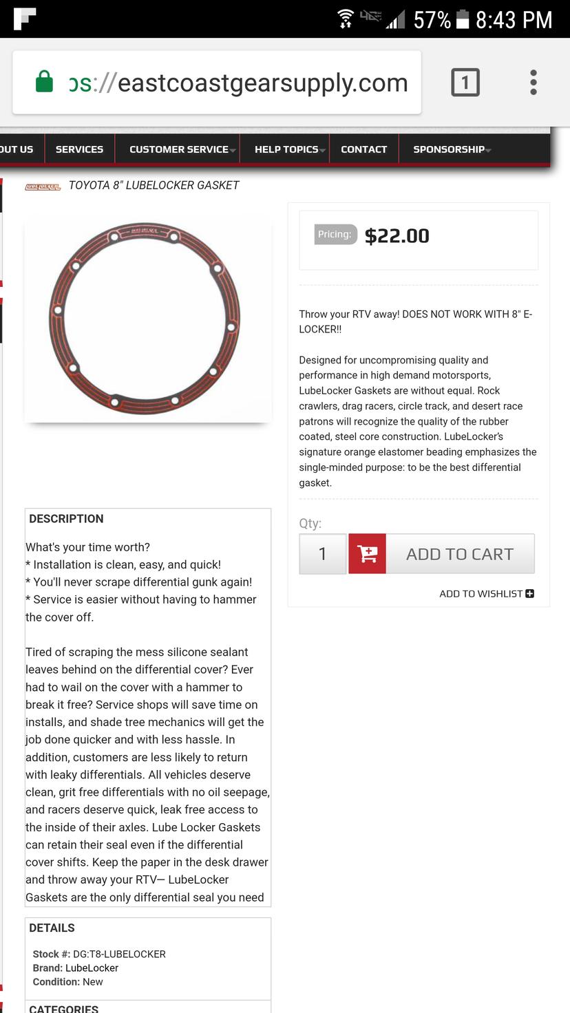

Has anyone tried using gasket sold by ECGS vs Toyota FIPG? I used FPIG when I installed ARB locker and now I am seeing a little bit of wetness around 3 bottom bolts. It is not leaking but if I have to do it all over again I will use a gasket instead. Really difficult not to mess up FPIG when putting back the third member.
