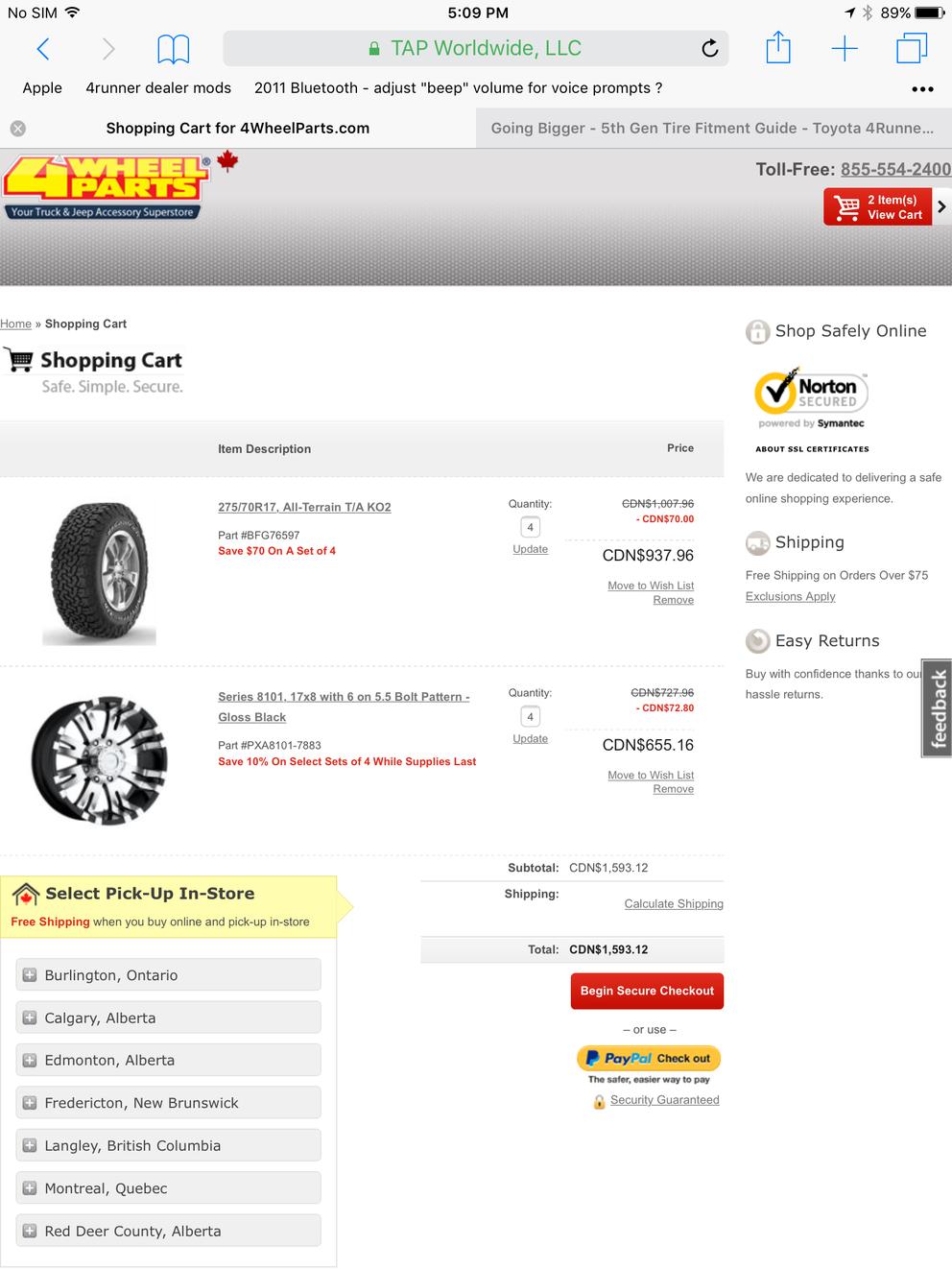

Hi,
Newbie here, I have read numerous times the enormous information on here for changing wheels and tires and my mind is overwhelmed to the point of wanting to just buy another set of stock tires for my limited rims! I have a 2010 magnetic grey 4Runner with no lift. I hate the "pizza cutters" this truck came with so I want to spring on some new rims and tires and finally have the wife's approval!
So attached is a combination I built on 4wheelparts.com and it consists of BFG All terrain ko2's @ 275/70/r17 and some rims that are 17" 6x5.5 @8" wide with backspace of 4.5" and offset @ zero.
Now the questions
Will it rub?
If so do I need a lift?(planning a spacer lift down the road)
What sort of modifications in the meantime to make no rub?
I can get these rims with 4.75 backspace but they are 9" wide with -6.6mm offset would that be better?
Mostly a soccer mom truck but we do go outback camping in the woods where there is no amenities.
Thanks in advance
Jonathan

Jonathan, please go back and re read the first post again. It was written as a basic primer for people exactly like yourself. What specific parts of the explanation don't you understand?
Basically the offsets and back spacing requirements. I understand via the 5gen tire fitment guide that those tires in that size are in the "green" for no mods but that presumes stock rims with stock offsets and back spacing. I just don't know how to figure out if they will rub. Mainly what I don't understand is the offset set at 0.
What does that do to the tire at full lock compressed?
I understand stock backspace on the trail edition rims and sr5 rims is 4.5 to 4.875 but offsets are not mentioned in the tire fitment guide? So with my rims I've chosen with 4.5 backspace and 8" wide rim will work , because the 9" rim will not( going back over your original post says many dealers stopped offering them cause of othe issues) with my rim having a offset of 0 matter?
Basically the offsets and back spacing requirements. I understand via the 5gen tire figment guide that those tires in that size are in the "green" for no mods but that presumes stock rims with stock offsets and back spacing. I just don't know how to figure out if they will rub. Mainly what I don't understand is the offset set at 0.
Should work. Might need to push fender liner forward a bit. Really just depends on your alignment... Also, make sure the wheels are hub centric and you get the proper center bore size or adapter ring.

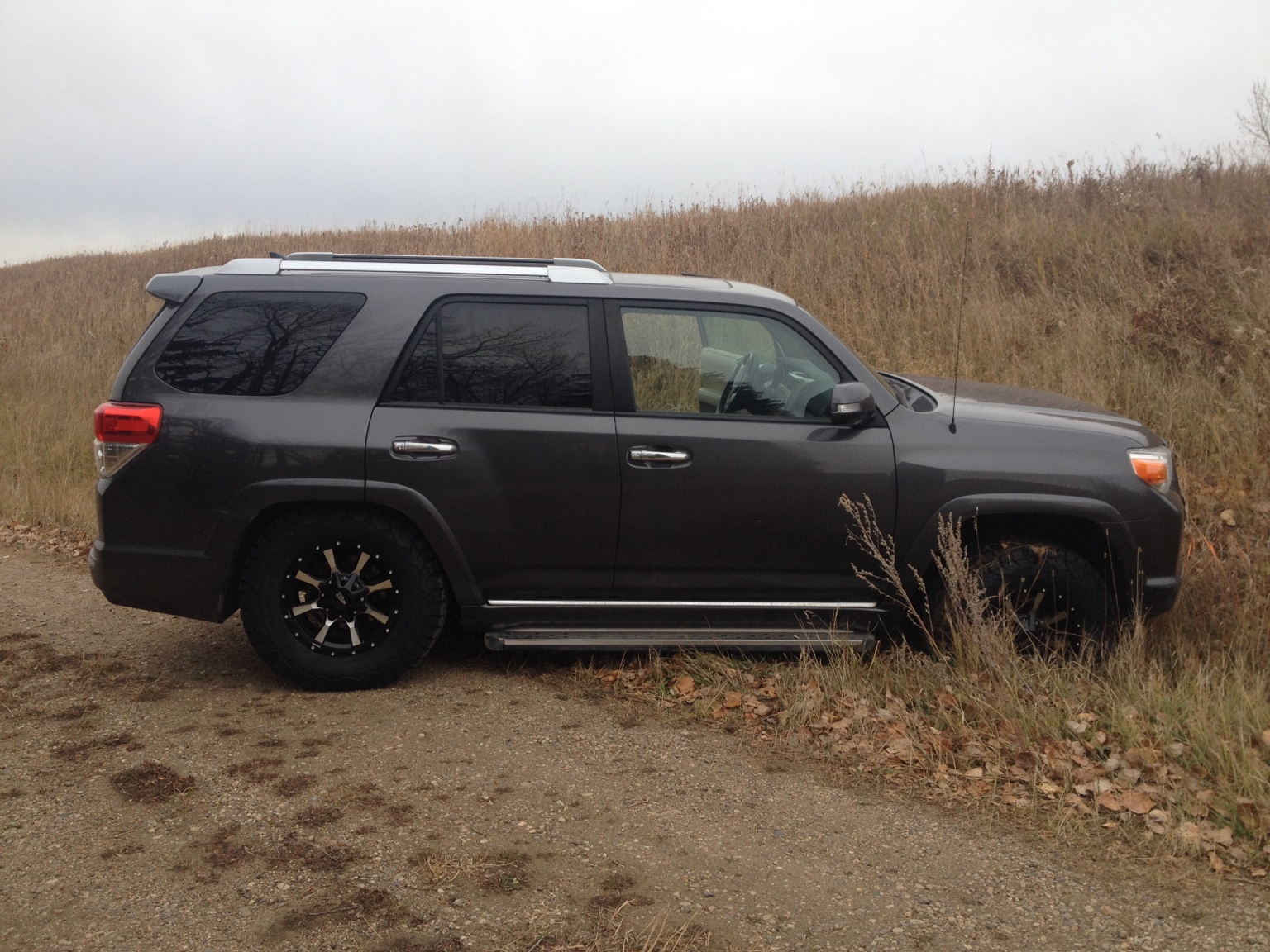

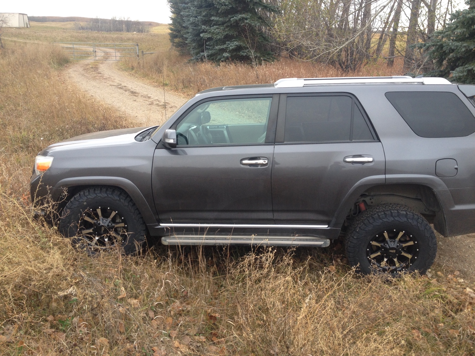

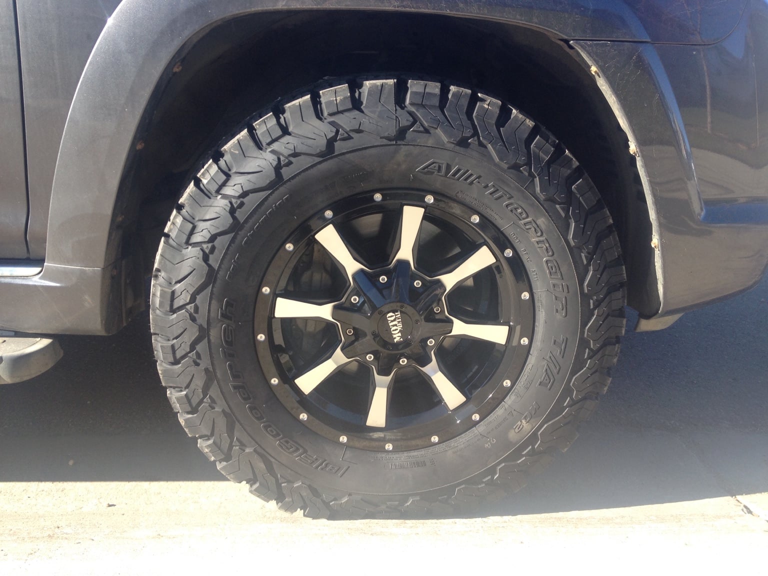

So this is my combo I went for. Moto metal 970 17x8 wrapped with BFG ko2. 275/70/r17. Had to do the fender liner mod but all is well now even when flexed out. Thanks all for the help. On a secondary note is 12oz of weight normal to balance this rubber? Got them to take the rubber off the rim and the rim is perfect but as soon as the rubber is put on 2 tires are 6.25oz of sticky weights inside the rim and 6.25 oz of clipped on weight on the the backside of the rim for a total of 12.5 on 1 rim! The other two have 3 oz and 2 oz.
