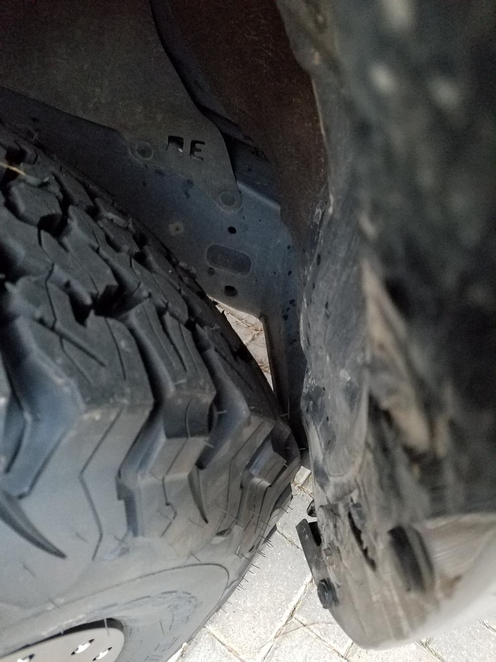

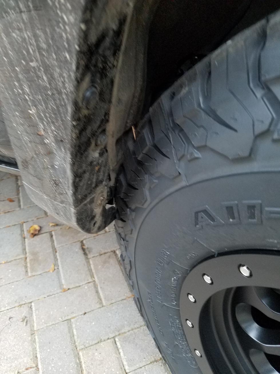

Need help/advice:
I just had a toytec ULK installed with SPC UCAs (set at +4 caster). I also had 17" x 8.5" SCS Ray10s on 285/70/17 ko2s. and I had spidertraxx 1.25" wheels spacers installed...Everything looks sweet, but I've come to realize it's not cool if you can't park your truck.. The back of the tires rub, so I removed the mudflaps, but it still rubs on the body mount. The front of the tire does not/never rubbed on the fender liner (should it? is the caster right?) So I guess my questions to solve the problem are:
1) Do I just remove the spacers? (decrease scrub radius)
2) Do I boss-up and do a body mount chop?
3) Any other advice?
If you want to eliminate contact, the body mount will have to be chopped back, especially if you're running spacers and only at +4 on the caster.
I removed my spacers when I went to a new set of wheels with a lower 4" BS. As far as stance goes, it's very similar and has the added benefit of eliminating the additional clearance issues associated with increased sweep angle. As long as you have enough space between the tip of your UCA and the inside of the tire, I'd say remove the spacers and give yourself all the clearance you can get between the fender well and the tire on all sides. You'll be much happier.
