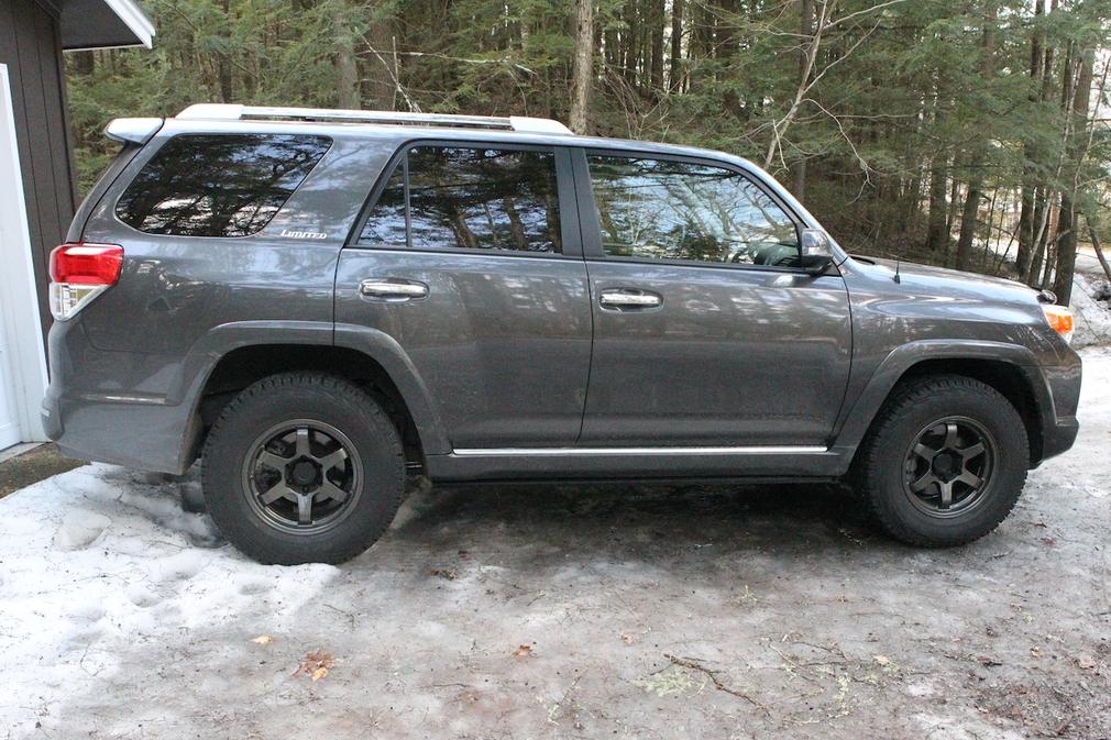

They will work just fine. Here's my 13 LE with Konig 17x8 0 offset and 265 Cooper AT3.

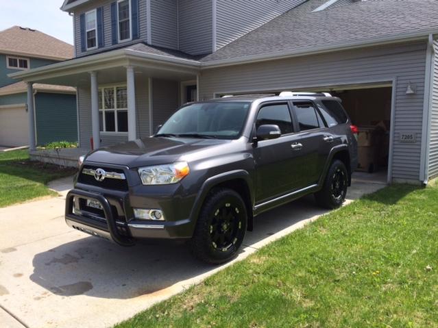

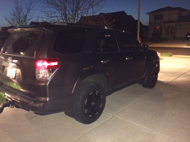

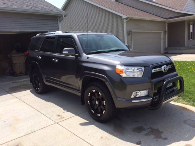

Got my wheels and tires on finally! Bull Bar has been installed too...no lift!

Keep us posted on how those tires do for you. I would like to know if you maintain your stock miles per gallon with these tires. Looks great!
