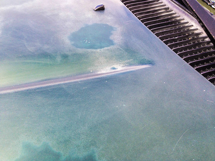

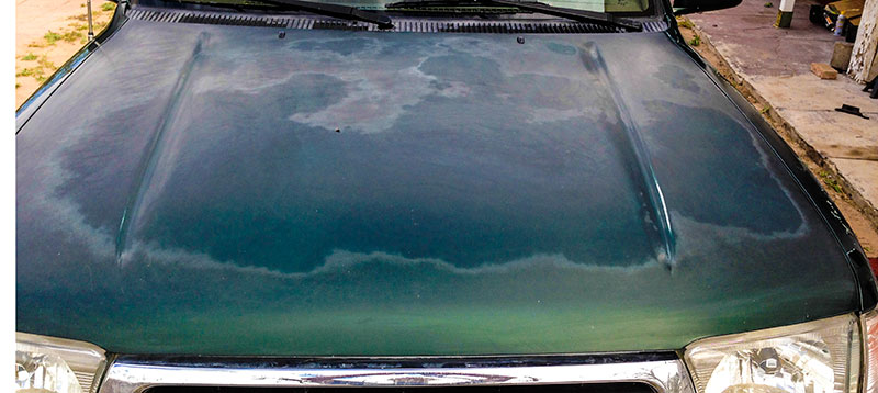

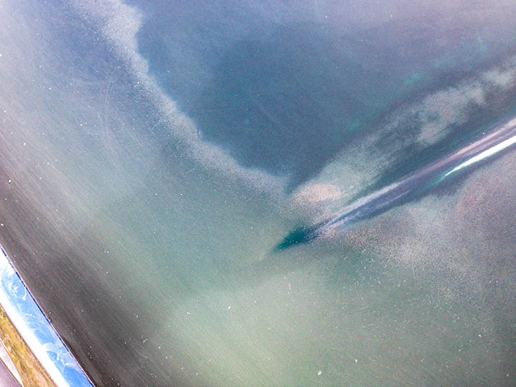

Attached are photos from today. Besides the swirl marks from the sanding this morning it looks MUCH better than before. Still bad enough that even the worst "rattle-can" job will be an improvement.
As I said a friend did a BBQ with the same paint and it looks pretty good a few years later; heat and grease.... This is just a stop gap job. I can't find anyone in El Paso who will either paint flat black or even color change…plus they want $200 for what I don't want..

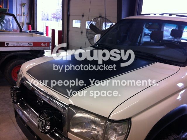

I haven't found any company that has a vinyl piece for the whole hood, but there is a place that sells a section...a couple people have used it. You can also try using plasti dip. I did a large section of mine a year ago and its still holding up great. Through the heat of the summer and rain and the little bit of snow we had. I even pressure washed it to get the mud off and it didn't budge. Pics are in my build thread.
As for cleaning, when everything is as smooth as you want it, take a micro fiber towel and denatured alcohol and give it a wipe down. Do it again right before you paint to get the stuff you can't see. After a couple coats see how it looks. You may want to do a fine wet sand, wipe with alcohol, and a couple more coats.

The plasti-dip I used is flat. Its actually helped out a lot with the glare since my hood was so damn glossy.
This was from the other day...
And this was the day I did it last winter...
I don't think it would be too hard to do your whole hood...it actually might be easier since you don't have to tape as much as I did. The part I did took about a can and a half, a whole hood would probably take 4 or so.
