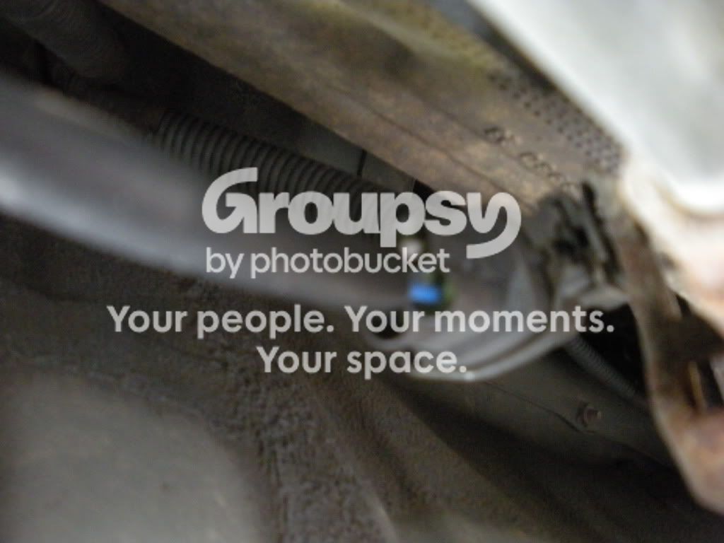

You need part #234-9002, all 2001-2002 4runners meet california spec. installation is a piece of cake, it takes one 12mm wrench, remove two bolts, unplug the connector, repeat in reverse order...
AFR Sensor
DSCN0387.jpg~original
Connector you disconnect
DSCN0388.jpg~original

Is it under the hood or under the car?
not really sure from the photos.

It is under the car, on the passenger side. I don't know of a machine that will test an AFR sensor, but every person I know that has ever had that code, a new AFR sensor fixed it. After a quick google search you will find that pretty much any toyota with that code is fixed with a new AFR sensor. Good luck!
AFR Sensor
