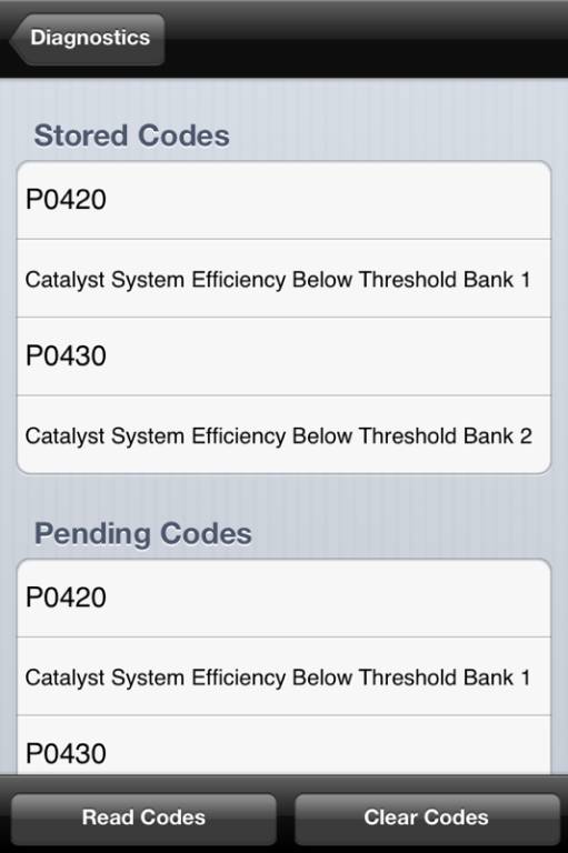

guys I got 2 codes P0420 and p0430
i got this after I welded my manifold and forgot conect o2 sensor after i installed exhaust manifold back .
What does codes mean ? How I could fix that . I have no traction control and living in cold alberta .
There is no egg smell . Car runs great !
I have a tick from driver side manifold
are the o2 sensors hooked back up now? If not, connect them and clear the codes and see if that solves the issue.
