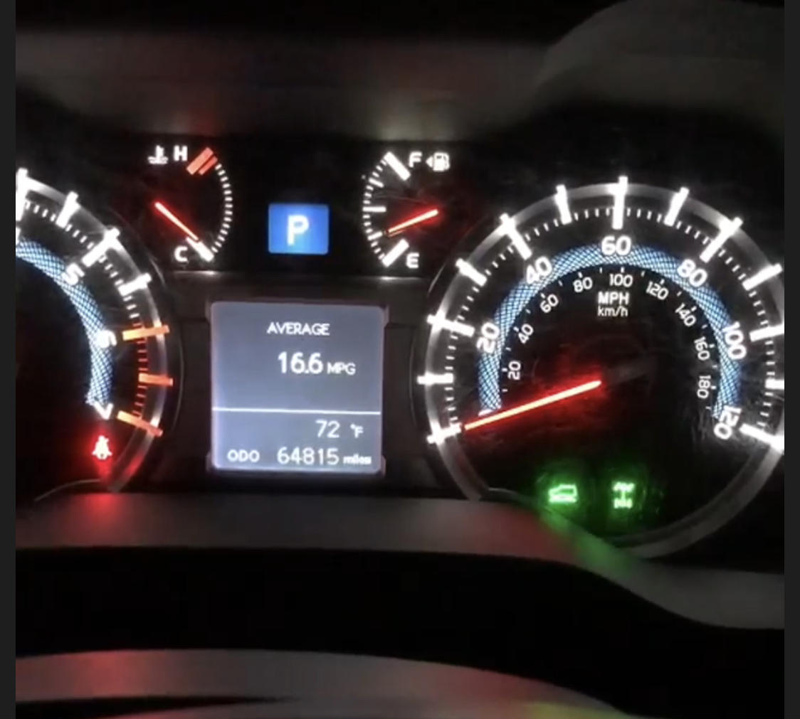

Trail edition 5th gen
My 4WD indicator light and crawl control feature lights constantly stay blinking of and on of and on, also, am not able to use crawl control features such as locking rear diff, multi terrain, etc.. . Unplug battery, reconnect, still there. ABS wires replaced, still there, performed yaw control 0 point calibration, still there. Any ideas on what to do next?
Mike, this is the 4th Gen forum and you have a 5th Gen, you may have better luck with your issue if you post in the 5th Gen forum.
That being said I would go to your local auto parts store and see if they can use their OBD 2 code reader to see what trouble codes you have to start fidning out what the issue is with your light being on.

I see, honestly don’t think so, every one on fifth gens finds their solution through the above methods I’ve tried. Also, I have different lights on then them so it’s leading me to believe it’s an entirely separate issue. Just those 2 green flashing lights. (Crawl control/multi terrain) + (4WD icon) with no codes being thrown at the local auto store
