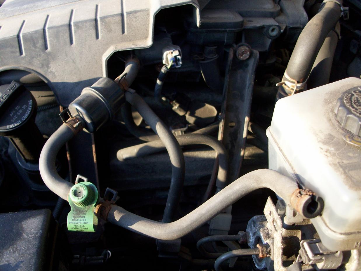

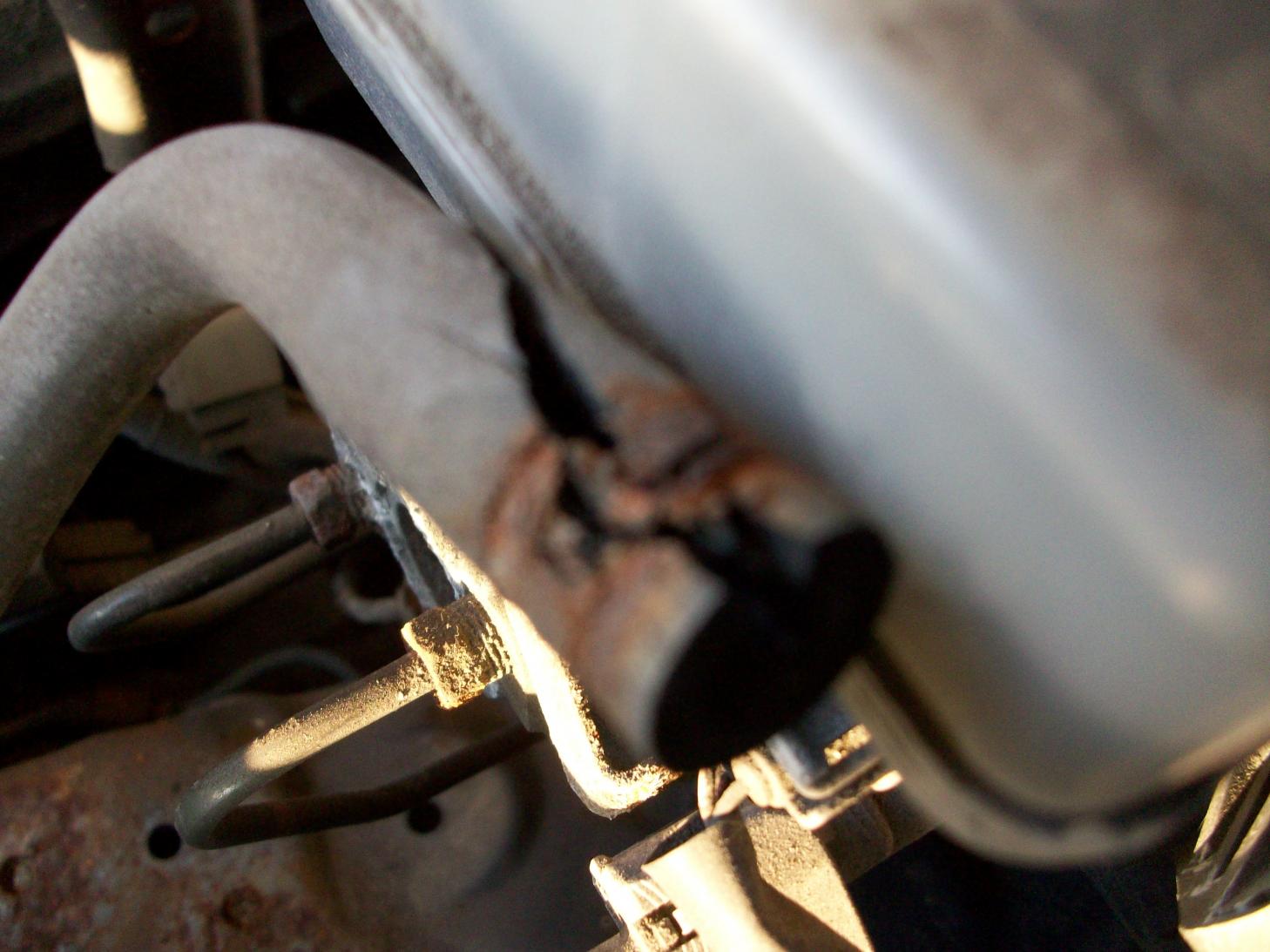

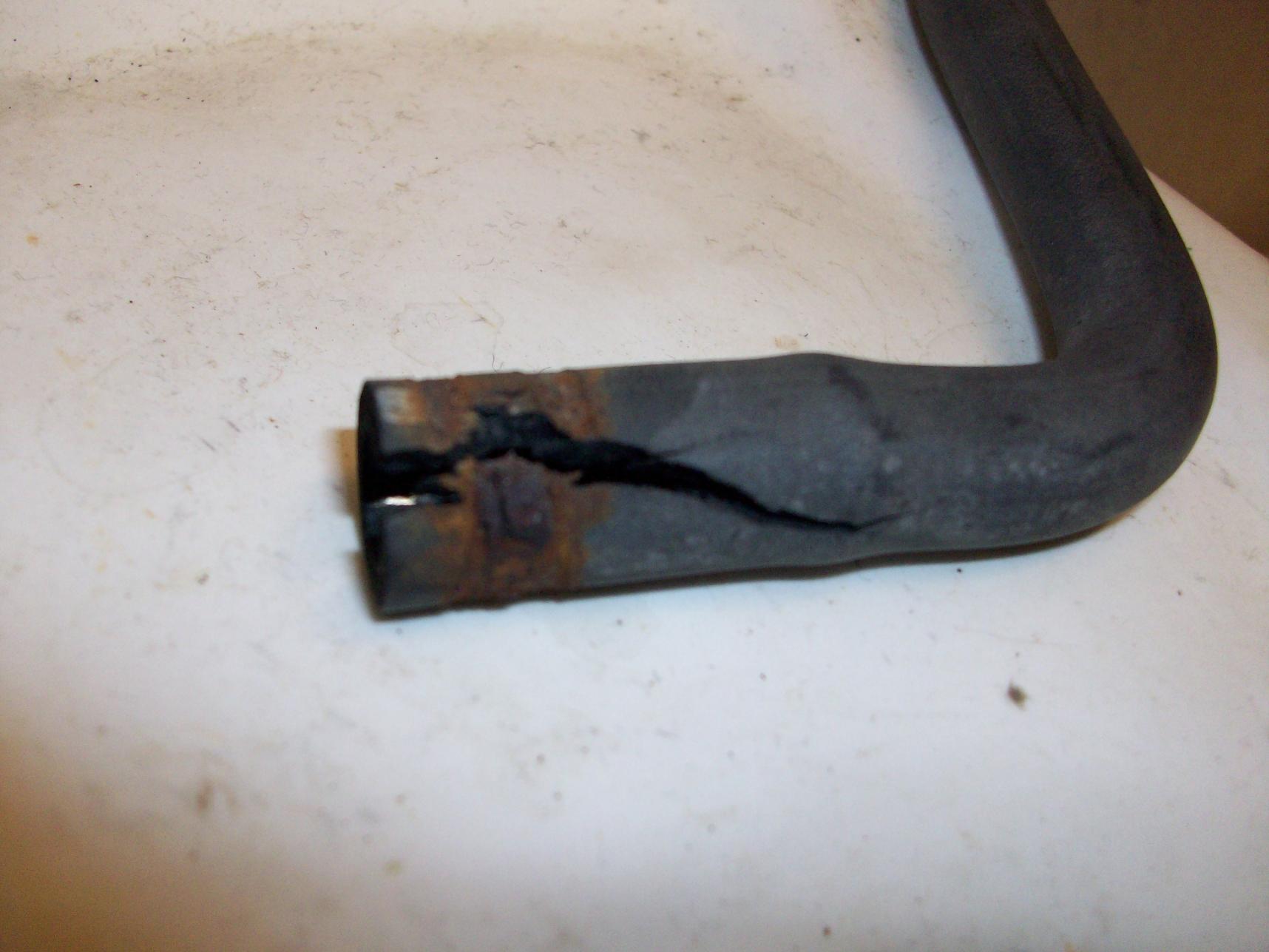

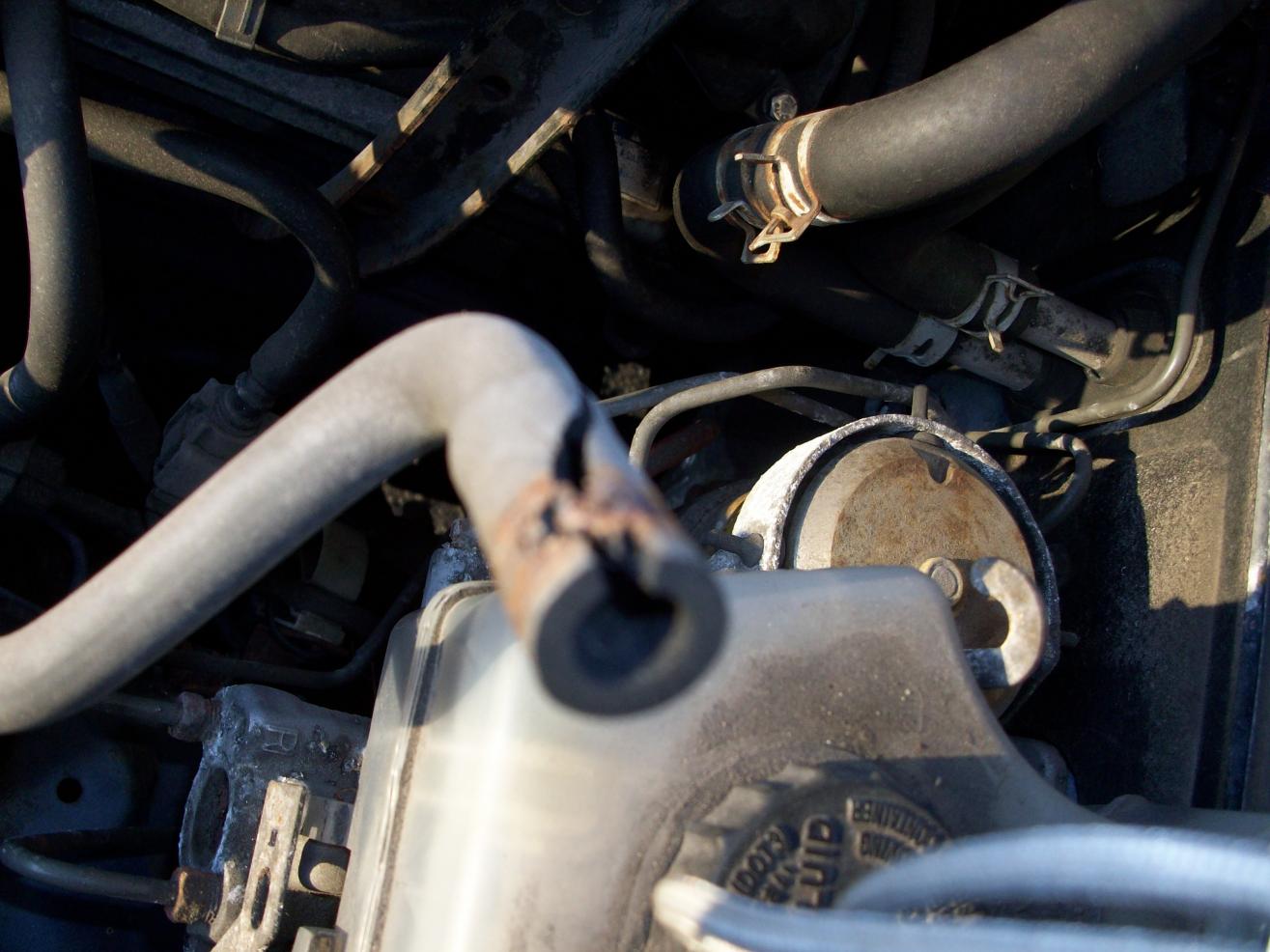

Absolutely fantastic info about CEL (CHECK ENGINE LIGHT) codes. I had a P0442 and some others about a EVAP leak (VERY SMALL).
I tried 3 different gas caps and 5 different O-Rings. Reset the CEL light. But the codes came back within 50 to 95 miles.
THE REAL PROBLEM WAS A CRACKED HOSE. See pictures.
2004 SR5 V6. The hose is on drivers side between master cylinder reservoir and oil fill cap. Very hard to see crack. It was facing the engine. $1.00 piece of vacuum hose. No codes for 2000+ miles.

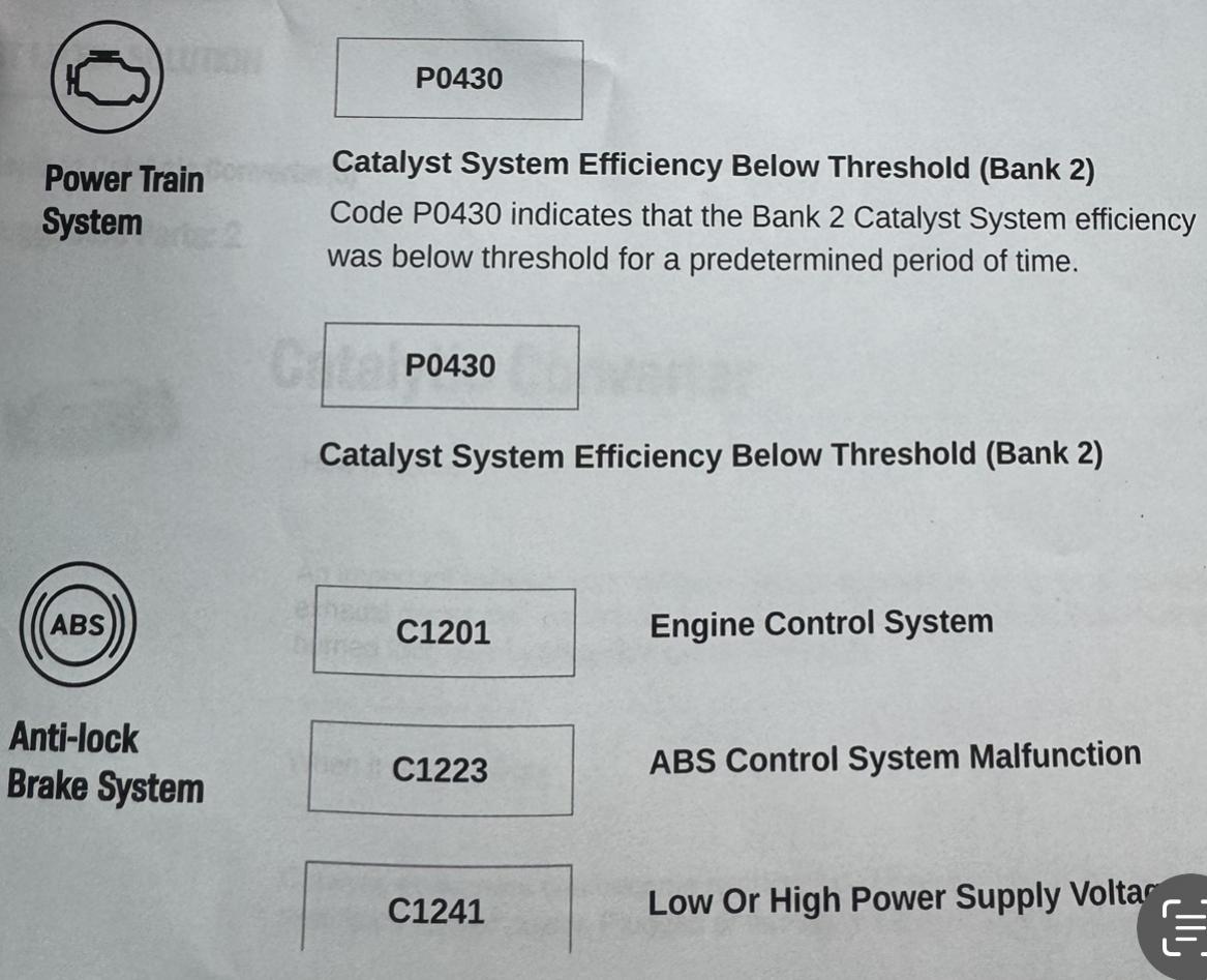

Had some codes come up, read this and not sure what to do!
So I just did my alternator & battery (remanufactured oem denso alternator & costco battery) after my alternator went out. After that I got the brakes & rotors done by a local shop. Once I got it back I drove for about 30 miles then the lights came on (VSC off, trac & check engine)
I got the codes checked and I have P0430, C1201, C1223 & C1241
Any idea what this could mean? Could any of this have been caused by the shop that did the brakes?
Any advice is greatly appreciated!

I'd clear the codes and monitor it. Some of the C codes could be from when you had alternator/battery issues. The P0430 is pretty common on a high mileage Toyota, could be from weak cats, leaky exhaust or lower o2 sensor.
