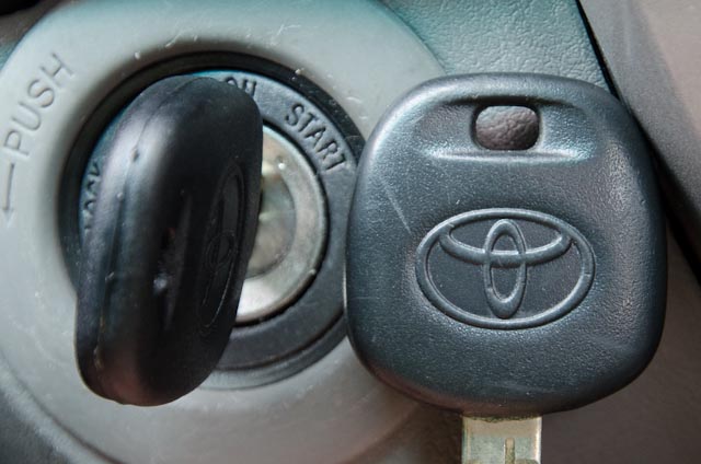

OK, I live in a very rural area where I'm way more concerned about losing my key, or locking it in the 4Runner 10 miles out in the woods at 2 a.m., than I am about some SOB with a fake key getting in and driving off with it. I'd unplug the immobilizer if that was possible, I just don't want it on my vehicle much as I love the 4Runner. I've got a "master" key (with the little dimple on it), a valet key and 2 remotes, that's all that came with it when purchased. I bought 2 chipped blanks from ebay (they have the Toyota logo but might be knock-offs, I do not know) since they were only $12. as I learned a locksmith (50 miles away) could program them for me ("most of the time" he said) for about 2/3 of what the dealer (50 miles away) quoted by phone. Still more than $50. per key though. It really ticks me off that these keys are so expensive from the dealer--and it's inconvenient to go there.

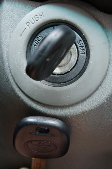

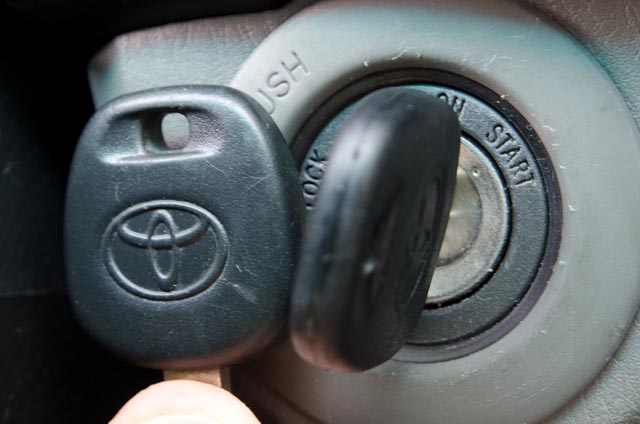

Did some reading here though, and took one "ebay" key to close by hardware store where my buddy cut it at no charge (but could not program it of course). Just holding my master key near the "ebay" key allowed it to start my 4Runner (see photos...ebay key is in ignition and started engine, with master key as shown in positions nearby). It would continue to run afterward when the master key was removed from the area. If I had the master key a little too far away, the ebay key would crank the starter but the engine would not start.

Well, what I missed in the earlier testing is that this technique doesn't work very RELIABLY. :redbrick: I had the left/lower dash out of the way (got my key reminder/door open/annoyance chime disabled while I was in there, yahoo), and tried temporarily taping a master key in various positions around the now-exposed key opening/cylinder. The "cheap" key would then SOMETIMES or even OFTEN start the engine, if the master key was in just the right place. It has to be out front a bit, it can't be back behind the key cylinder. That usually put it in the way of inserting the other key. I thought about cutting open one of my two master/valet keys, taking out the chip and putting it on there (I really wanted this hack to work), but in the end, decided it was not going to work well enough. I have ordered a XPressKit Data Transponder Override Interface at Amazon.com (PKT1 version) as advised by others here, and will give that a try next week. For $32. it's worth a shot, and who knows maybe I'll put in a remote starter later too, which I believe is the reason they make the XPressKit Data Transponder. Might be handy when it's -20 again next winter.
If anyone else reads this and wants to try it again, a couple things I learned: the chip (in the rubber part of the key) needs to be right next to or in front of the white ring you'll see when you take off the lower dash; this ring encircles the key cylinder/opening and must be some kind of antenna that reads the chip in the key. Also it seemed like the master key worked quite a bit more reliably/often than the valet key did, when holding it up to the cylinder and starting the 4Runner with the "fake" key. Maybe it has a bigger chip or something.
