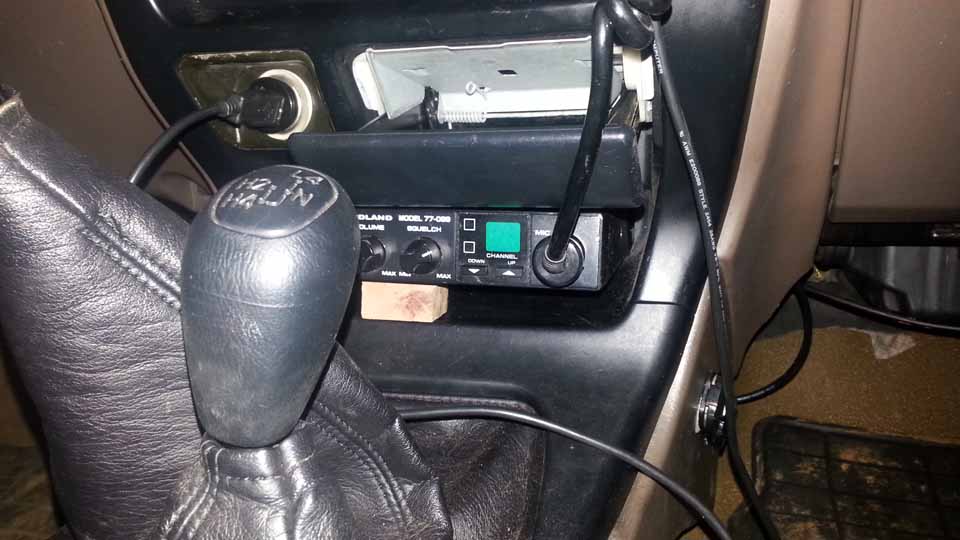

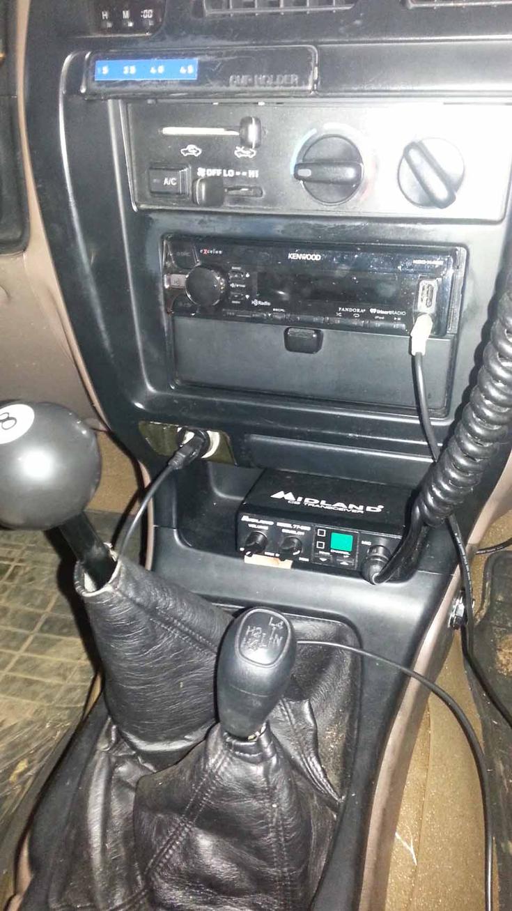

Here is the CB I mounted. Note that the ash tray is fully functional!

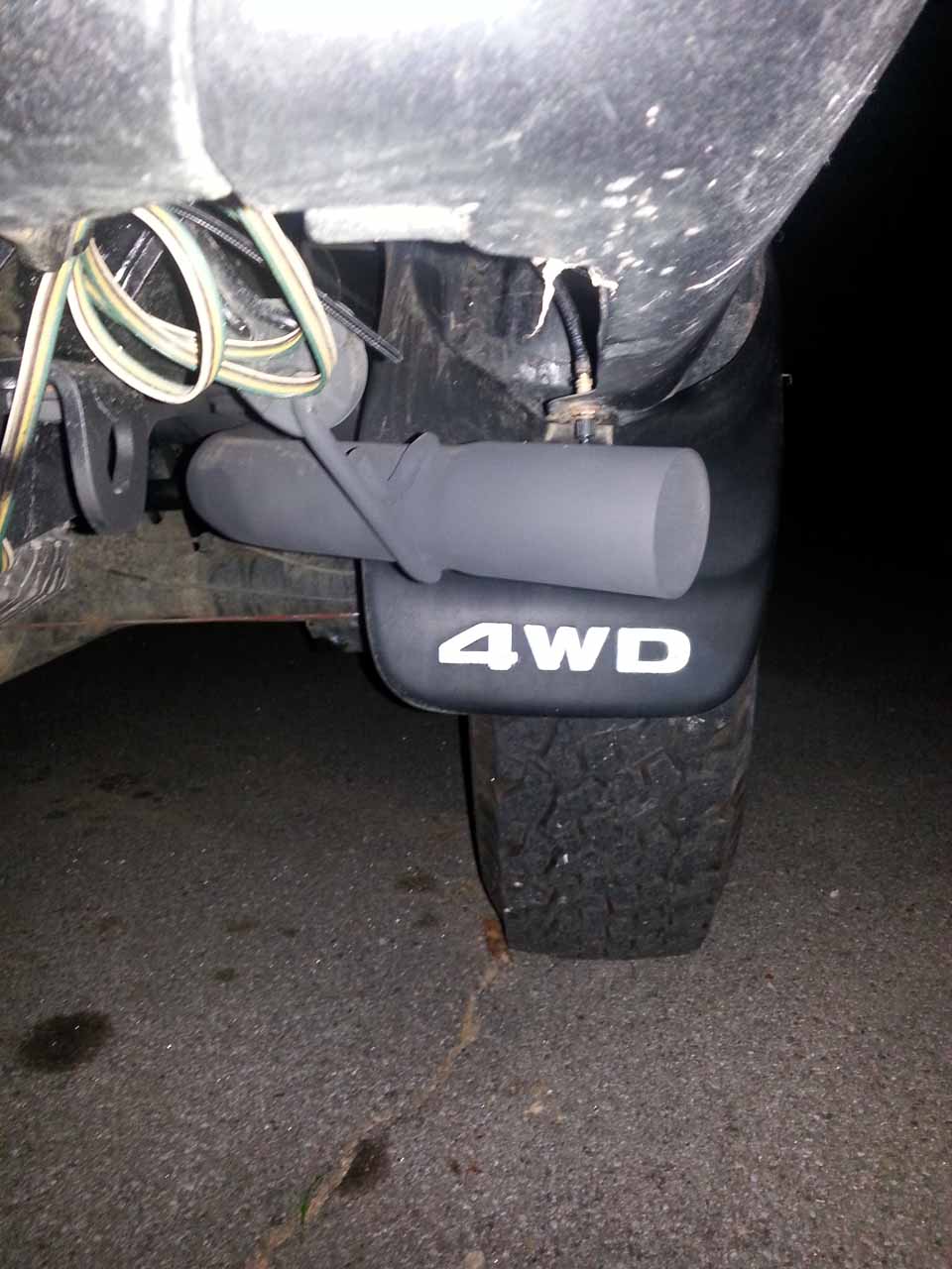

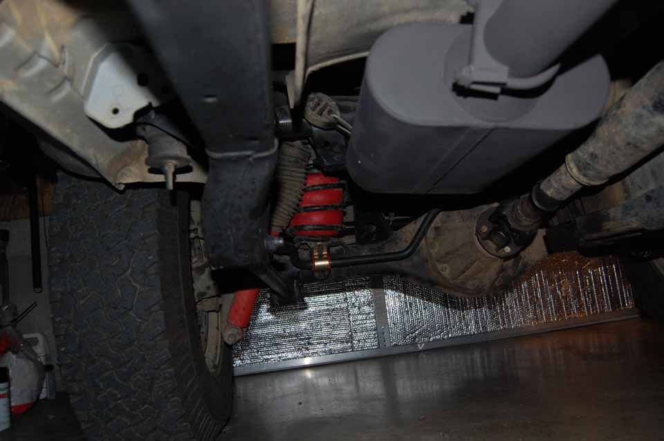

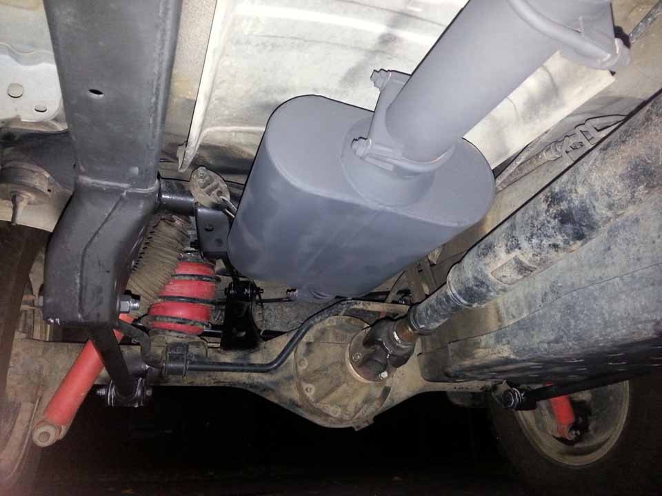

I got a fresh coat of paint on my exhaust and frame. I need to go over the frame again to get the spots I missed.

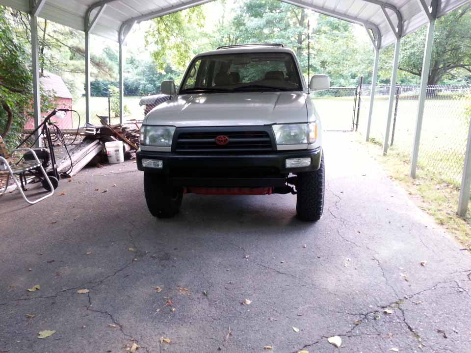

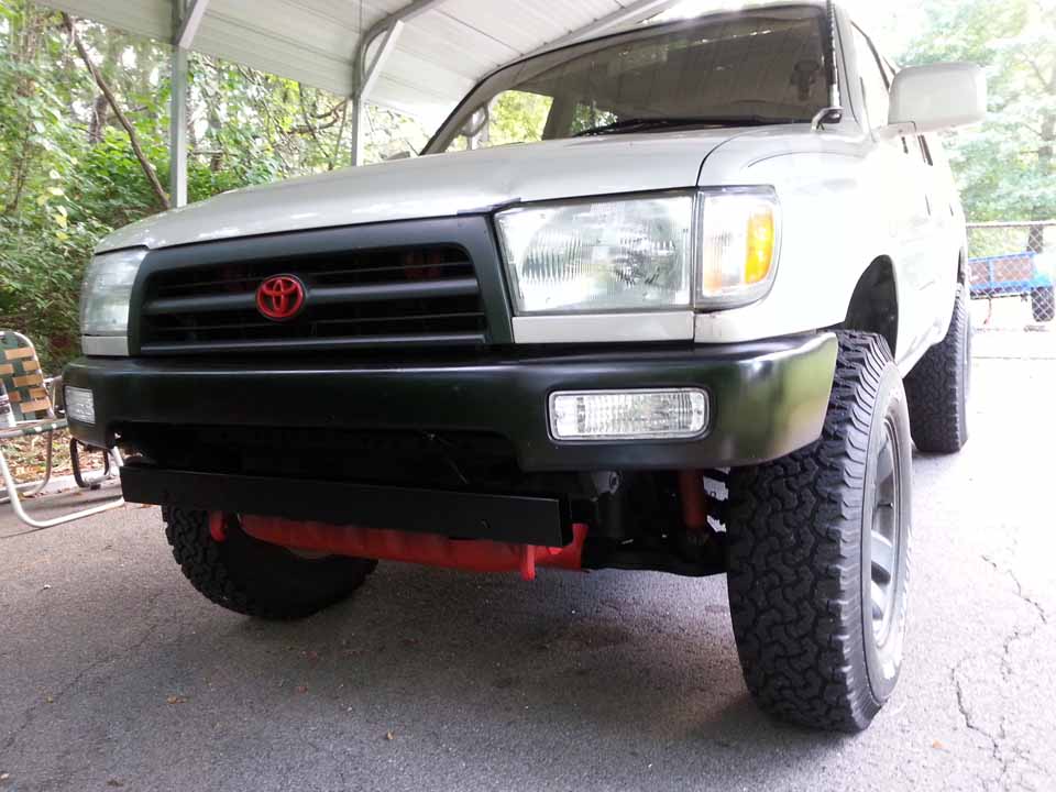

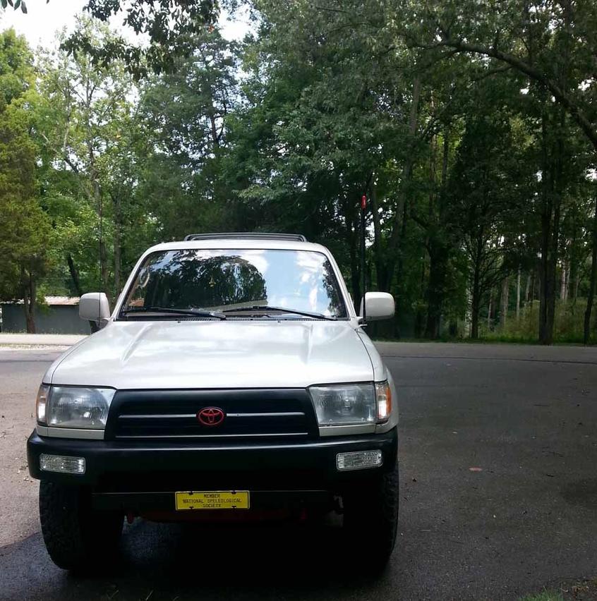

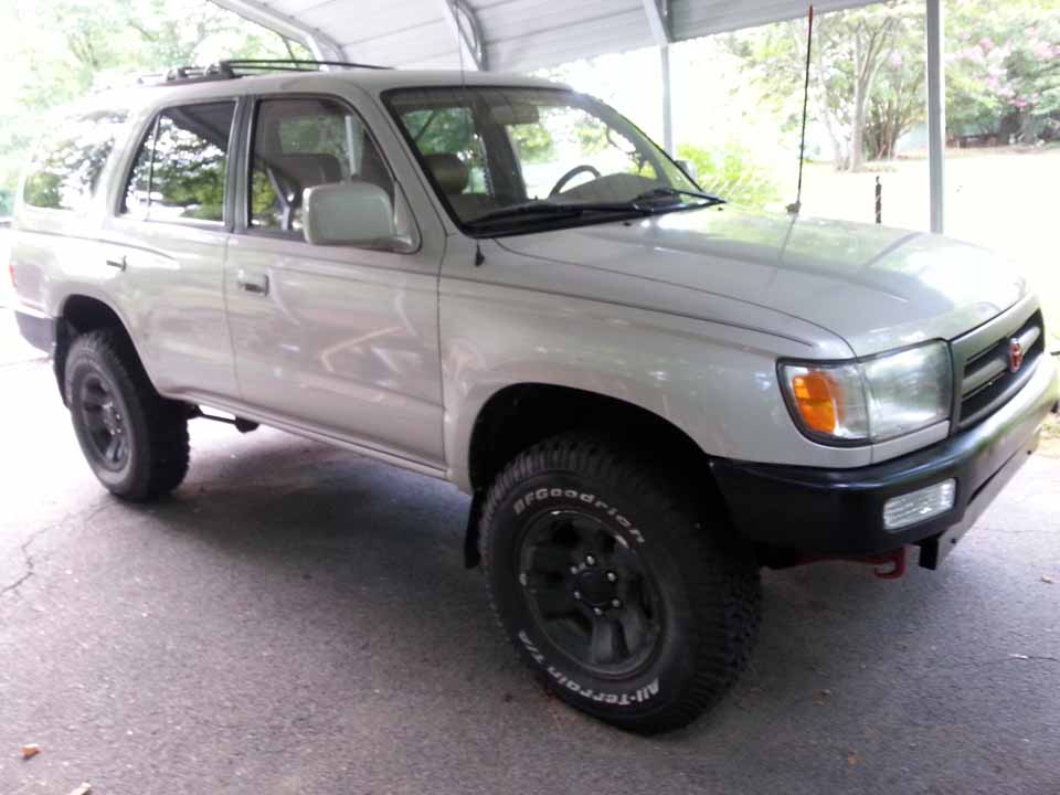

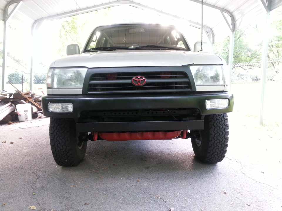

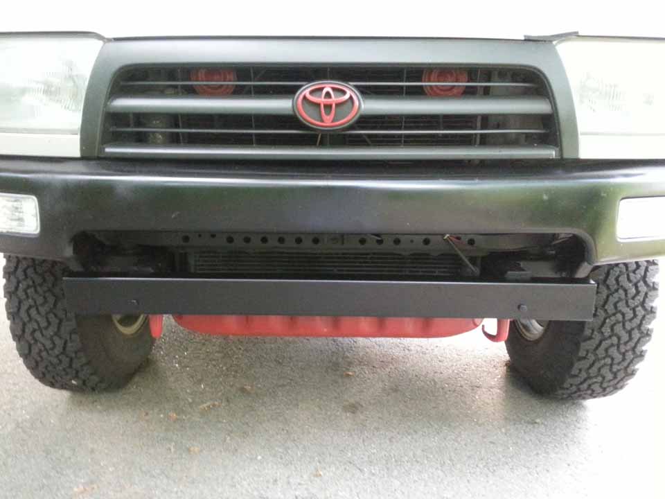

I got my front end finished yesterday. It is 1/8" thick 1.5"x 3" steel tubing. I just need to put another coat of paint in the OEM bumper.

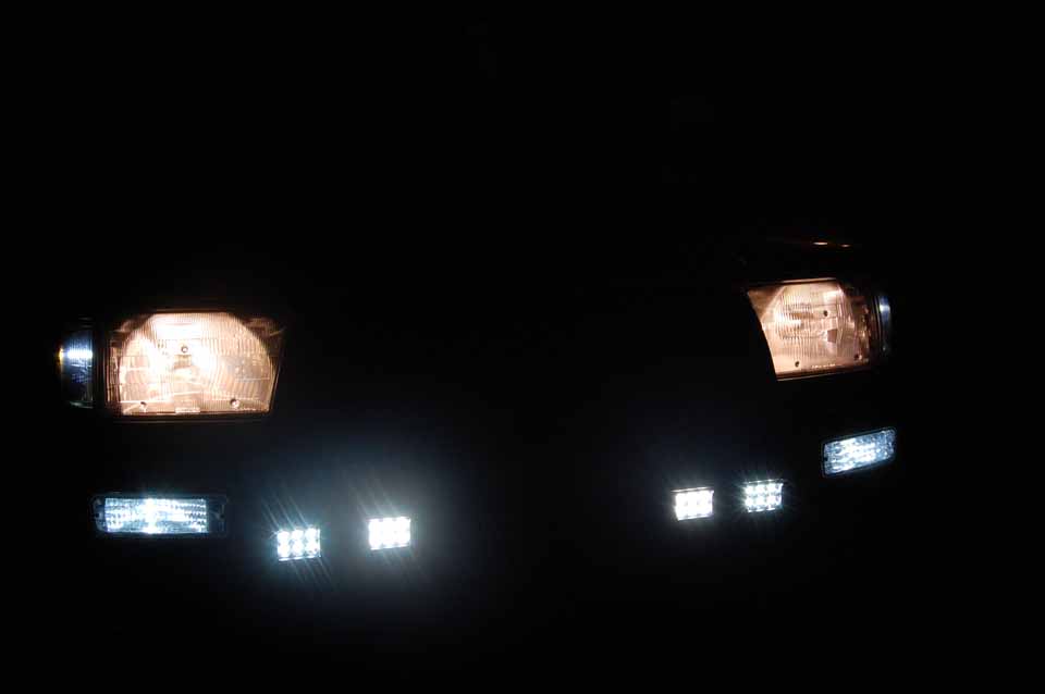

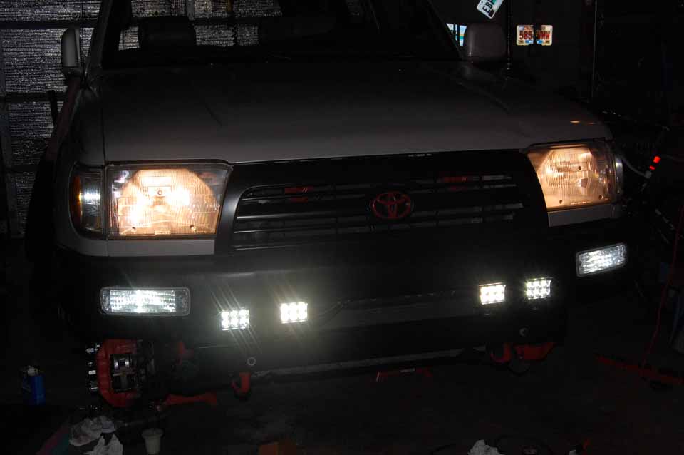

We adjusted my headlights tonight and tested the cheap eBay CREE LED pods.

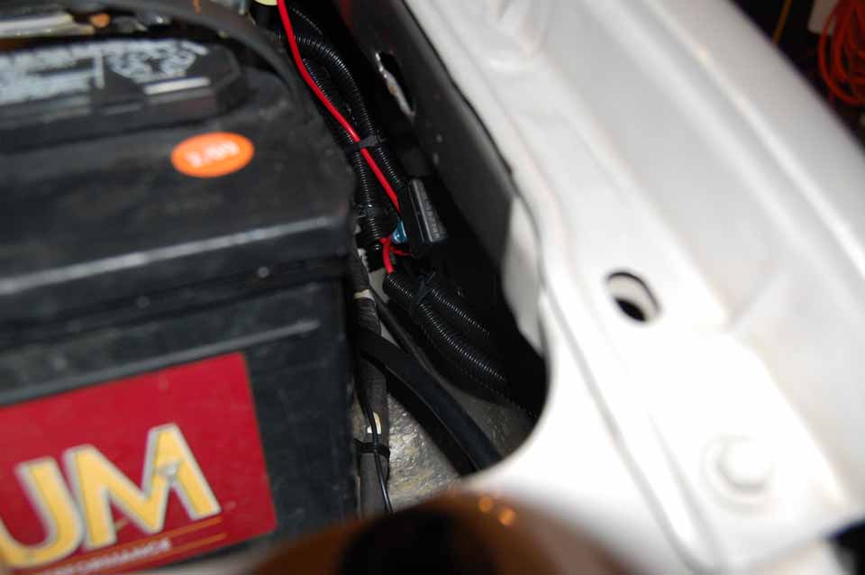

I'm also wiring up my LED lights tomorrow. I got the relay in last weekend and have some pictures. I also made all my wiring look better :)
I'm going to have 2 floods and 2 spots with separate switches.

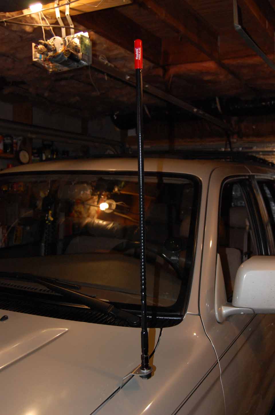

Antenna pic

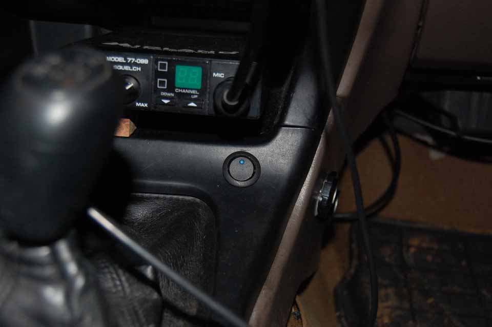

Relocated ADD switch

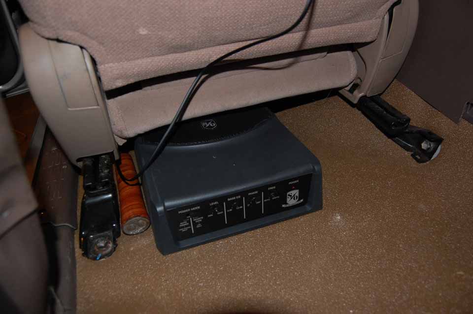

My new subwoofer! It is a sound ordinance 8" 125 watt slim. It just barely sticks out the back of the seat. Sounds great too!
With the seat all the way forward

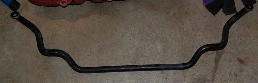

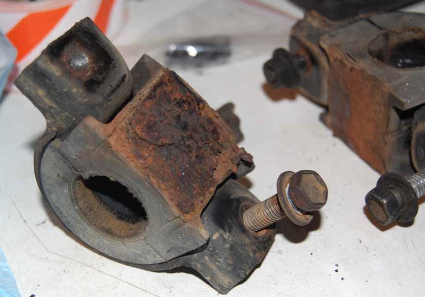

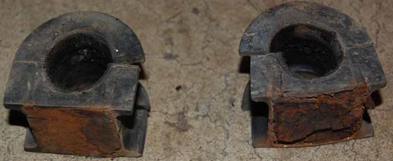

Swaybar that needs to be painted

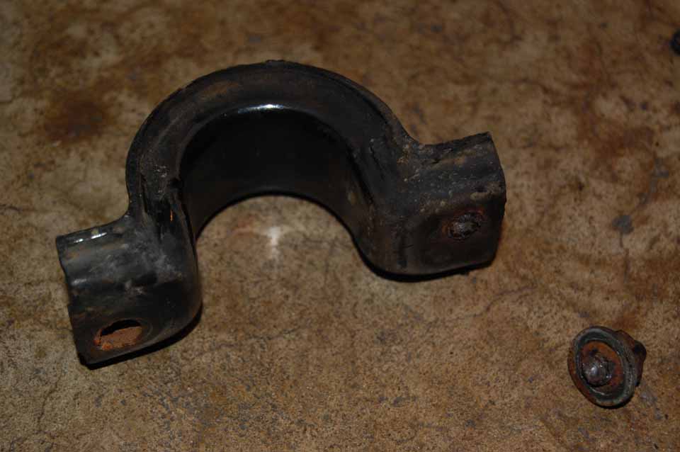

Old bushings

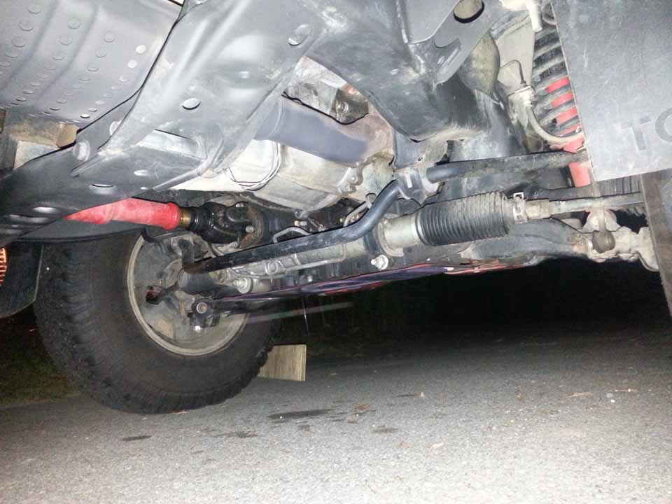

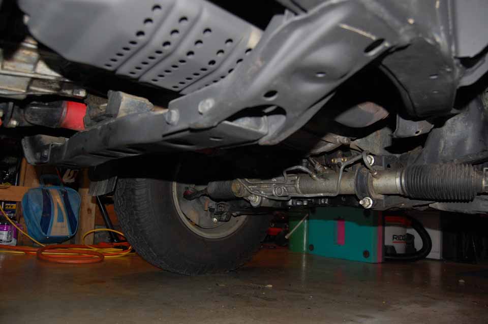

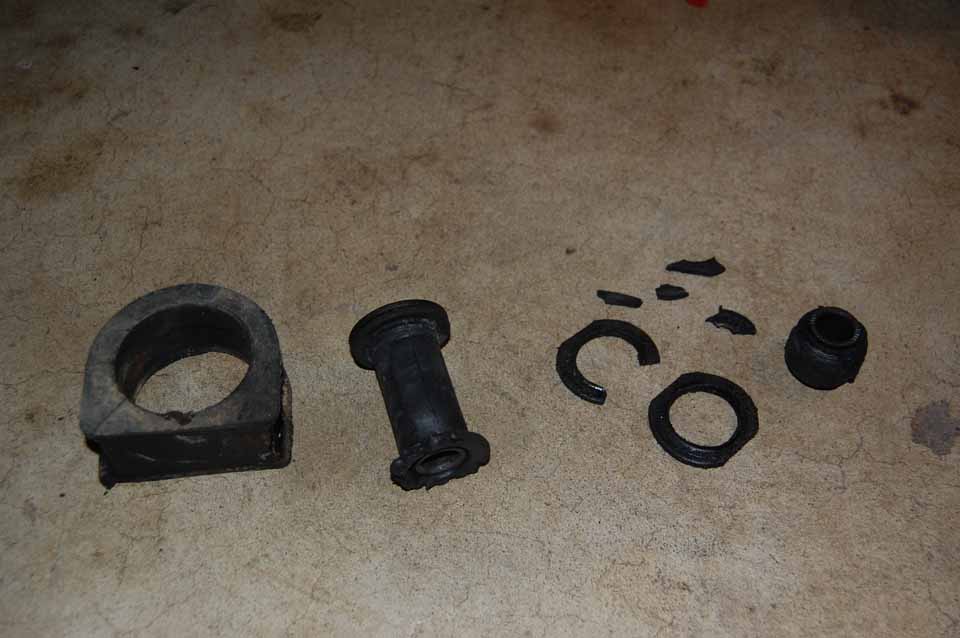

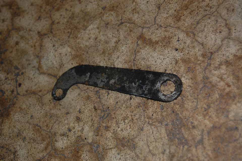

Old steering rack bushings- have been replaced with ES Poly

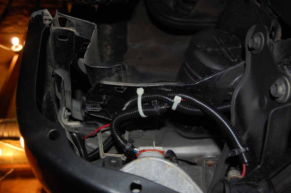

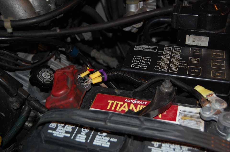

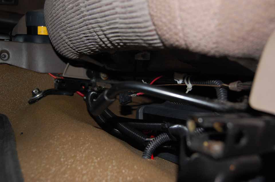

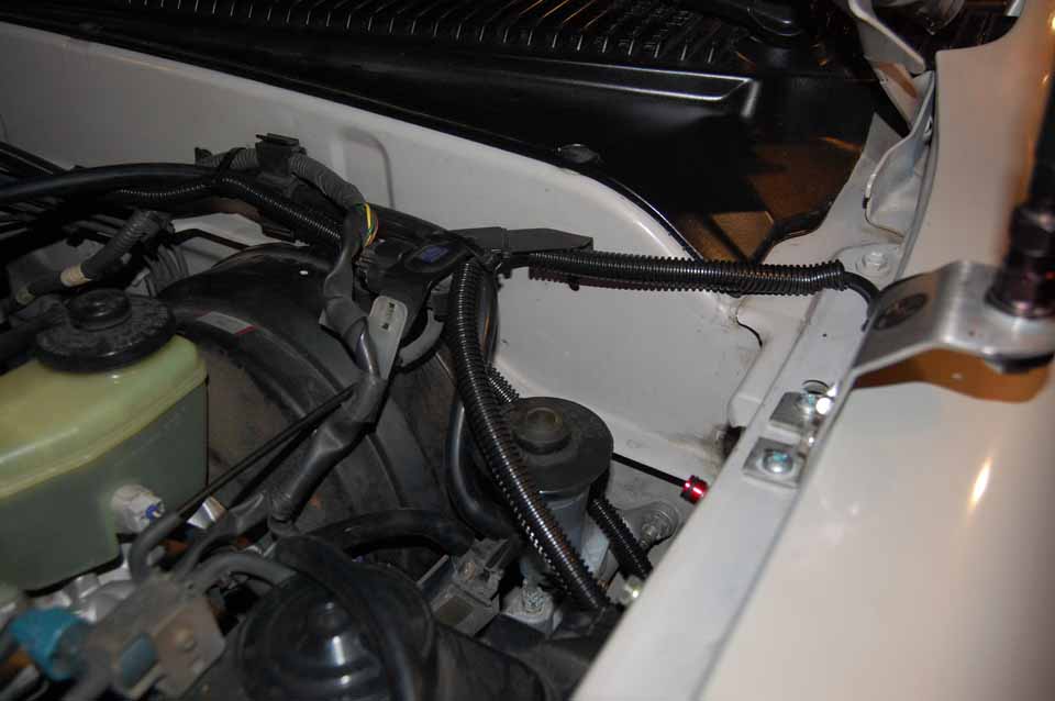

I cleaned up my wiring
Bosch Relay

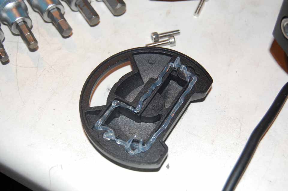

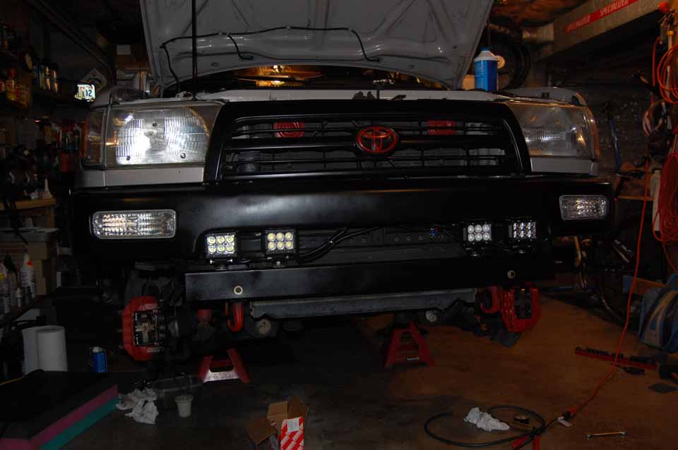

Sealing up LED lights
They were a pain to bolt up, but it was worth it! They are so bright! I also have them wired to only be on with the high beams on. I need to get a double pole-double throw switch to make a manual override for other uses.

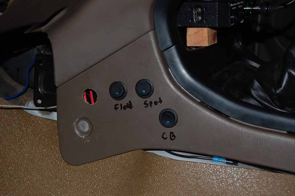

Switches

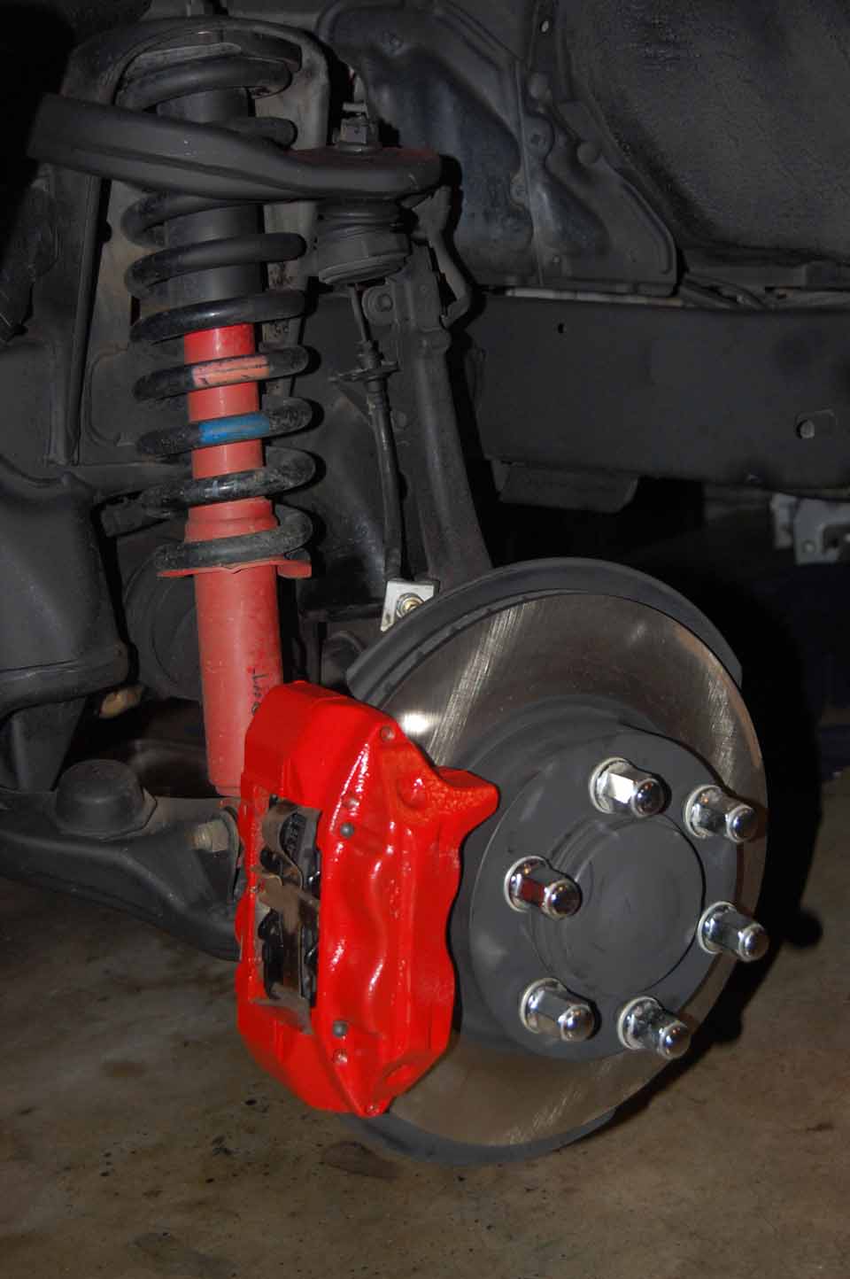

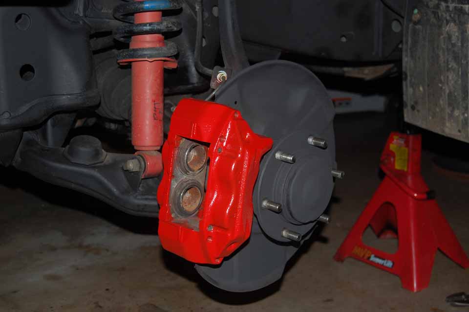

Last, but not least, I have new OEM rotors and pads. I also got a O'Reilly's rebuilt caliper for the passenger side since one of the pistons was frozen.
(painted the calipers, hubs, frame, control arms, dust shields, and rotor top hats)
I just need to bleed the brakes one more time, put the wheels on, and bed the brakes in!
