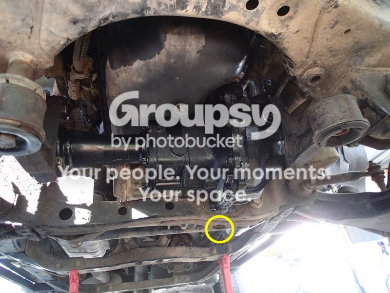

The yellow circle is the 3rd bolt you have to undo- and then lift it up and out of the hole in the cross member- if you end up needing to take the whole stupid thing out.
The actuator is the light brown dirt colored thing behind the passenger side axle tube. Easy to find because of the big round vacuum diaphragm with 'L' shaped hose barb. The vacuum lines go into a set of metal lines bolted to the top of the diff. It was bypassed with a vacuum hose. Vacuum lines for the 4wd can be found on the driver's wheel well in the engine compartment below the moo-box.

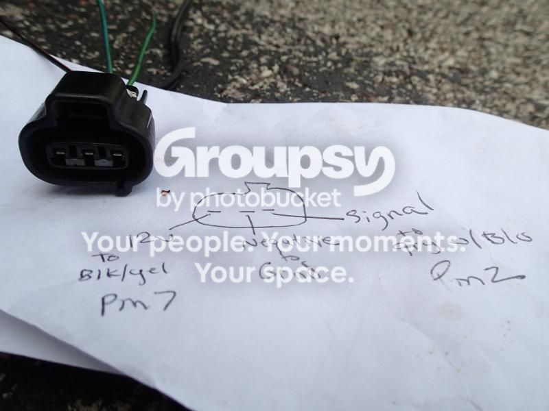

Affirmative on the speedo sensor. I've got how-to with pics on wiring up the sensor if you want them. It's not hard at all. It is a spendy little bit (along with those other bits) so nab it when/if you get the spindles and cvs out of a 96+ taco. Too bad we can't use the older style hubs, those seem more readily available.
