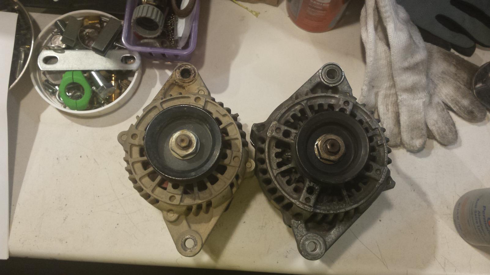

I finally got my alternator switched out. The left is the old parts store reman 70 amp and the right is my freshly rebuilt Denso 80 amp from a 99-02 4Runner. So far so good. It might need a bearing or two though. The voltage at idle is a perfect 14.2V.

80amp is better than 60amp like my oe is! May have to go that route if I don't go for something.....more. It's still chugging away, though.

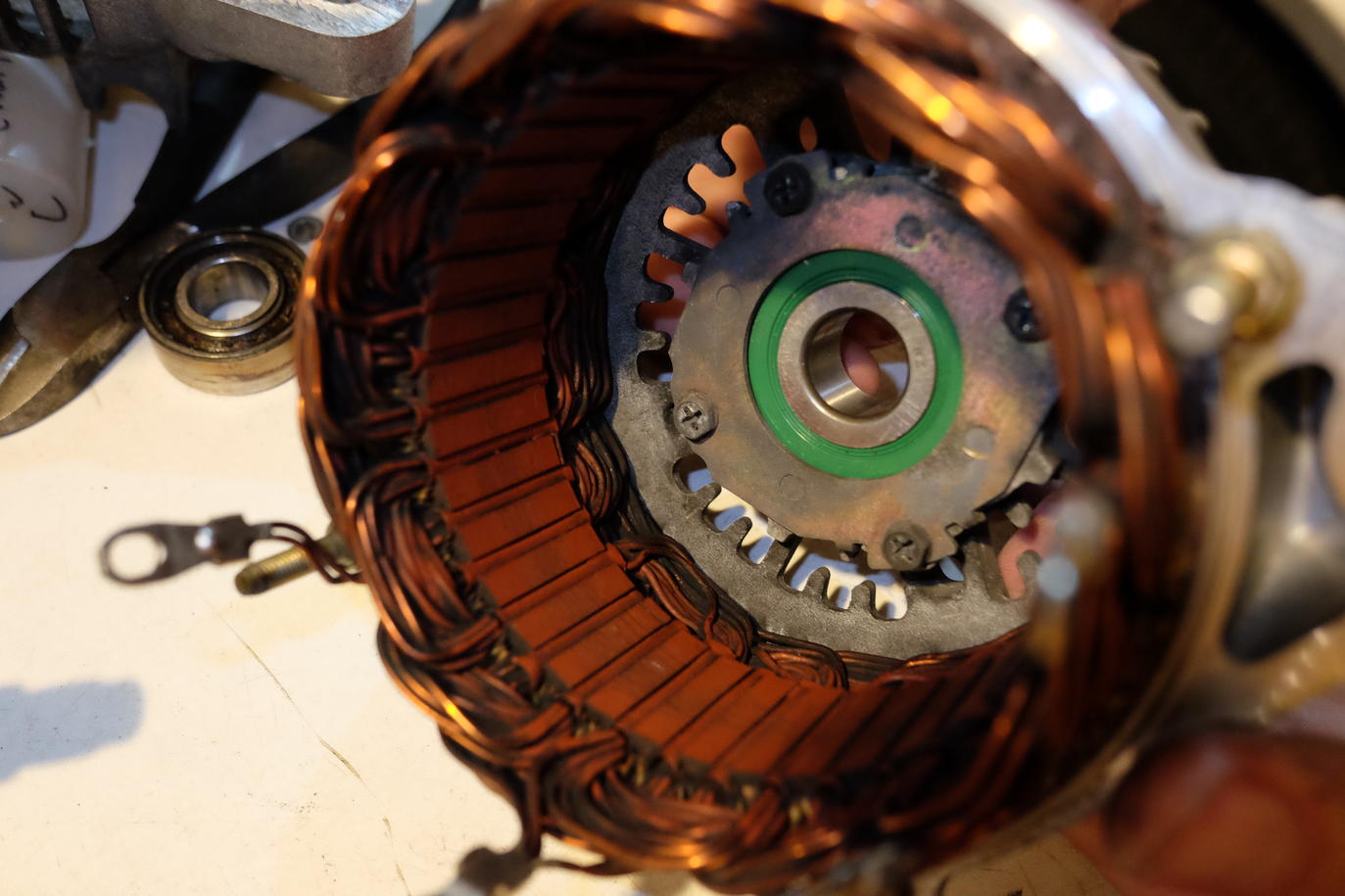

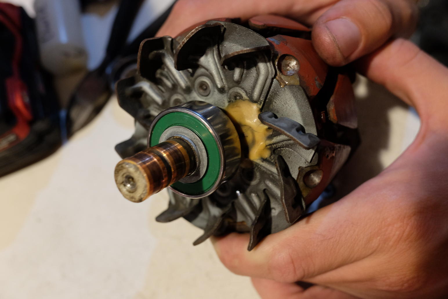

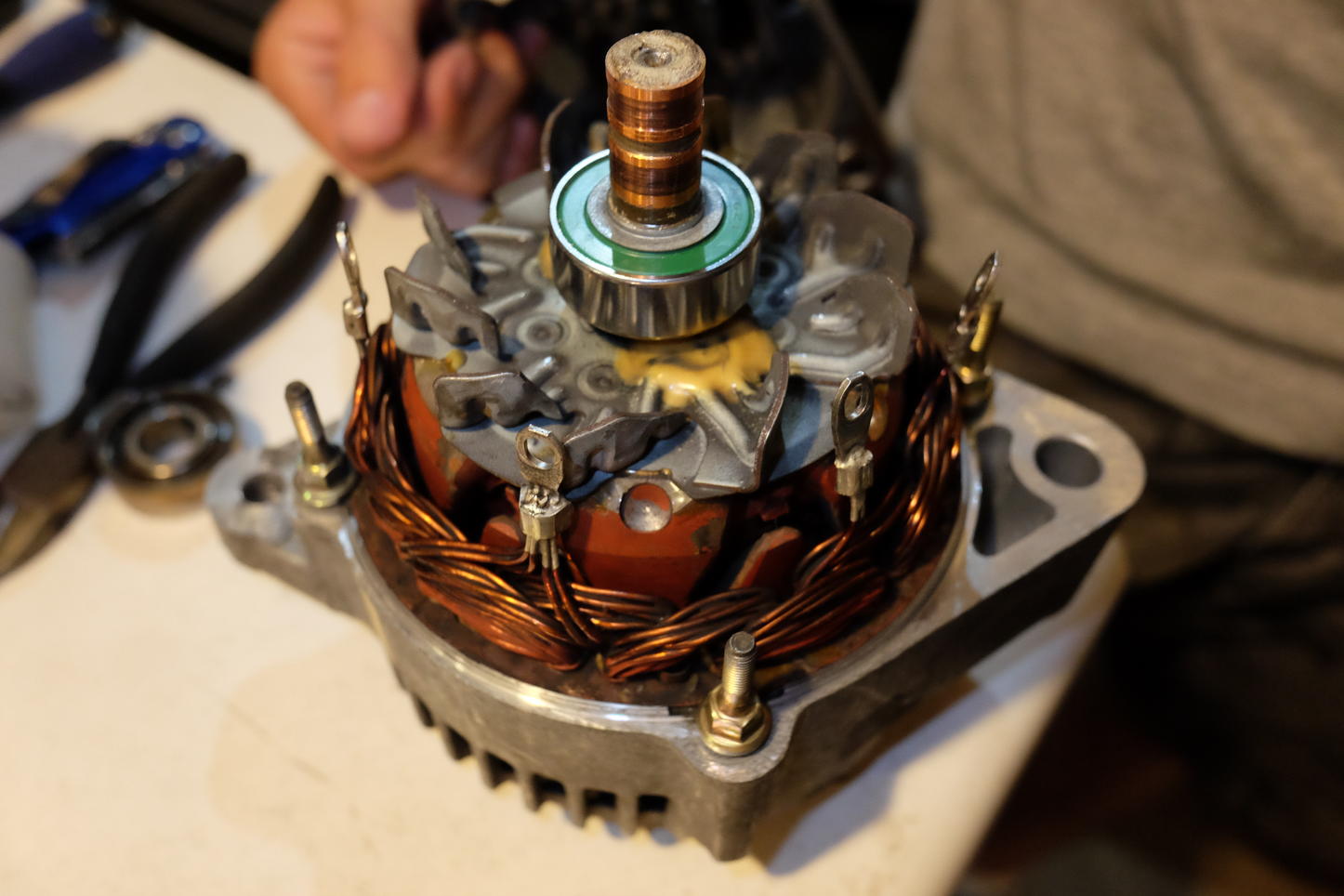

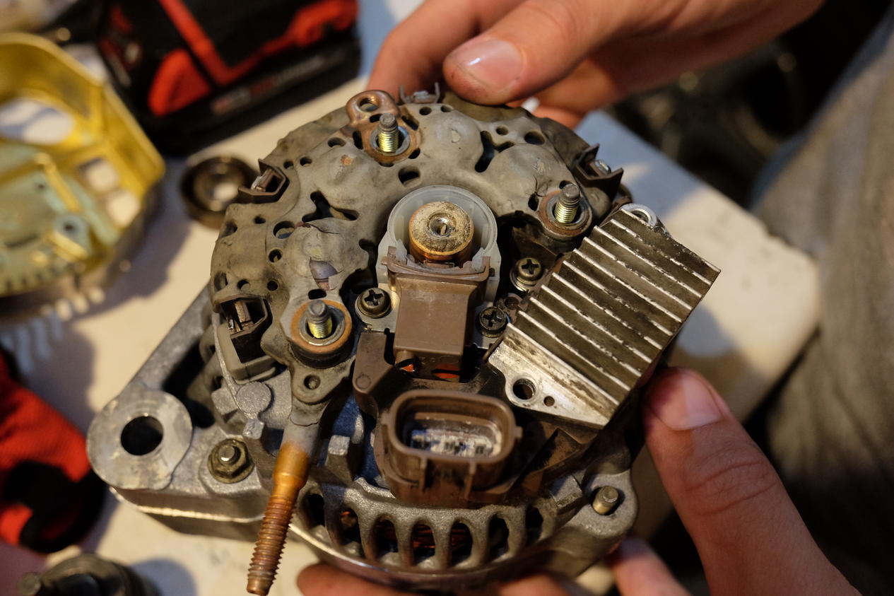

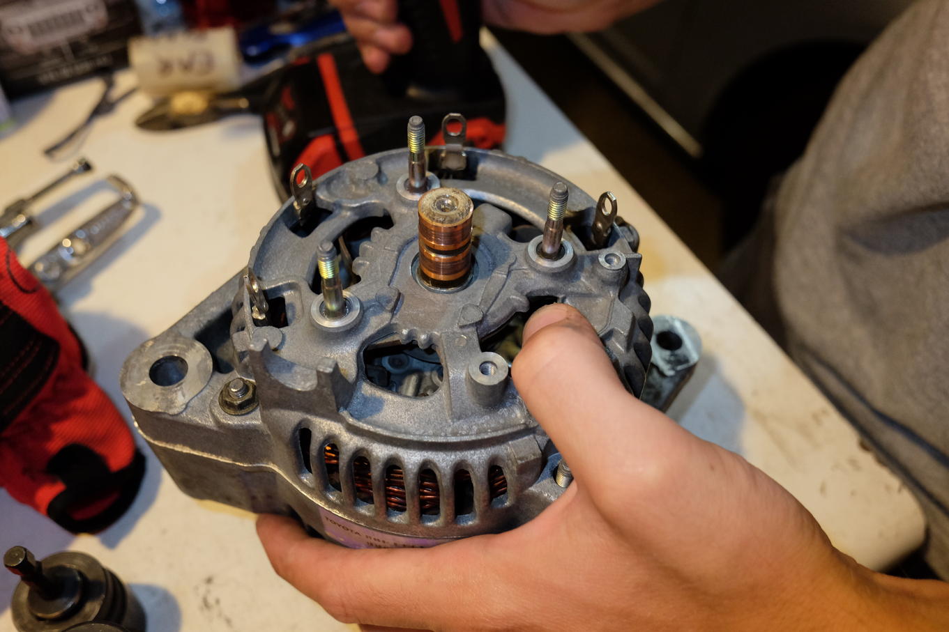

Alternator Rebuild- brushes and bearings
I got it finished! Will be installing it tomorrow morning. It's the smoothest alternator I have ever spun and it better sound good or I'll be mad lol

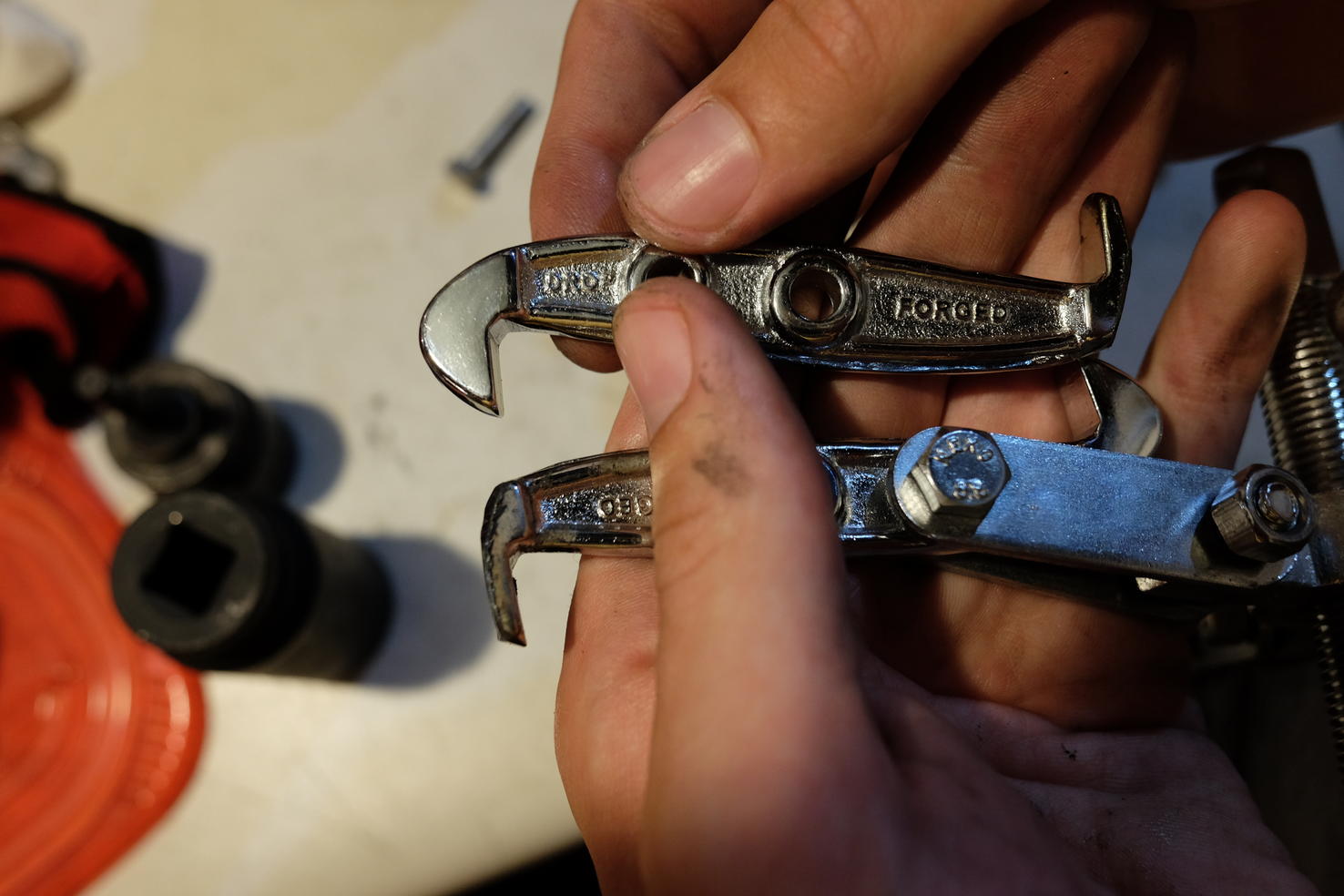

I bought a cheapie harbor fright puller and ground it down so it would fit between the bearing and the fan to pull it off
New one
Other new bearing
Alternators are cool...
