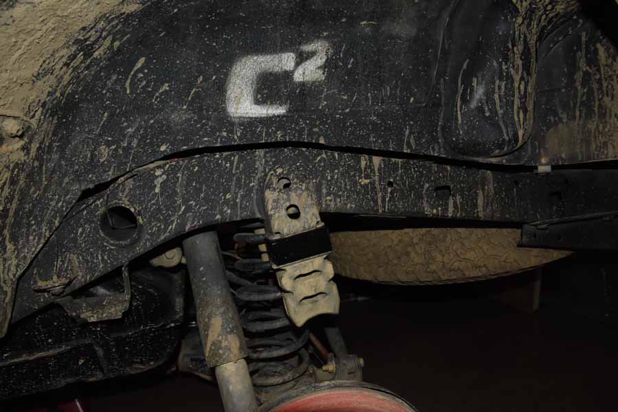

I made a bump stop extension for my driver's side rear bump stop so my driveshaft doesn't eat my gas tank skid so bad. It barely rubs now...

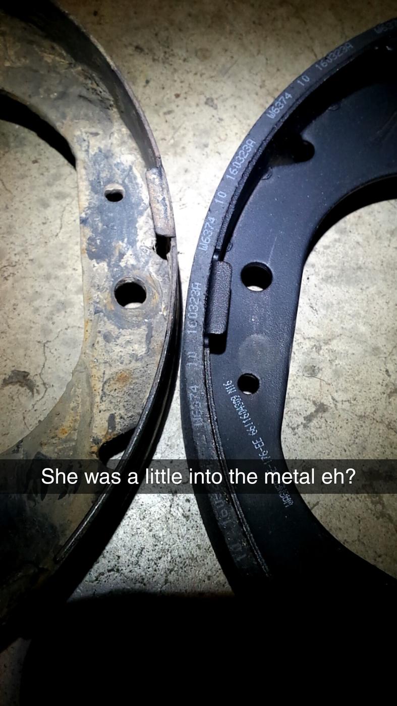

I replaced my brake shoes a while back. Now it stops good lol

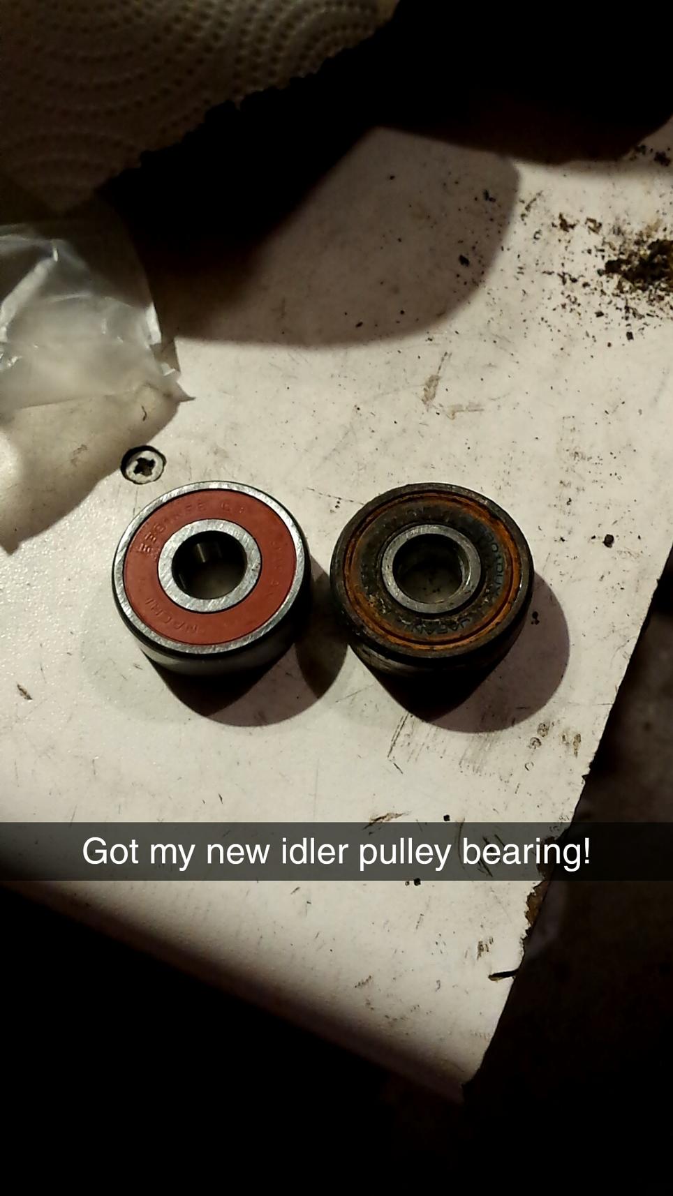

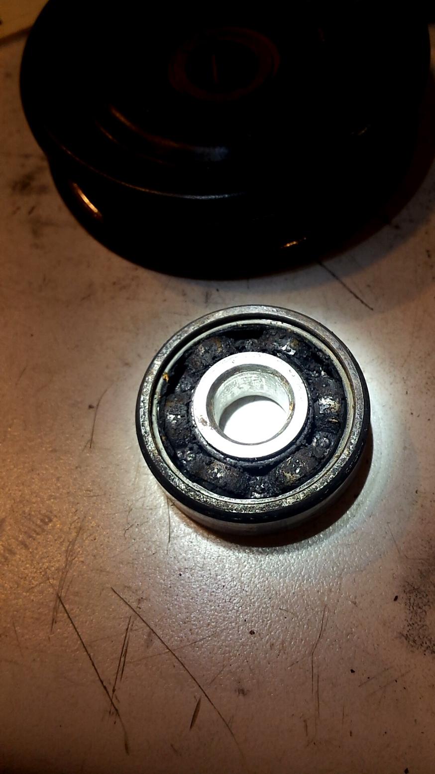

Replaced my idler pulley bearing and AC belt yesterday
Old one was a little gritty :laugh:

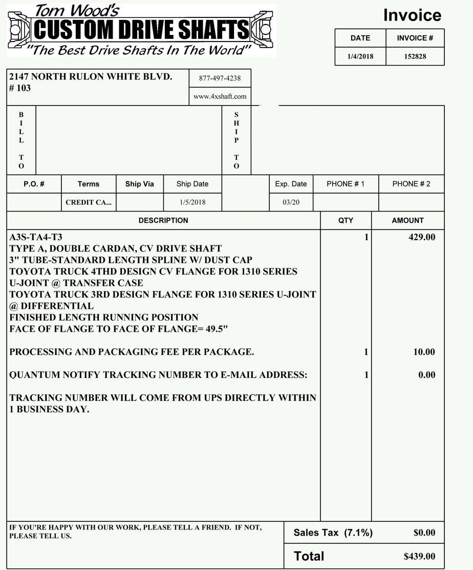

Here is my Tom Woods invoice with the flange styles for reference
Nice! If mine ever starts causing issues I will be ordering one of these too.

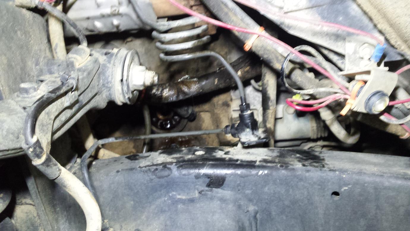

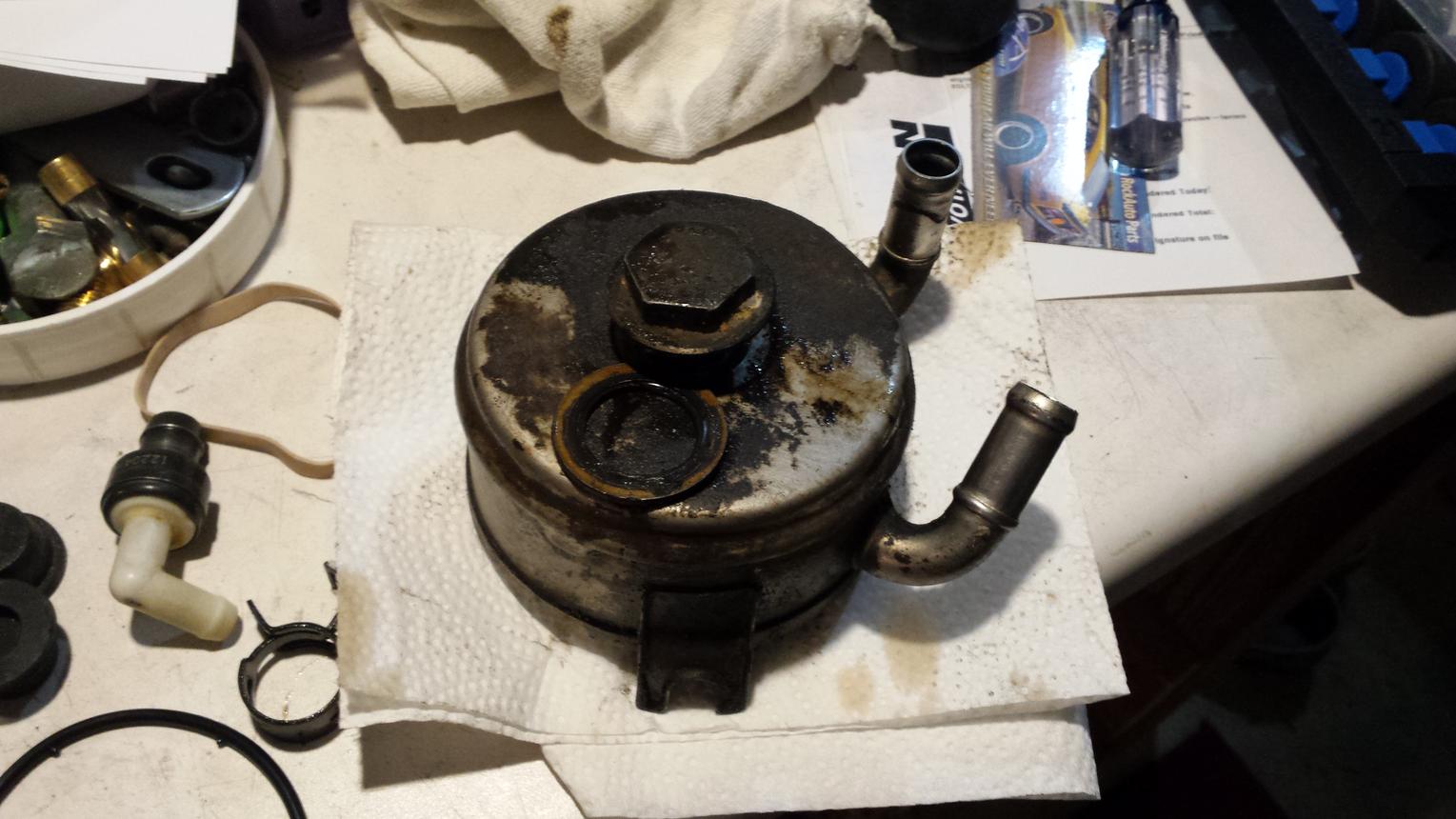

I finally got around to doing the oil cooler seals. The hardest part is getting pliers in there to squeeze the hose clamps. Also replaced the short coolant hose.
