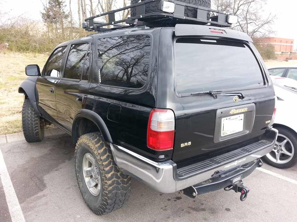

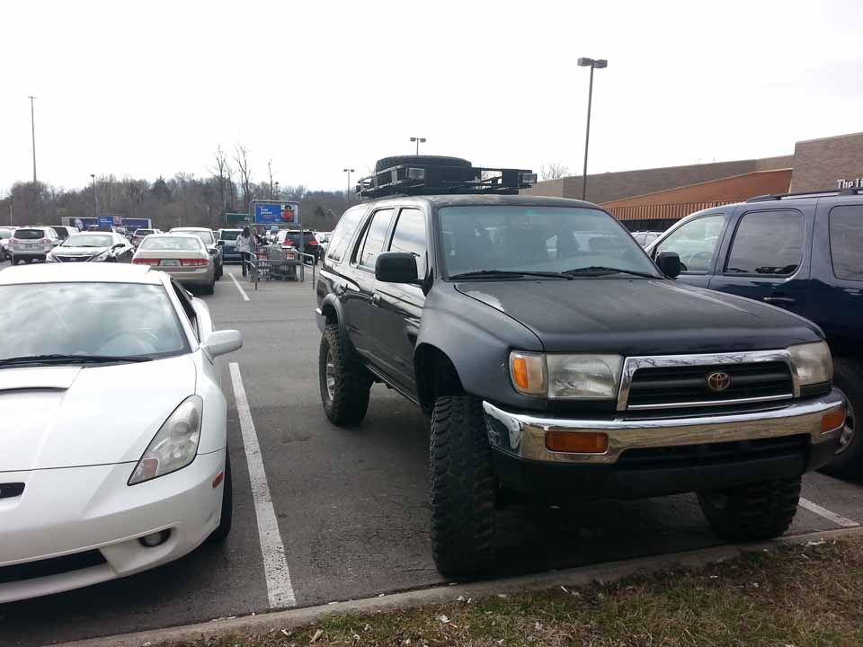

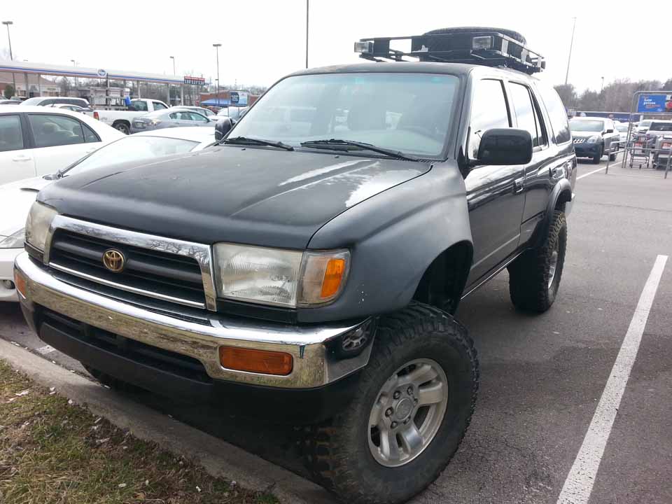

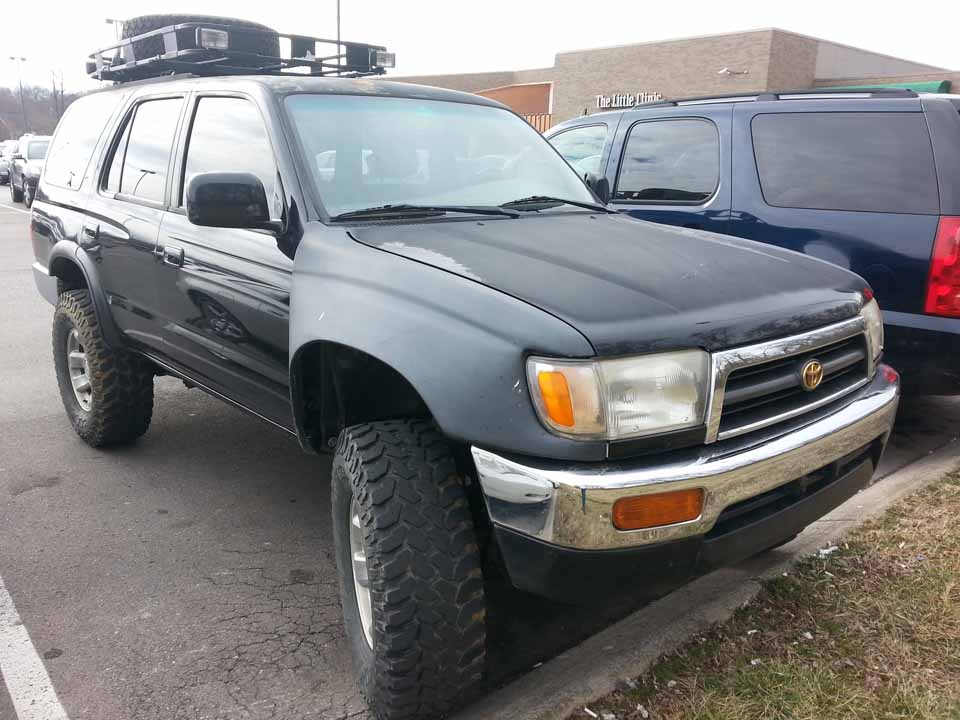

Saw a cool 4Runner today! It had a Toyotech lift, some kind of high clearance fenders, and 33's. It's also a five speed! Talked with him for a few minutes about it and hopefully he will join on here.

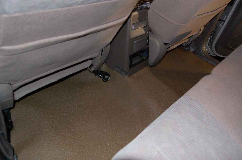

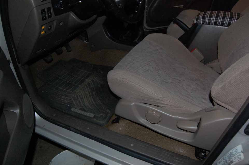

Cleaned Seat Belts/ LBJs/ Sway Bars/ Vinyl Flooring
I cleaned the seatbelts with Oxiclean again. They look brand new! This is from the second rinse- first soak in Oxiclean and first rinse were worse.

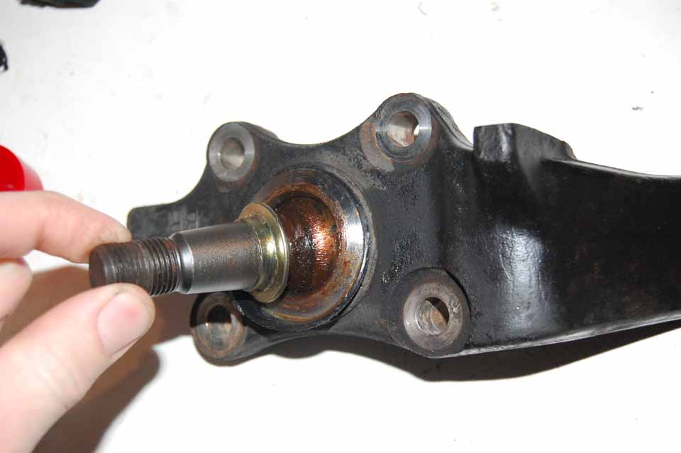

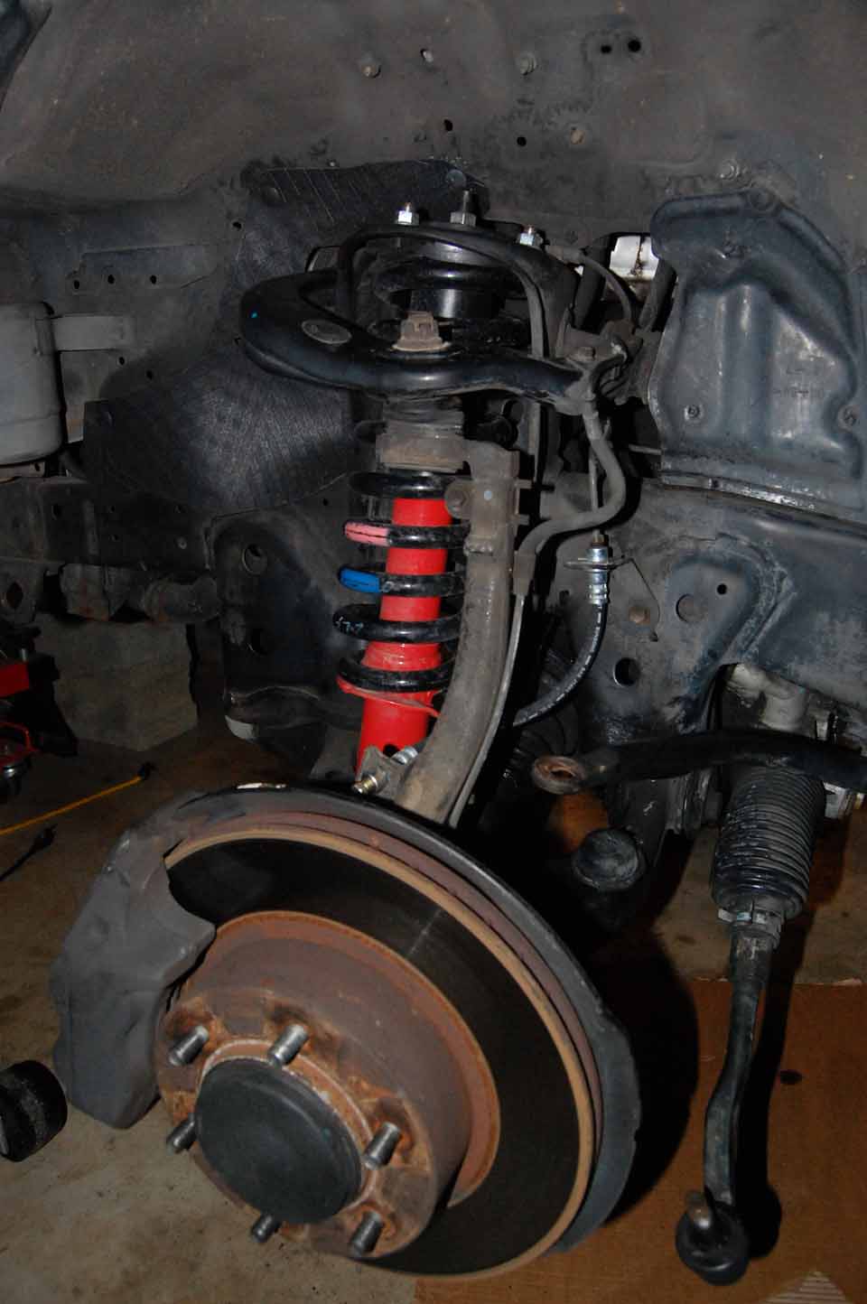

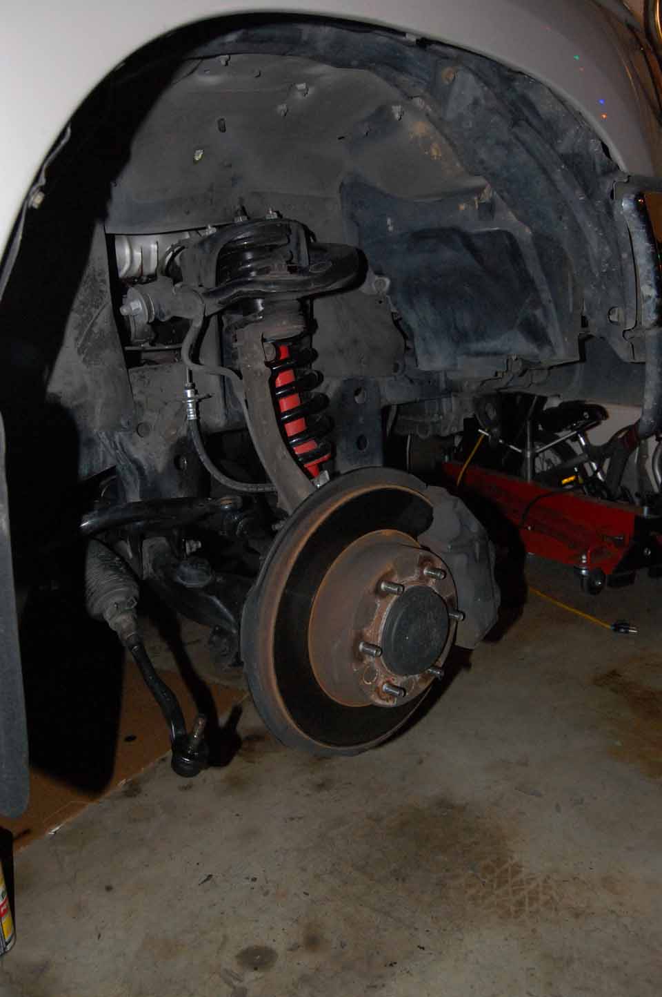

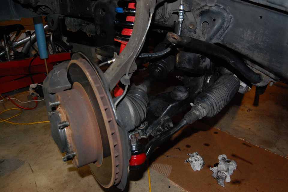

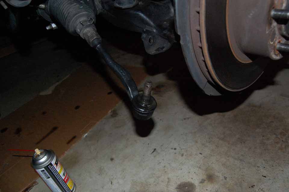

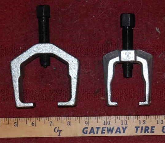

Suspension disassembled... Are the TREs supposed to droop that much? There is no play in them at all. I'm getting new boots for the ends because they are ripped. Also, it's amazing what the right tool will do! I tried breaking the TRE-LBJ joint loose for at least an hour and a half with three different pullers. We then bought a tie rod puller and each side took thirty seconds haha.

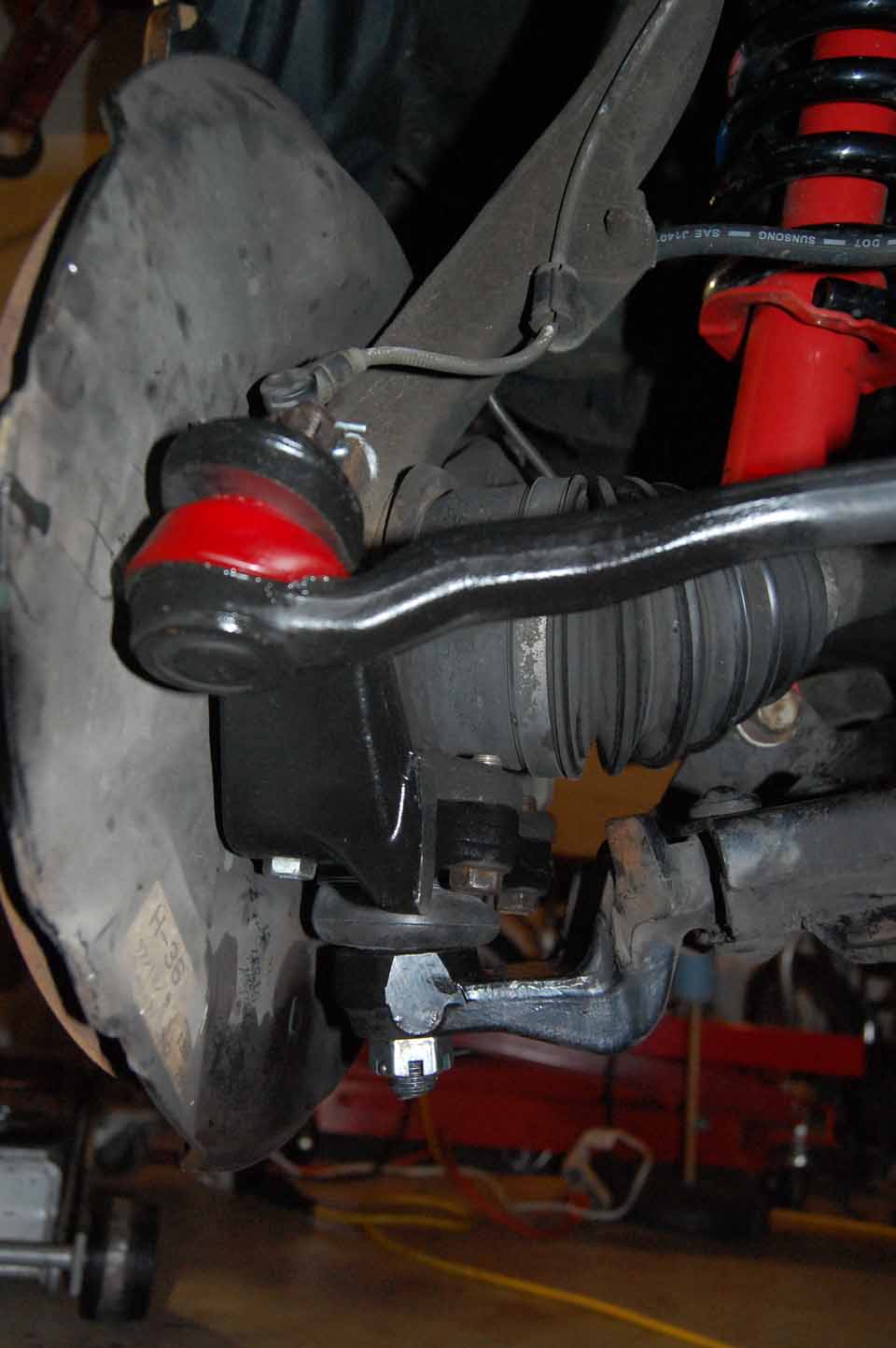

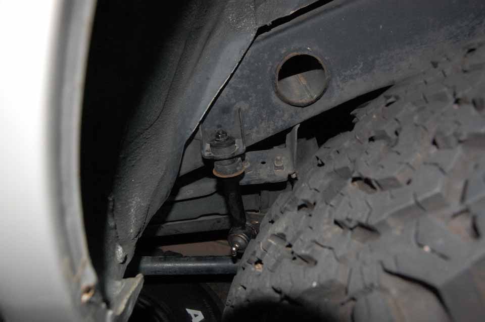

I extended my rear sway bar end links with some rubber bushings. I also removed the front ones to see what it is like. One of the front ones came undone and messed up the threads some time back. Don't know what I'll do about it.

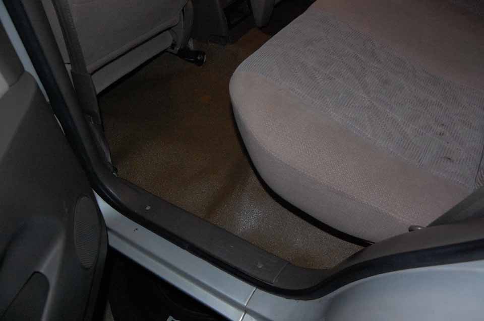

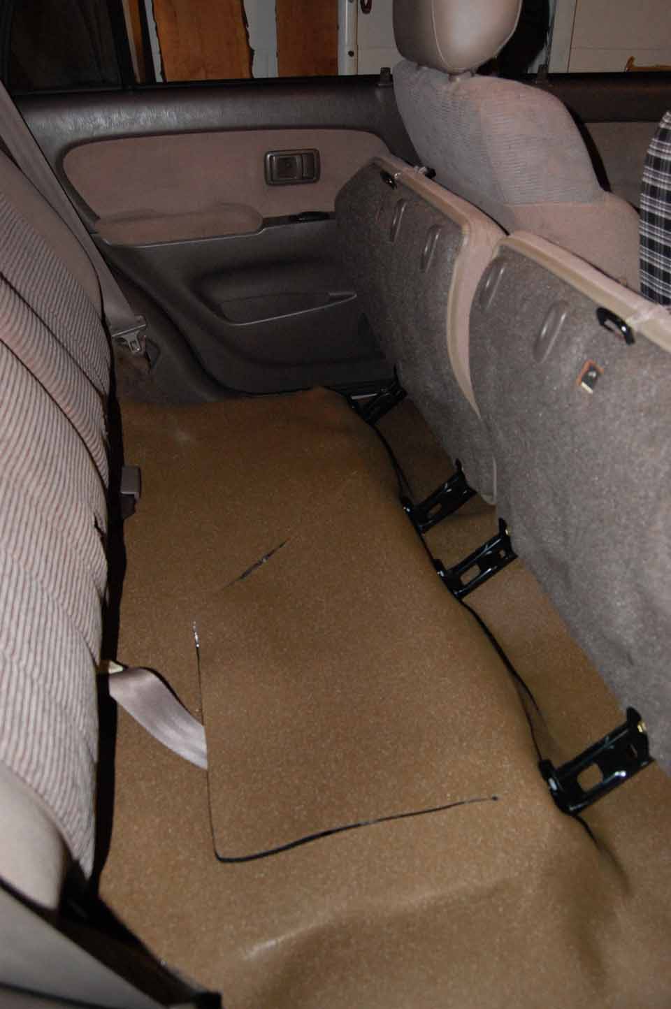

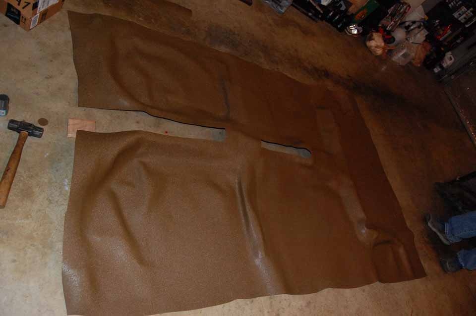

Here is a sneak peak of the vinyl. We're still putting it in. We've mad two bad cuts though :(

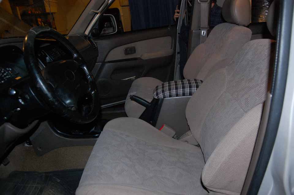

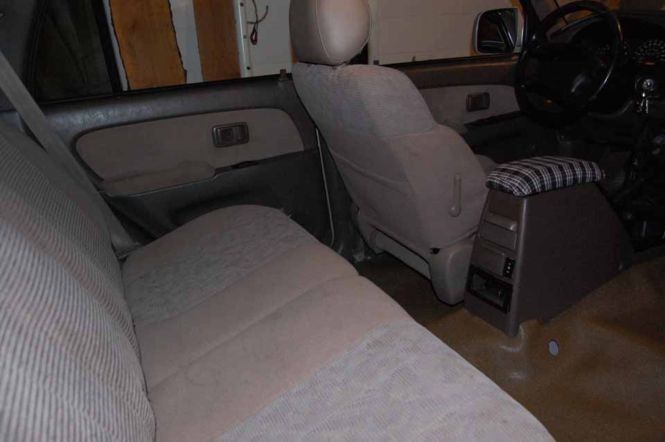

Interior is done!!!

Nice work on the 4runner. How much sound deadening did you use for your interior?
Thanks! I used 3 1/2 rolls of peel n seal (approx 40-45 sq. ft.) plus the large sheets of padding that came with the vinyl. I wont get to hear how it sounds until this snowmageddon thing is over (can't pick up LBJs from dealer). Three rolls would do the entire passenger area, but I bought four and decided to do the cargo area since I had it.
I like the floor. You sure do work fast. My son finally got air bags. 206k mi one owner!
The floor was such a pain! I like it though. No school for a week helps with getting stuff done :zoom: I'm super excited to be able to drive it after almost two weeks! :whoo:

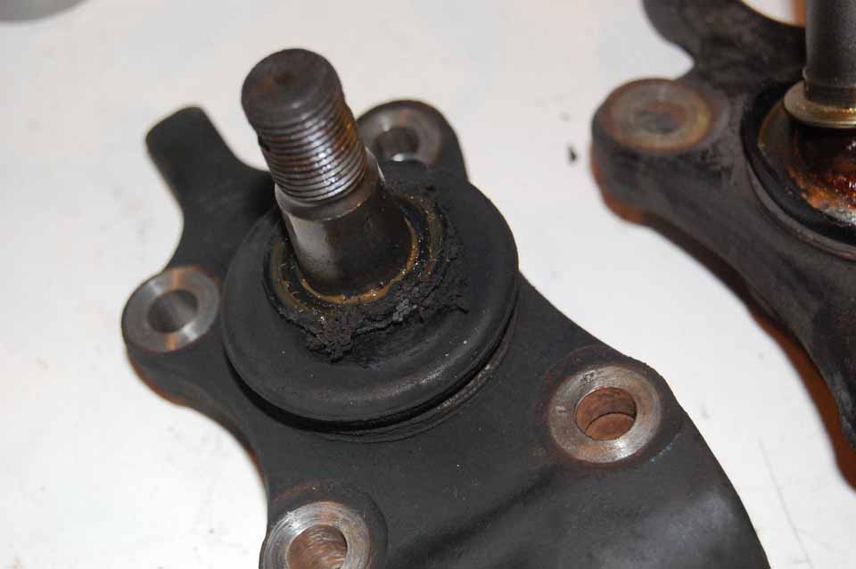

LBJs/ TRE Boots
Finished up the cotter pins this morning. She's all ready to go!

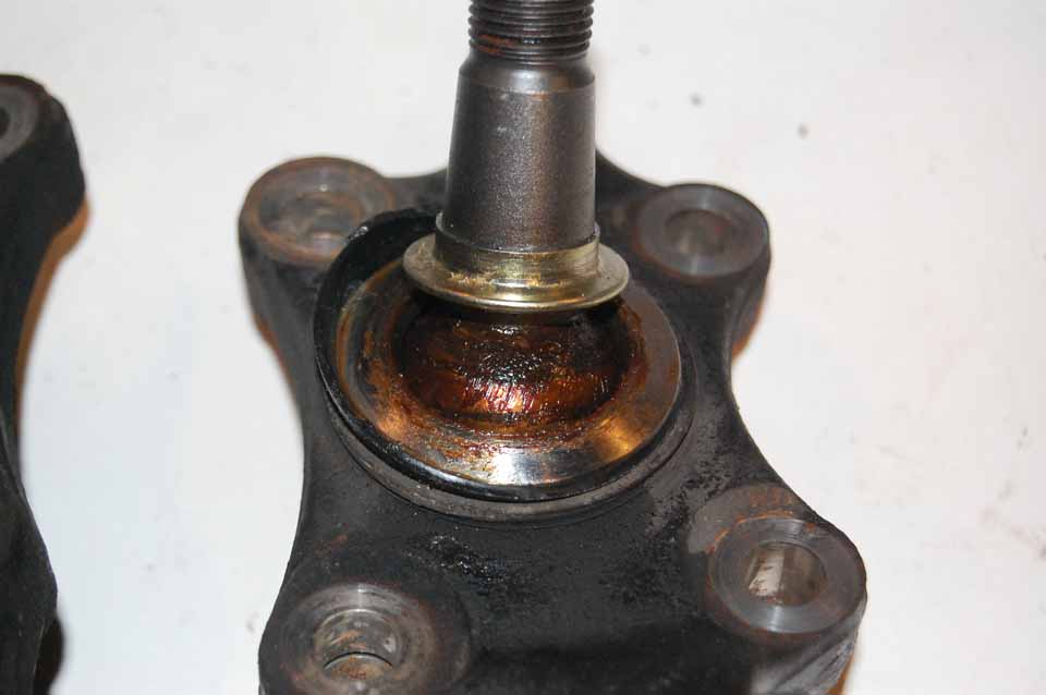

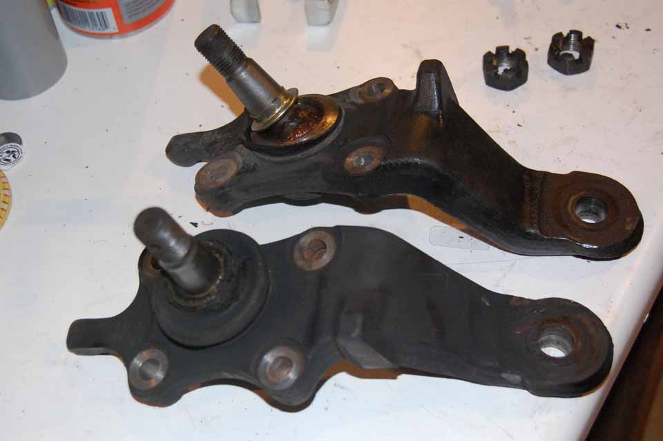

The old ones. They are really loose and have a lot of up and down movement. As far as I know, they have 250,xxx miles on them. (I cut off the boot on this one to see what they are like)

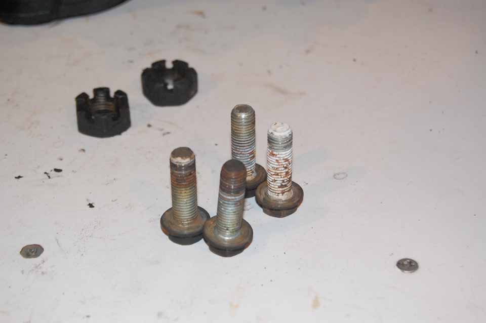

The worst of the bolts. My dad's parts guy only got us 4 bolts, so I put 2 new ones on each side and reused the other two.

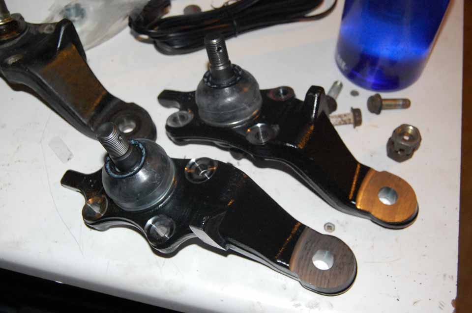

Pitman Arm Puller for LBJs and Tire Rod Puller for TREs
New!

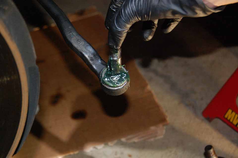

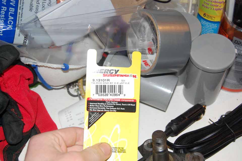

LBJs/ TRE Boots- cont.

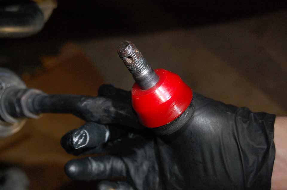

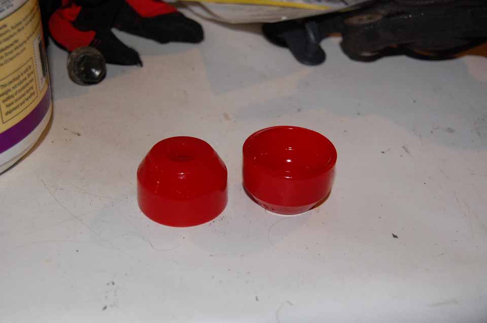

Here are the new boots I put on. They are Energy Suspension 9.13101R

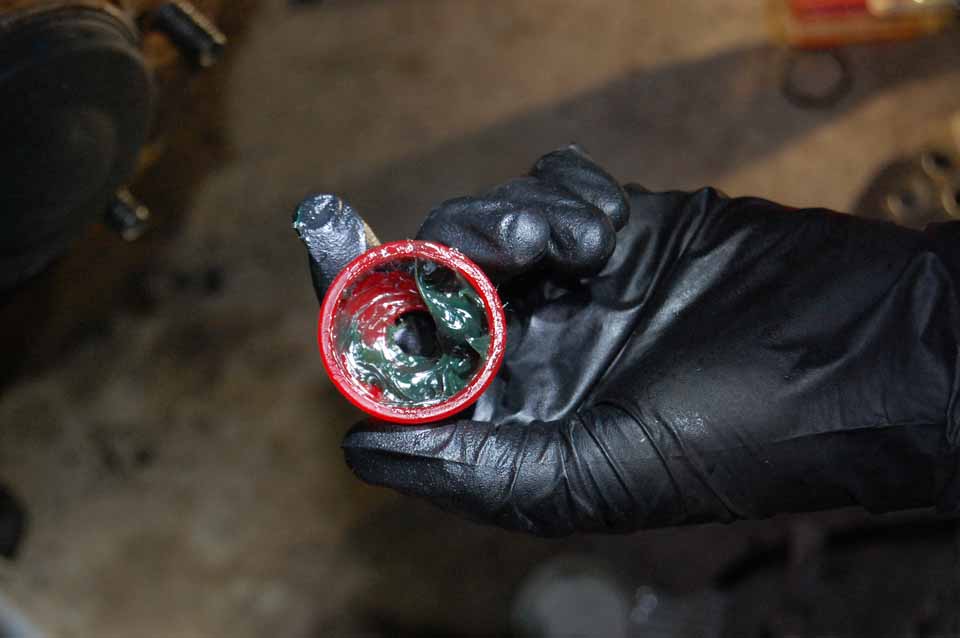

Smashed grease into the ball joint
Put plenty of grease in the dust cap
Installed. They squished down really good and grease came out. I don't think much dirst will get in if any.

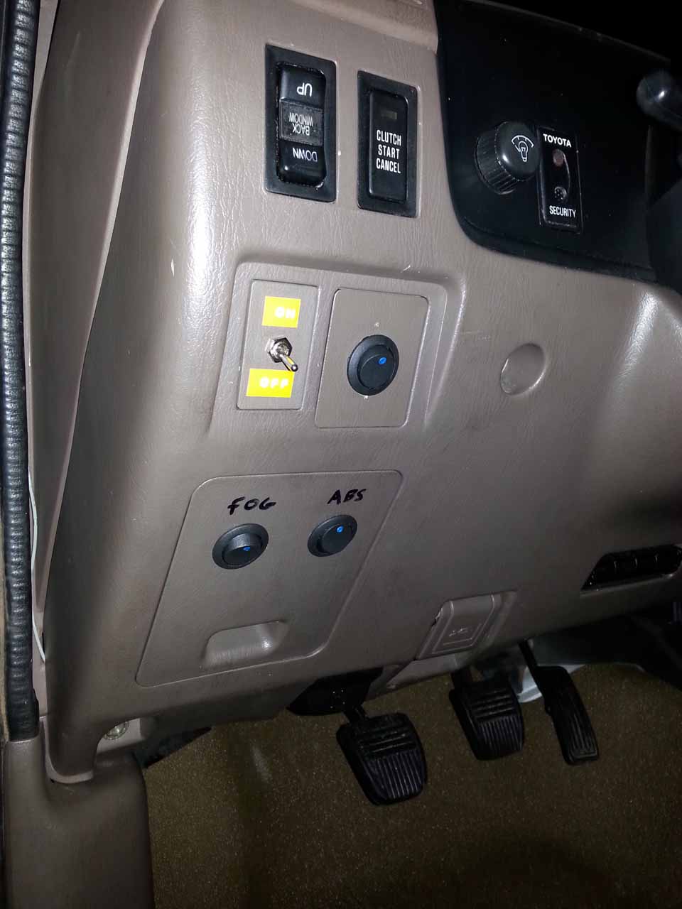

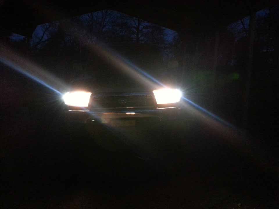

Did some wiring today. I got my ABS switch routed into the cab instead of in the engine bay. The switch labeled "Fog" is for my switchback turn signals that are currently in a UPS truck somewhere!

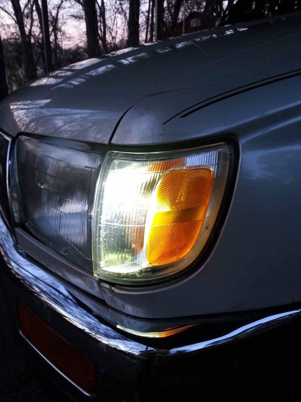

I also rigged up some LEDs for the marker lights.
With low beams on
How I know I've been parking here :violin:
