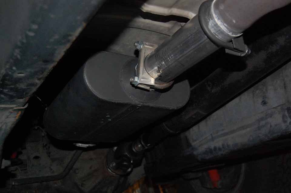

My Thrush Welded muffler came in. It looks to be great quality- especially for a $30 Chinese muffler. The welds look much cleaner than the Walker. I just need to buy one more clamp and I'll put it in. I'm going to paint it black along with the rest of the tailpipe.

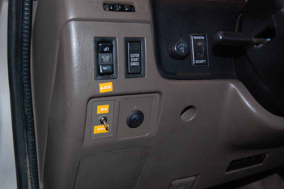

My switches and in-line fuse holders came in. I went ahead and wired up the in-line fuse to the battery. I also pre-installed the switch in the dash. I used another switch to put an interrupter for the door dinger on the driver's door so I can turn it off when the key is in and I don't want it to ding.

Me and my dad got the Thrush clamped in! It's a lot quieter than a Flowmaster 40 (and straight piped)- that's a good thing. It sounds great! Pictures and a video will come shortly.

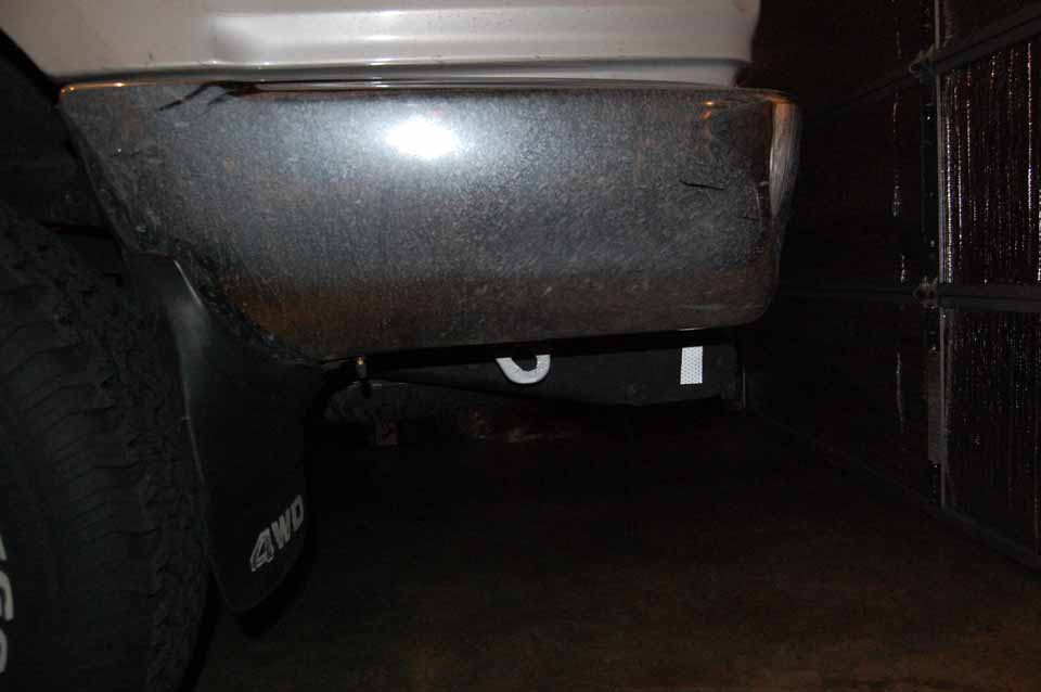

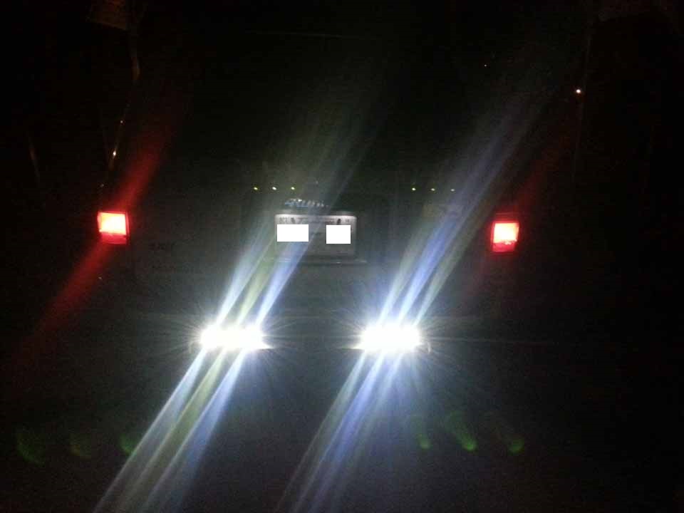

LED Reverse Lights

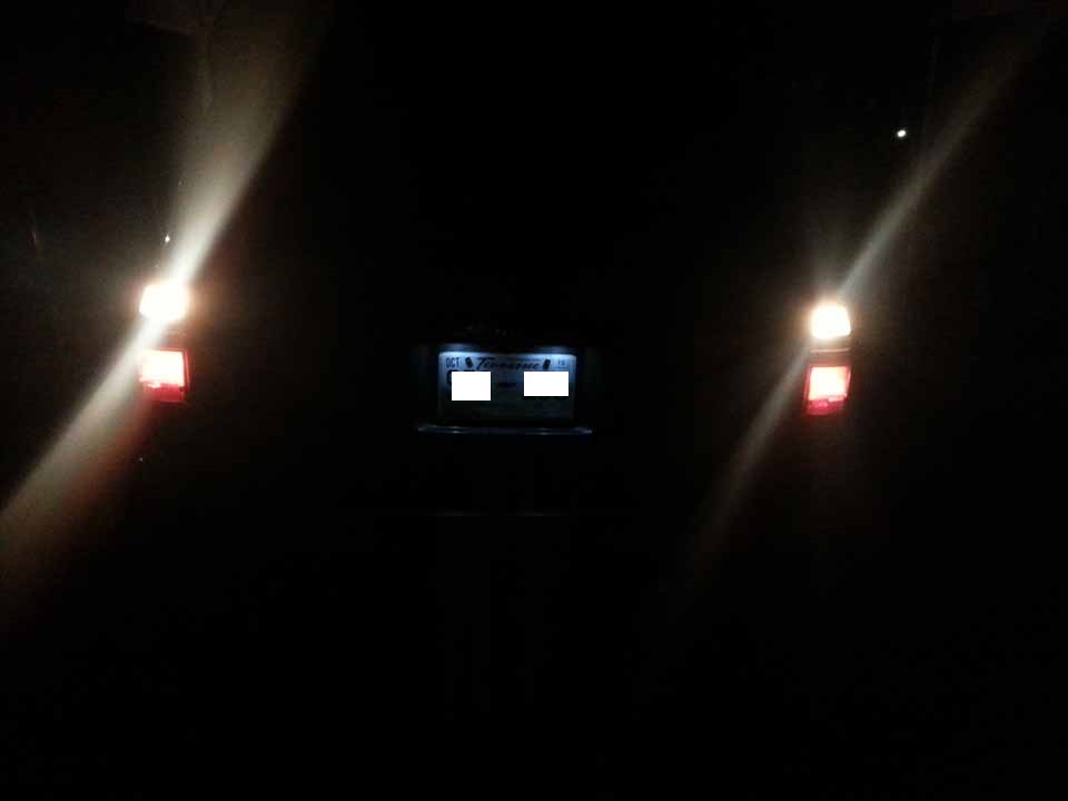

My LEDs came today! I wired them in and they are awesome! I'll let the pics do the talking
Stock reverse lights
LEDs only
Both

I actually just ordered some AUX backup lights, how did you wire them? Do you have it so when you put it in reverse they turn on? Or is it just a switch?
I have a positive wire running from the battery (through an in-line fuse) to a switch in the cab. From there, the wire goes through a drain hole in the floor and it's attached to the frame all the way back to the hitch area. (When I get my vinyl floor kit, I will be running the wire inside most of the way instead of under the truck the whole time.) I have the 6 positive wires soldered to the lead wire. For the ground, I soldered the six negative wires together and it goes to a bolt. I made two brackets for the lights- I'm planning on taking pictures tomorrow.

Thrush Welded/ LED Reverse Lights
Thrush Welded!

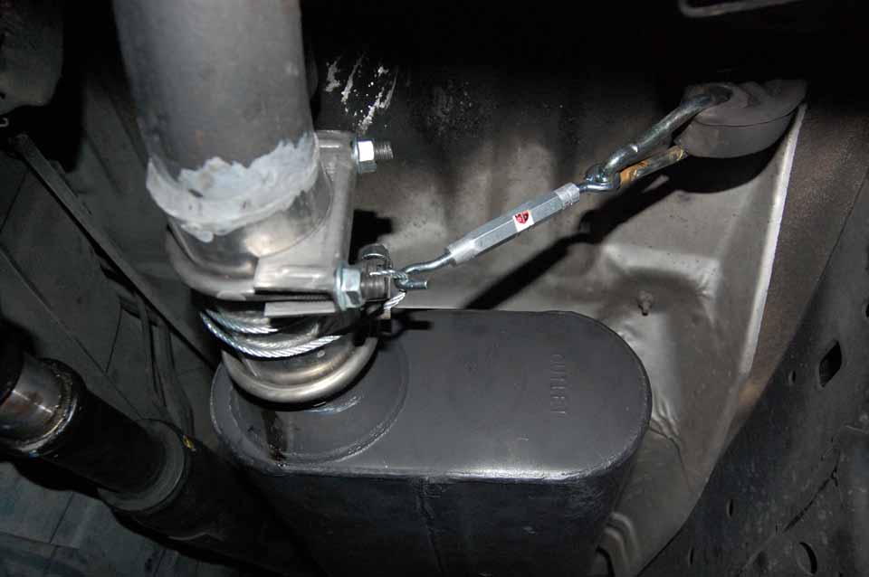

Our Cradle Hanger- Wire rope strung between two snap links put into the rubber isolators on each side. The turnbuckle is for adjustment. Before, I had bailing wire directly to the metal hooks on the frame. Using the rubber isolators reduced the interior drone significantly.

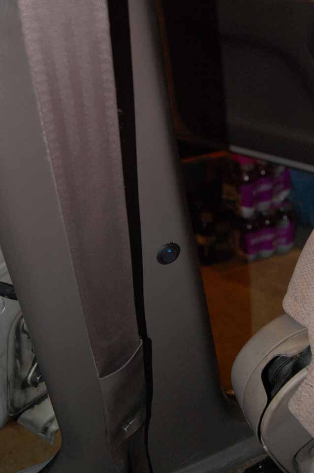

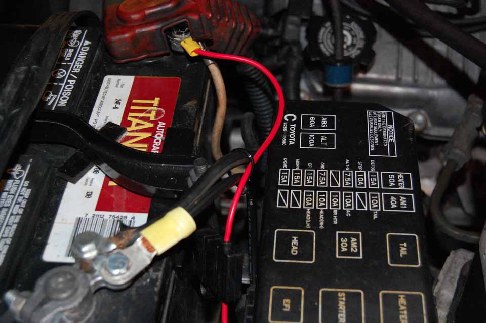

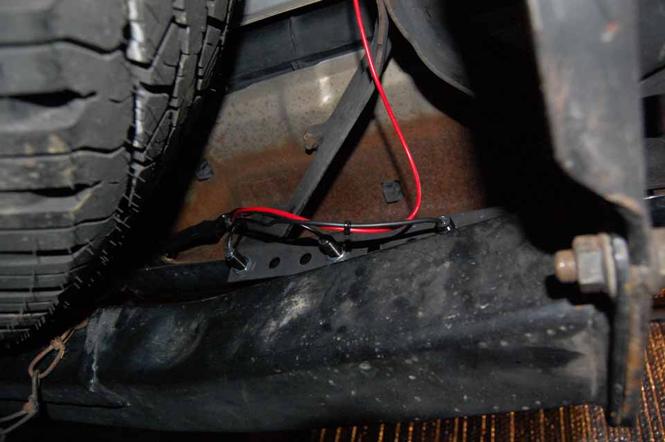

In-Line Fuse from the Battery
Switch- Blue LED is lit when in the "on" position
Back of LEDs
Light Bracket- there is another just like it on the passenger side

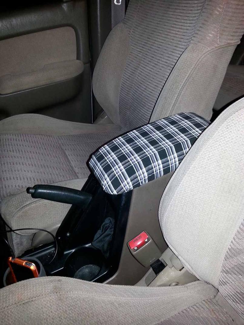

Center Console Lid
I recovered my center console lid with some foam and fabric I had laying around. I filled in the hole with a piece if cardboard and a quarter I found in the truck.

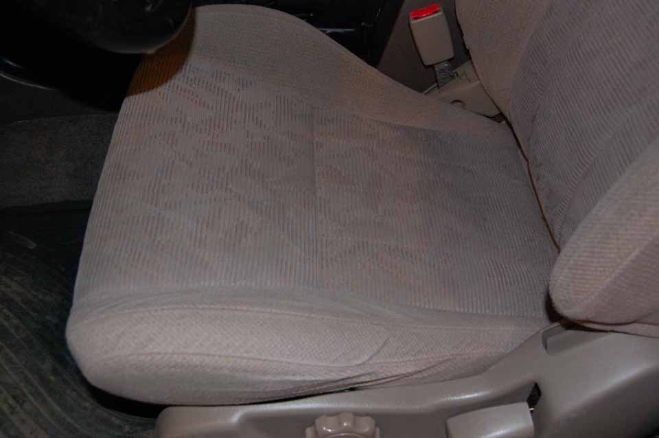

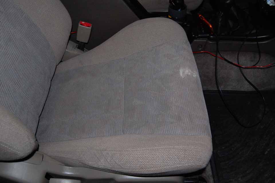

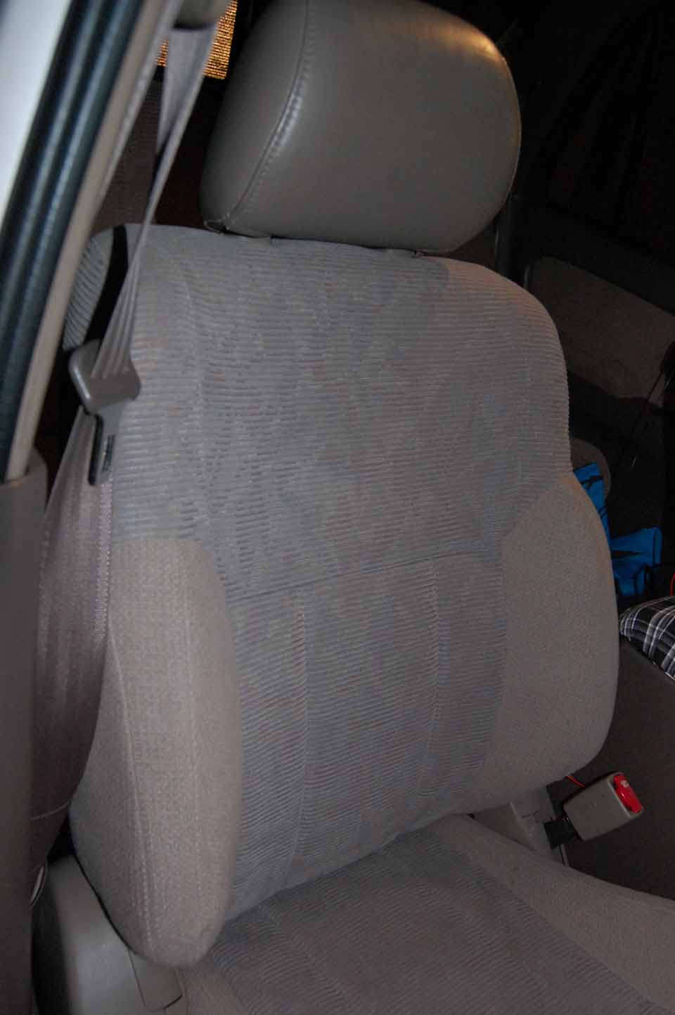

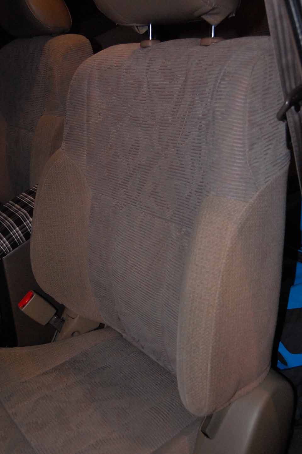

New Seats!
I got my new seats yesterday! $325 for all four seats and they are like-new (there is a stain on the passenger seat). I only have the front ones in. I'll put the new rears in when I get a vinyl floor kit.

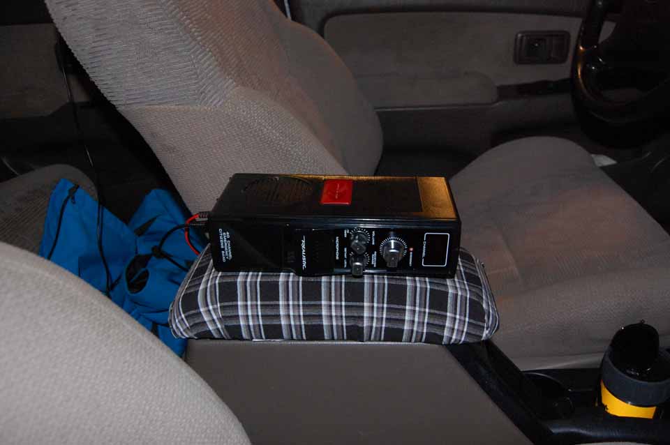

My old CB

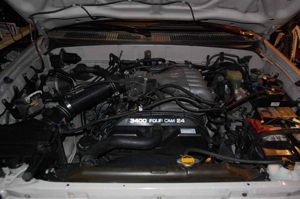

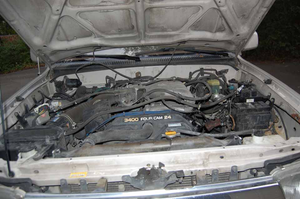

Engine Detailing/ Fender Repair/ Tire Shine
I started detailing the engine bay paint with goof off

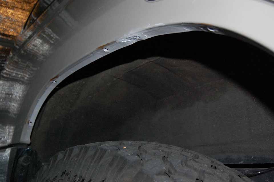

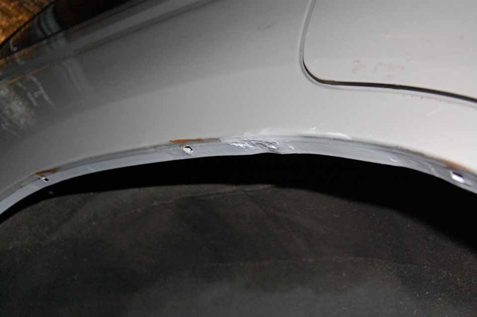

My rust repair. I wire wheeled the rust down to bare metal, cleaned it, and painted it with Ace Rust Stop paint.

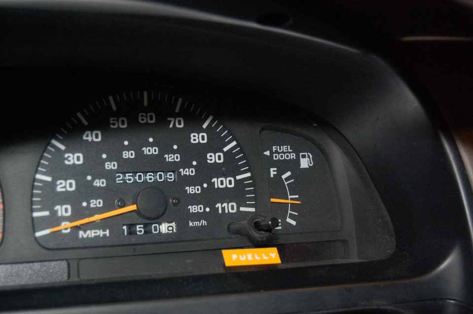

I added a label of the suggested shift points
and a reminder for me to log my mileage on fuelly.

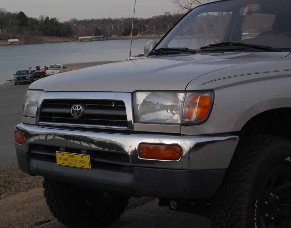

Page 10! Pictures at the Lake

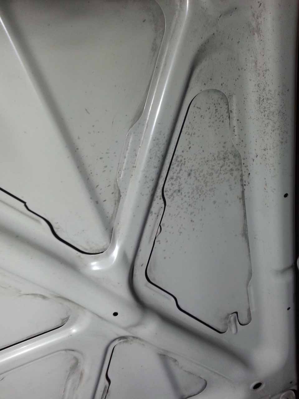

More Oil Washing- I'm surprised how much still comes off after doing it almost ten times

Engine Bay Cleaning
More Cleaning with Goof Off...
Before
Passenger half of hood has been cleaned
The final results!
Comparison of engine when I got it

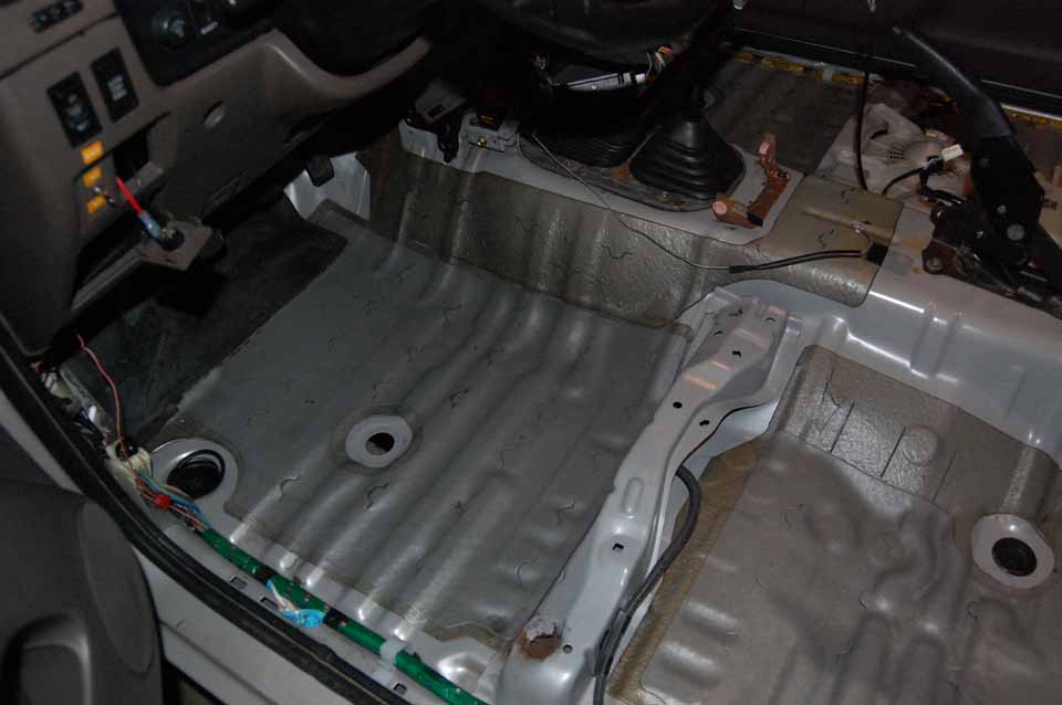

Got a few updates. I've been driving the Celica this week for two reasons:
1. I'm getting new LBJs due to them having 250,000 miles on them and they are binding up when turning the steering wheel.

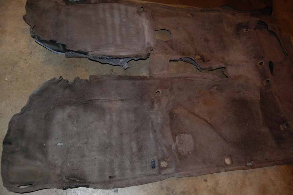

2. I have ordered a vinyl floor kit and I'm stripping out the interior to get ready for it.

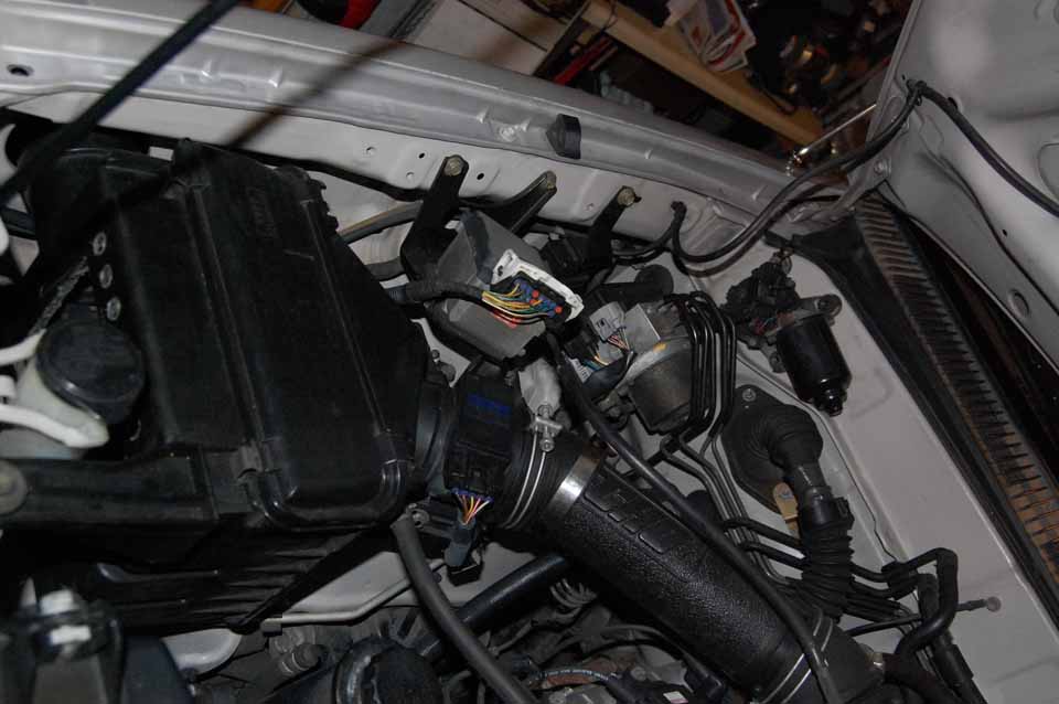

I moved the ECU for the RS3000 to behind the radio so I have more room for stuff under the driver's seat. I also moved the antenna to the a- pillar for better reception. I haven't tested it yet though.

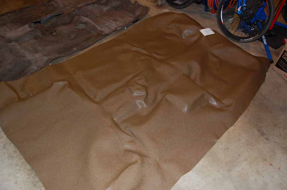

My vinyl floor came today! 100% made in Alabama. Has no bad smell and it feels really tough. The only thing I had to do is wipe off all the oil from the molding process.

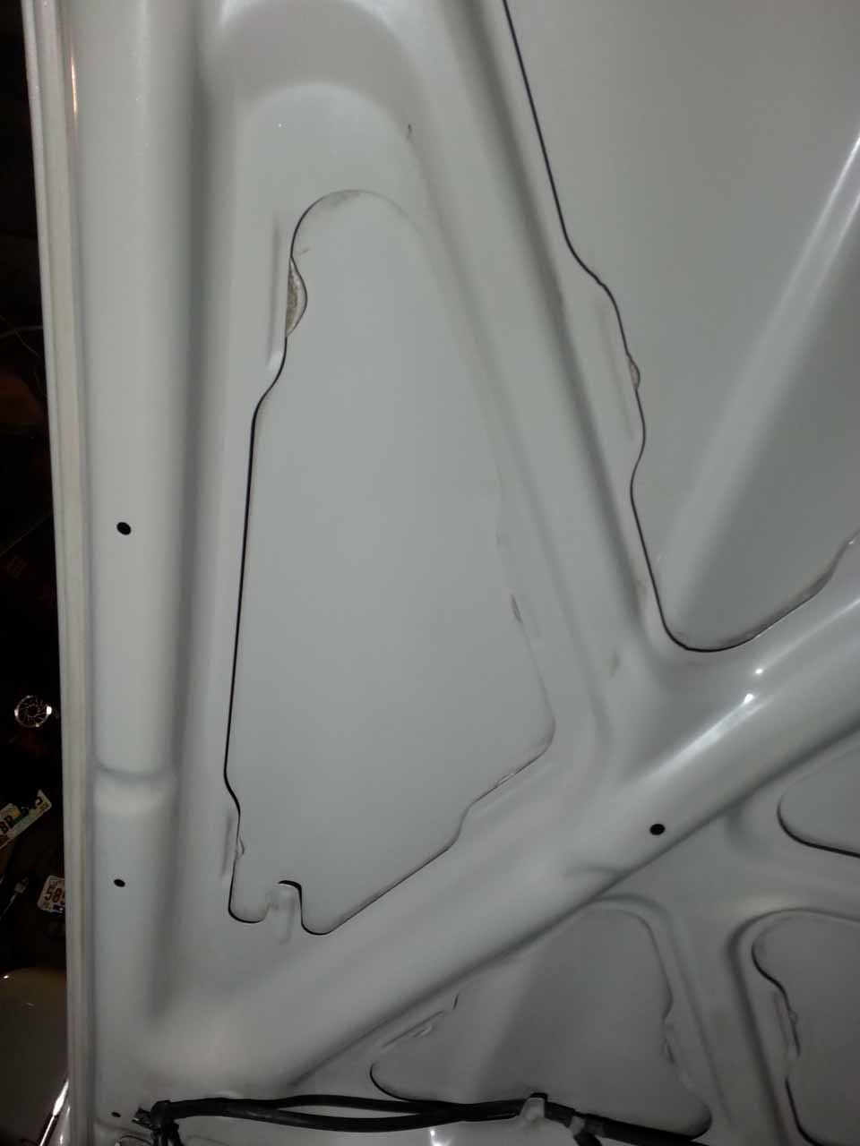

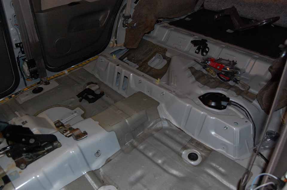

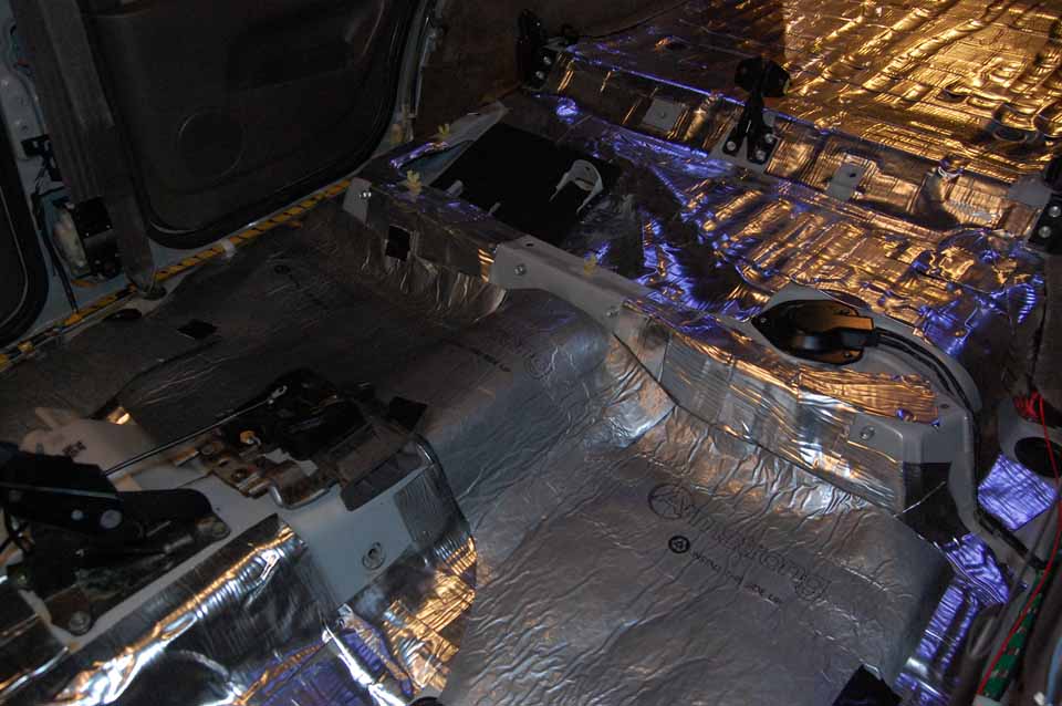

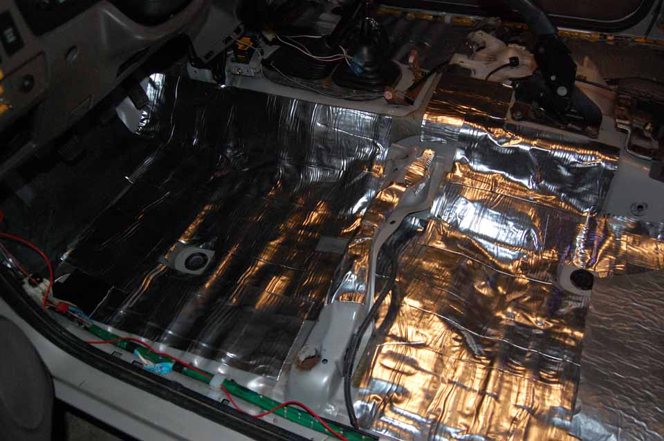

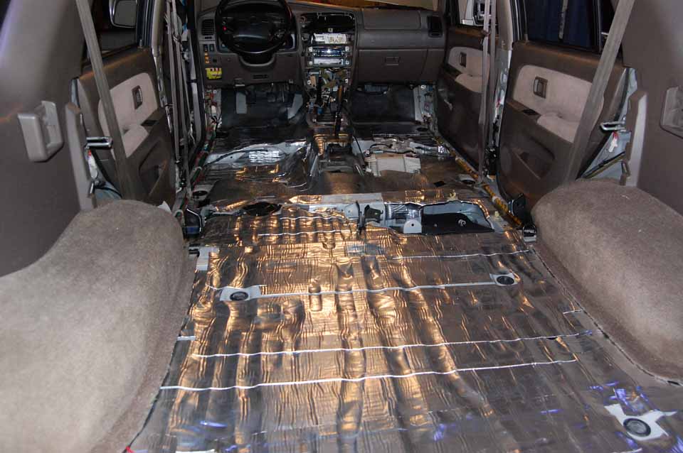

I got my peel n seal in today. It is actually a little thicker than my dad's fatmat and is cheaper. Hopefully it works good!
Before
After

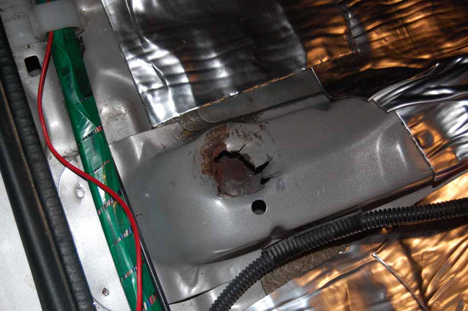

The damage from some fat guy busting out the seat bolt. The bracket is torn off on both sides and we're going to bolt it down with some JB weld in-between the seams.
The RS3000 ECU would up going behind the clock. The remote distance is at least 10 times better with the antenna in the A pillar!
