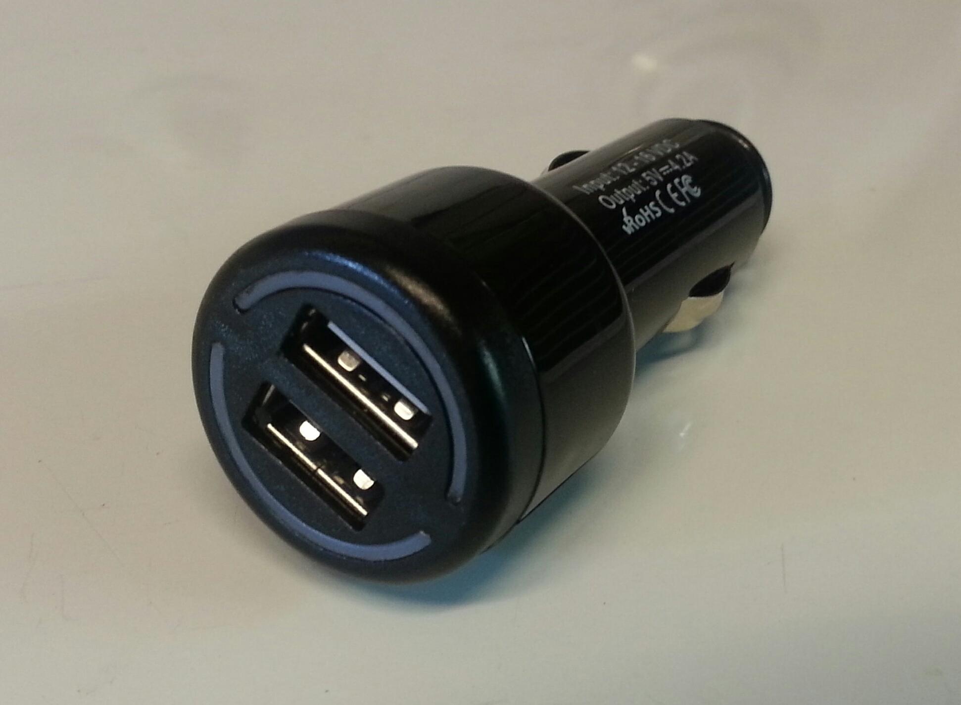

I bought a Blue Sea Dual USB socket this past week and wanted to swap the stock cigarette lighter out for it. When taking apart the console, I noticed the hookup on the back of the cigarette lighter wasn't anything that I was use to.
I'm guessing the green wire is the live wire with the other being the ground? Tried looking around and didn't really find an answer. If that be the case, can I just cut them off of that adapter and attach to the back of the blue sea socket?

If all you want is 2 USB power outlets, this will work unless you really want a USB hub or maybe I don't understand.

ETA: Yes, the green wire is positive, white is ground.

meh I just used a cheap radio shack 2 car adapter outlet.
run my garmin in 1 socket and a Verizon car charger/usb charger in 1 for my GS3.
dedicated micro usb adapter for the GS3 and a usb connector for the iphone 5 lightning adapter the warden has.
big bulky but it gets the job done for $12
