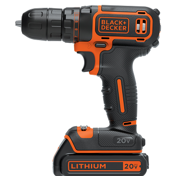

I HIGHLY recommend the procedure linked above for cleaning the MAF. Dismounting the air filter box so you can rotate on its side for direct access to the MAF screws is worth the minute it takes to do so. Unfortunately I began trying to remove the screws with the filter box in place using a stubby screwdriver and started stripping out the screw head before I realized how I should be working on it.
TWO RECOMMENDATIONS:
1) Use a adjustable torque drill/screwdriver to break the screws loose. I started with the lowest torque setting and stepped it up after a few seconds counter rotation was applied. I was able to get out the screw that had started to strip, think the ratcheting impulse force from the drill helped free it from being locked in placed. THIS WILL WORK BETTER THAN A HANDHELD SCREWDRIVER!!!
2) You don't need to disconnect the electrical connector from the MAF! Just leave it attached to the wiring harness and clean it under the hood with a towel underneath the sensor. I was struggling to extract the electrical connector and realized that was unnecessary.
