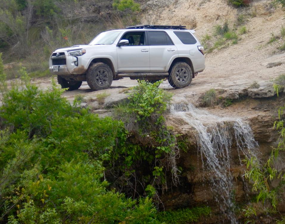

I'm looking for recommendations on the best and safest way to clean under the hood. I recently noticed mud and dirt are all over the engine compartment and i was tempted, at the car wash, to spray it down. I decided to ask for advice instead.
Thank you.

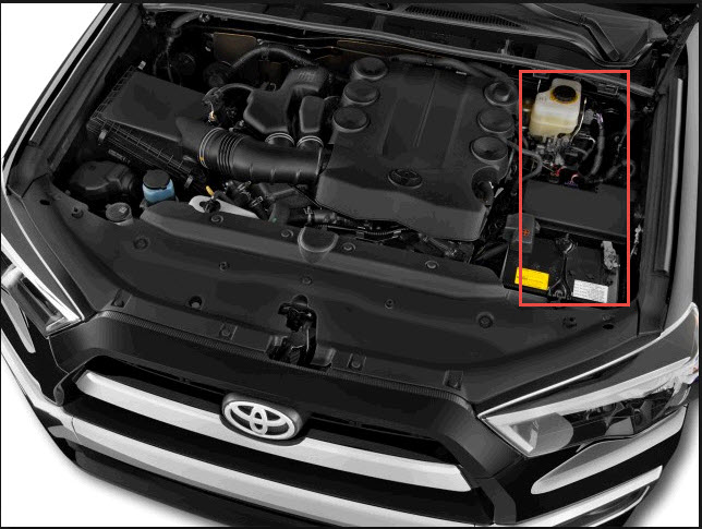

Ok so, simple green, low pressure and a sensible distance. In this photo i've marked the areas i think i should avoid. The unmarked areas seem ok to me. If im wrong please let me know.

You should be able to clean it without any worries. All of the electrical connection have O rings and are water tight. Just don't get stuuuupid.
The areas marked are fine as well, unless you remove the cover.
Mine has been washed with pressure numerous times without any adverse affects.
