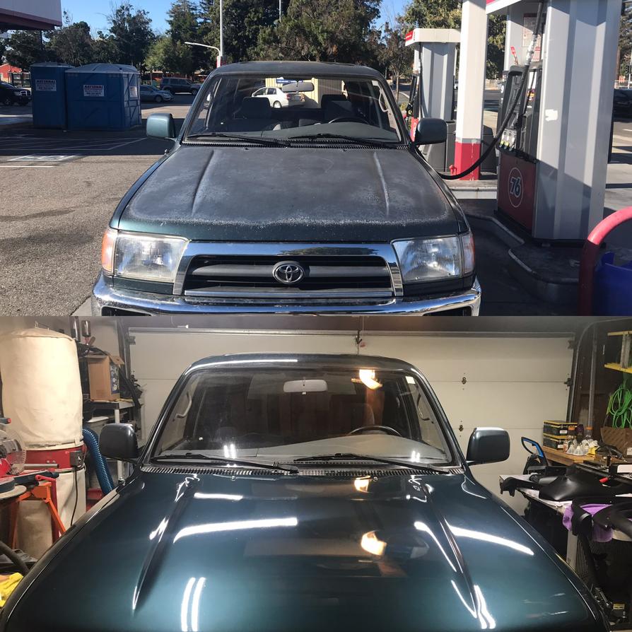

My evergreen pearl the whole hood and roof had no clear left and the tops of all the doors and fenders were all peeling too. Granted mine spent a lot of its life outside. I recently decided to give her some love and gave her a fresh new paint job. Here is a before and after.

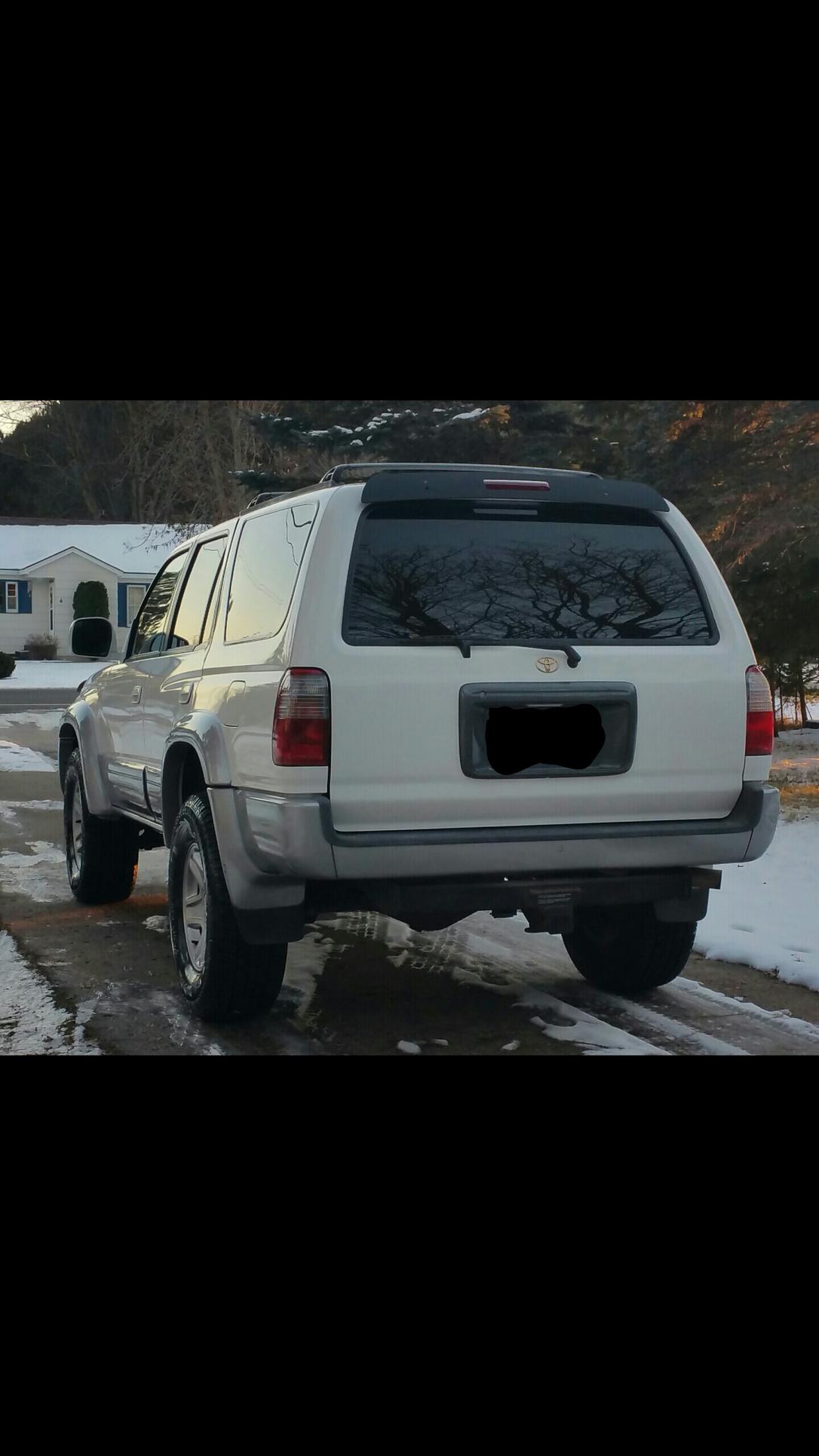

I just got my natural white 4Runner a little over a month ago in Wisconsin but it spent most of its life in Colorado so it's pretty rust free. That said, the clear coat was very dull and I think it's starting to peel a little bit on the roof. I think it had been a long time since the finish had seen any kind of wax or sealant. Not long after I got it I went over it with a clay bar, a fine cut compound, a swirl remover compound, and a nice coat of Wolfgang deep gloss 3.0 sealant. I'm really happy with the results considering how dull it was. Colorado might not use salt but they must use sand mixed with pea gravel because the paint, light housings, and windshield have plenty of little rock chips all over.
You can see the improved since along the driver's side.

[MENTION=247287]Hockeyjock[/MENTION] what did that paint job cost you if you dont mind me asking.
A lot of the non-metallic trucks are single stage on Toyotas... maybe yours never even had clear? (my original '90 Super White Camry was single stage from the factory too)

I think you're right and I wondering that as I was reconditioning the paint. Even while I was clay baring I was getting white residue that was suspect. I had to lightly wet sand a couple of spots where I removed my badges that also resulted in white residue. There is a spot on the roof where there are two slightly different shades of white and with the dull finish, I thought my clear coat was peeling. By 2000 I figured most if not all cars had a factory base coat/clear coat finish.
I work in the auto industry so I used a favor. I got it painted with good quality paint from a reputable shop. I got a quote from Macco and they said around $1200.00, and didn't want a cheap Macco job that would have the same problem a few years down the road just to save a few hundred bucks. The invoice said $2800.00 but I paid about $1400.00. The shop that painted my car said the paint materials alone cost almost a grand.
