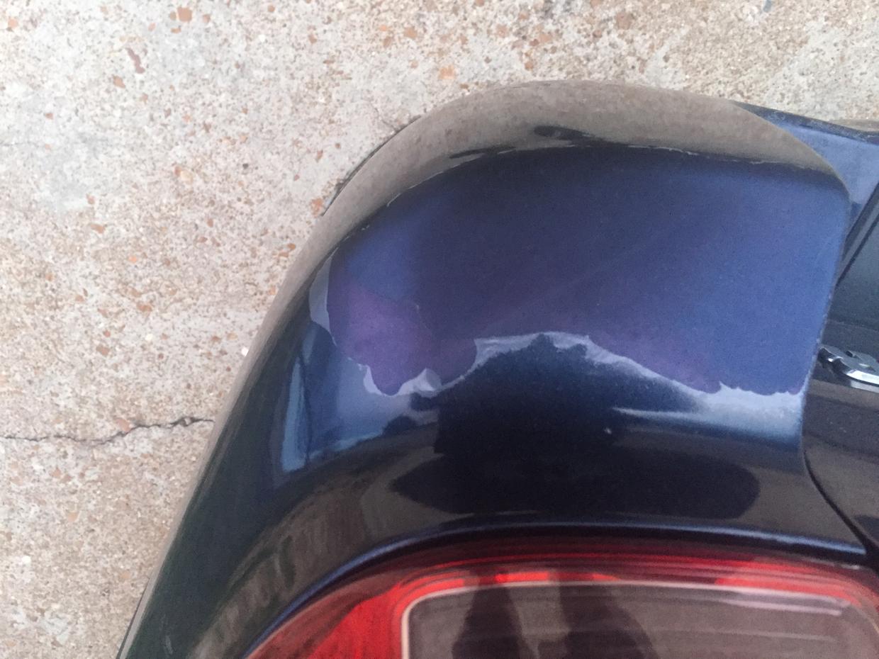

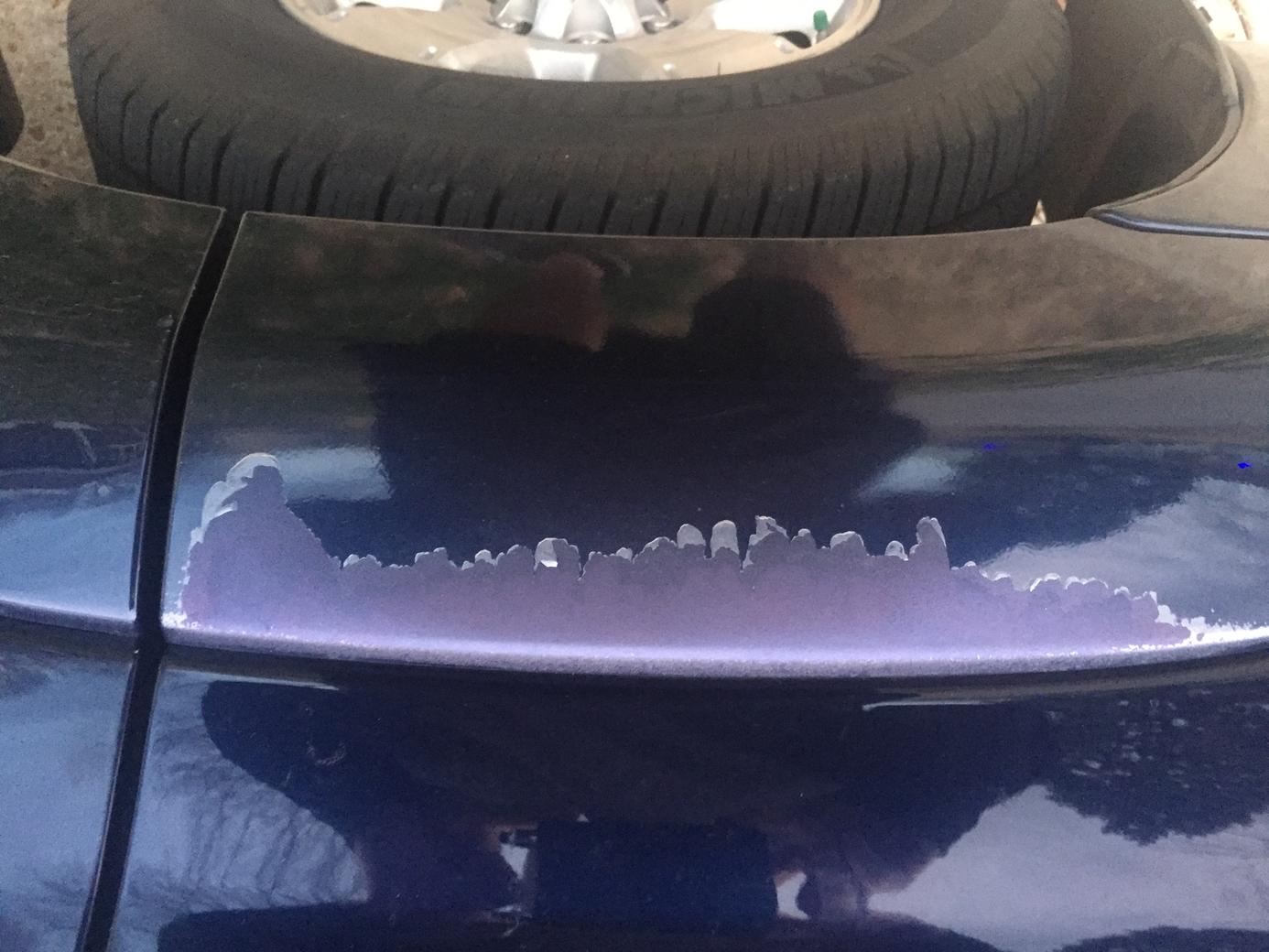

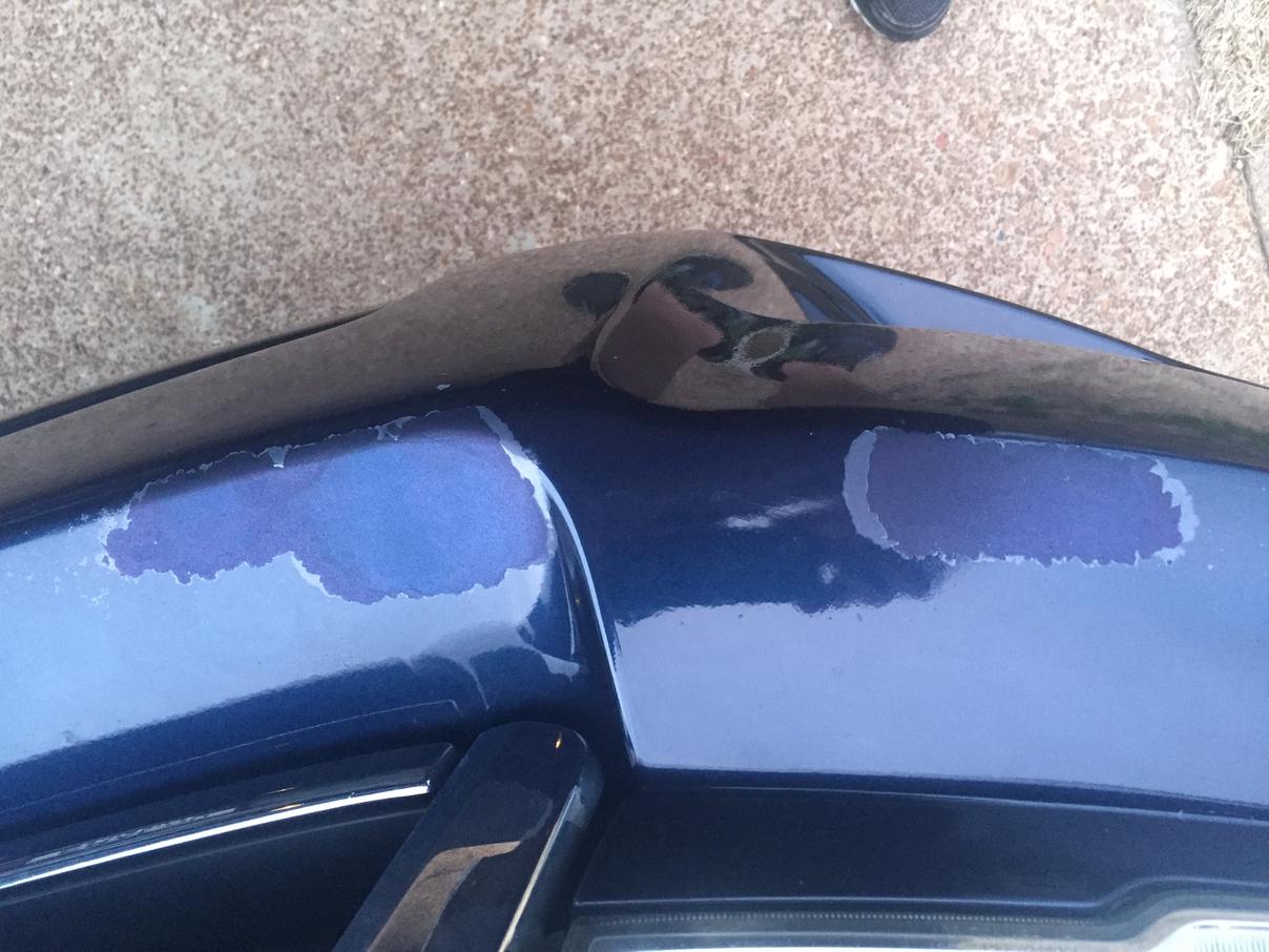

Same color, same problem. It drives me insane. Mines mainly on my fender flares on the right side, I think I’m going to wet sand them down and just spray more clear on them. Will this work? I’m not very knowledgeable at auto body stuff.
