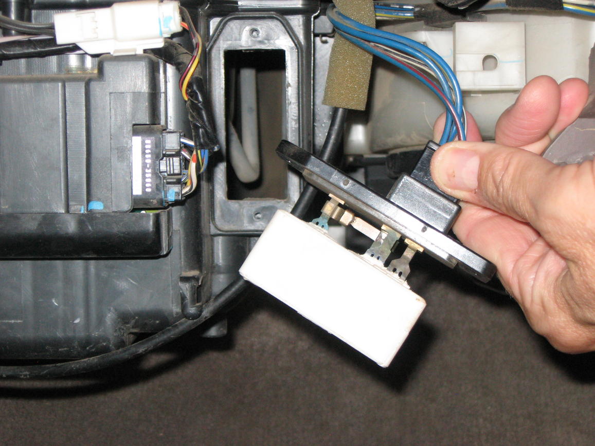

blower motor resistor

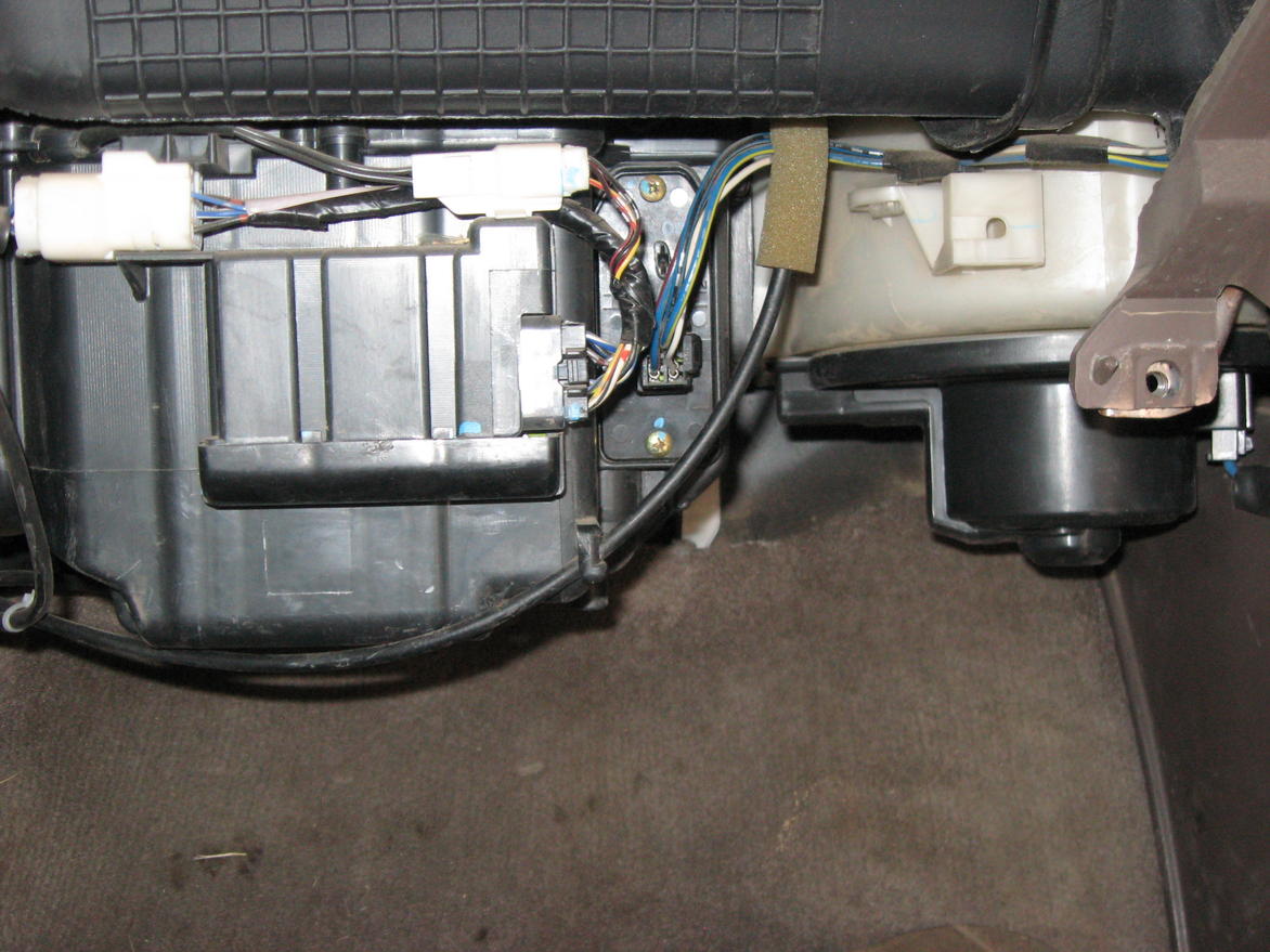

I'm posting pics for those who find this thread after striking out on finding good info so many times, like I did.... Tho, the info provided here is right on.

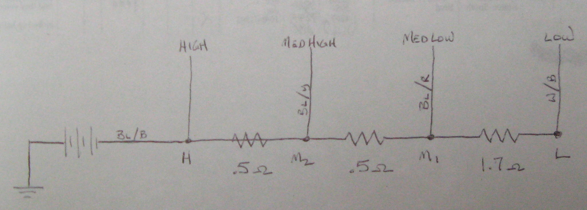

Included rudimentary schematic; note that any resistor that fails eliminates all speeds prior to that link.
Simple steps to replace:
1. remove glovebox.
2. remove crossbar.
3. there's the resistor module - 2 screws!
2000 4-runner 3.4L
