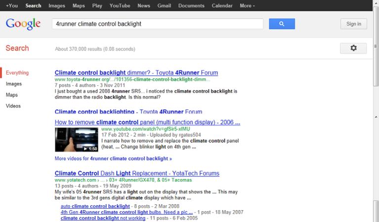

Just to clarify so we're all on the same page, I'm too busy to help you out but your too busy to type 4 words into the google and see what pops up. Thats ok, I did it for you.
Holy **** look at that, theres even a video!
As Trevloc said, this topic gets covered a ridiculous amount of times and always in a new thread. I'm not trying to be an ******* but just a bit of tough lovin so you learn how to use the forum to its full advantages.
