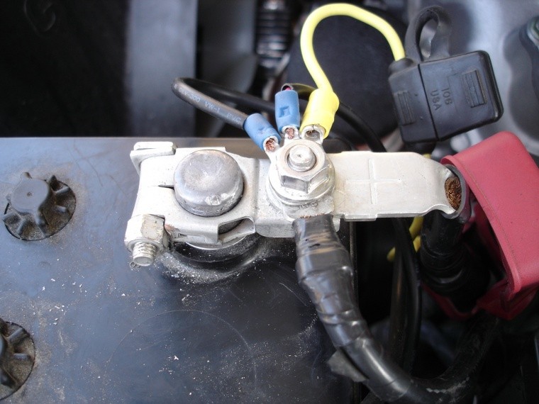

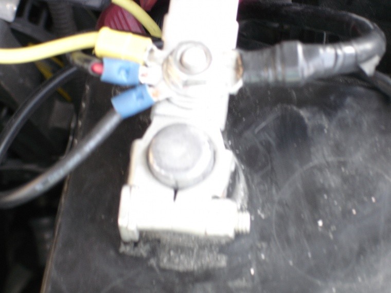

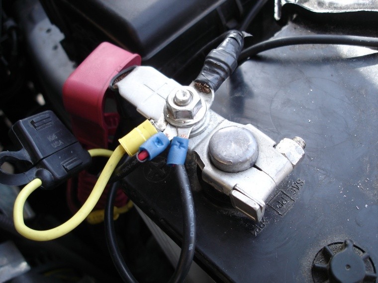

Hey Joe,
I have reciently installed my HID from xenon depot and have also run into this issue. I don't have anything else hooked up to my battery other than this terminals for the HID. Mine resets every few days with no consistancy. I can go a few days with no problem having my lights automatically turn off or from my fob with no issues. But eventually my clock ends up resetting itself. Have you learned or tried anything new since your last post?
