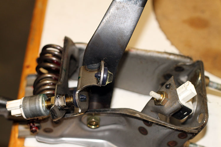

I had a similar problem and ended up putting a 1/4" pad on the back of the clutch pedal where it hits the safety switch. I'm not sure if toyota meant for the pedal to be on the floor to start the truck or if something bent over time, but the 1/4" pad did the trick.

That's what I was thinking of doing too. What did you use? I'm thinking of using furniture pads as I have a bunch laying around:

I used something similar, it's a rubber foot for electronics enclosures.
You can see it in this picture. The starter safety switch is the white plunger on the right. To the left of that you can see the clear rubber bumper I added. My guess is that over time the plate the switch is mounted to gets bent which eventually makes it so the switch does not get fully depressed.
