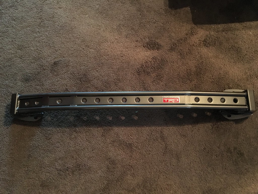

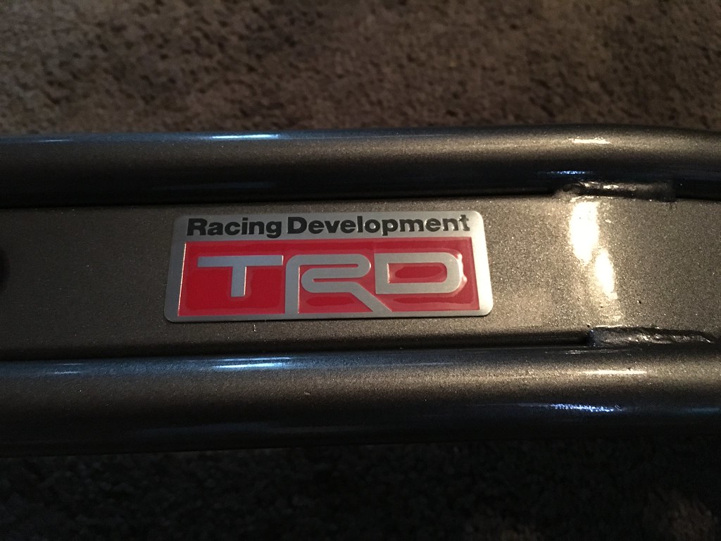

Genuine TRD parts anyone? TRD Strut bar, brand new.

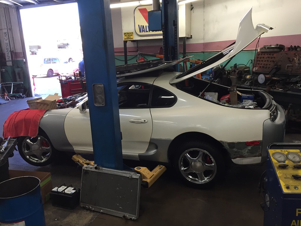

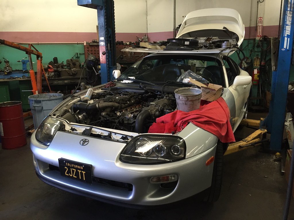

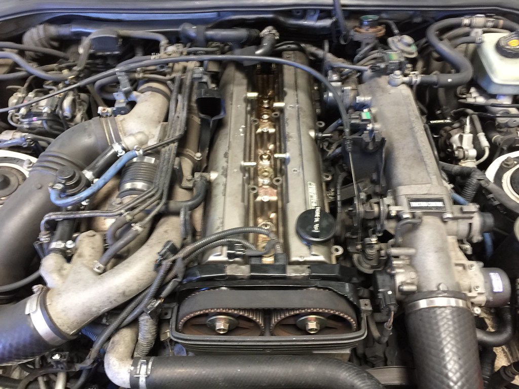

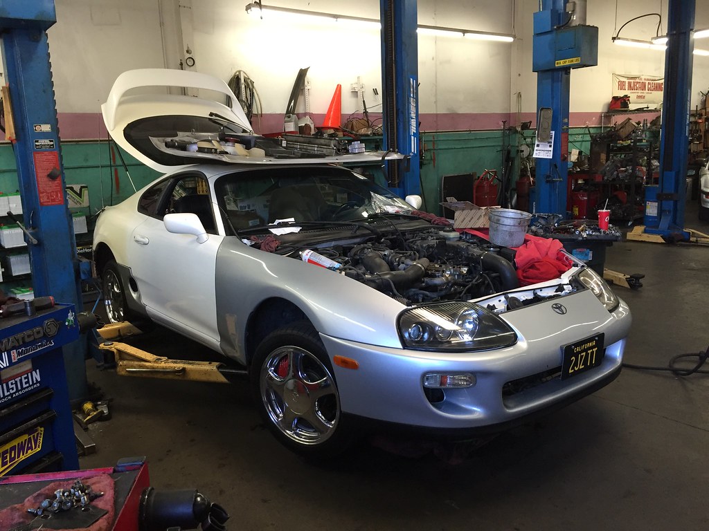

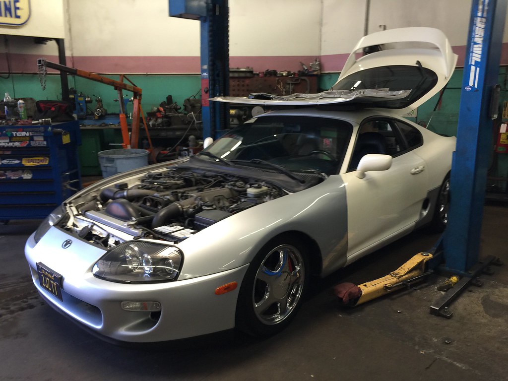

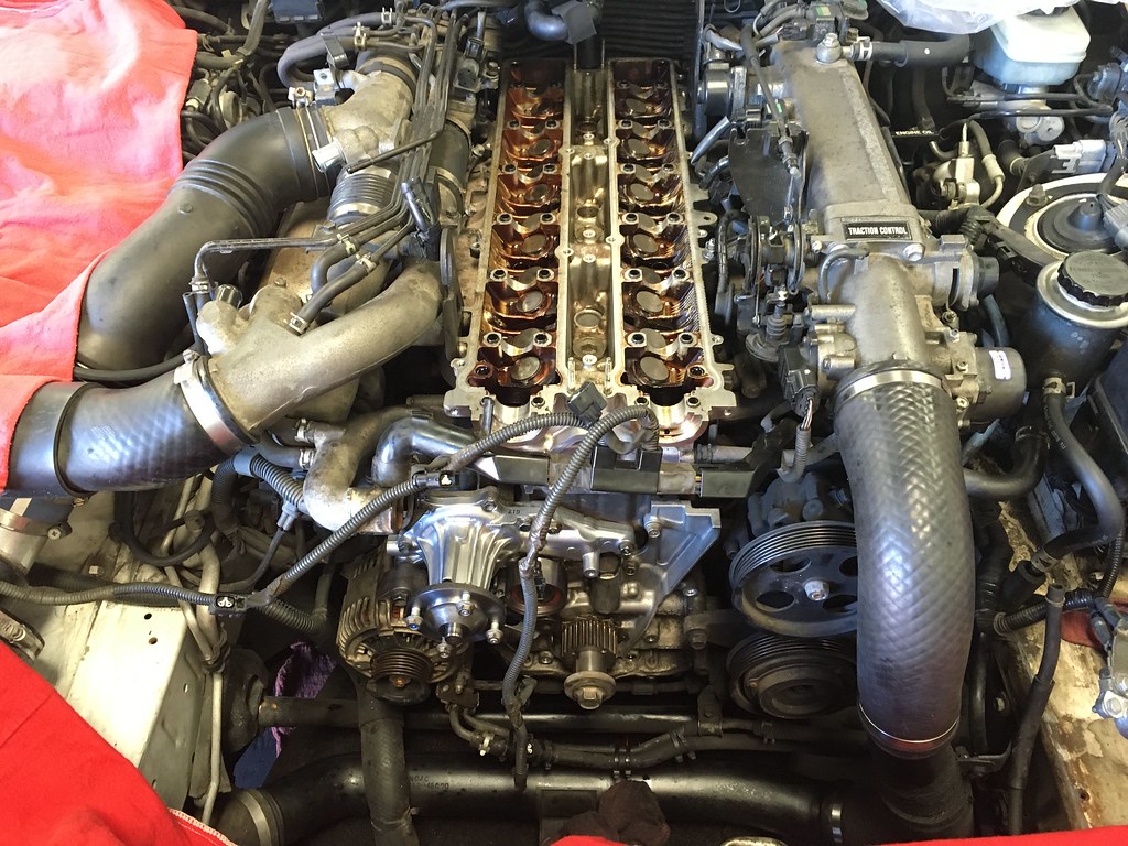

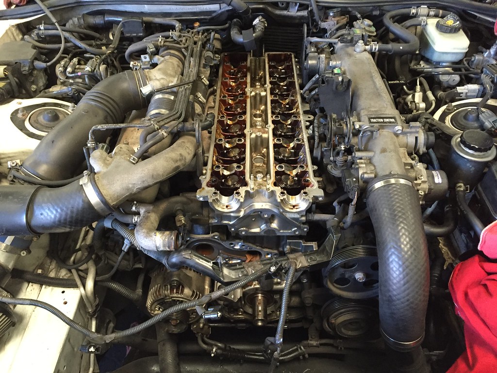

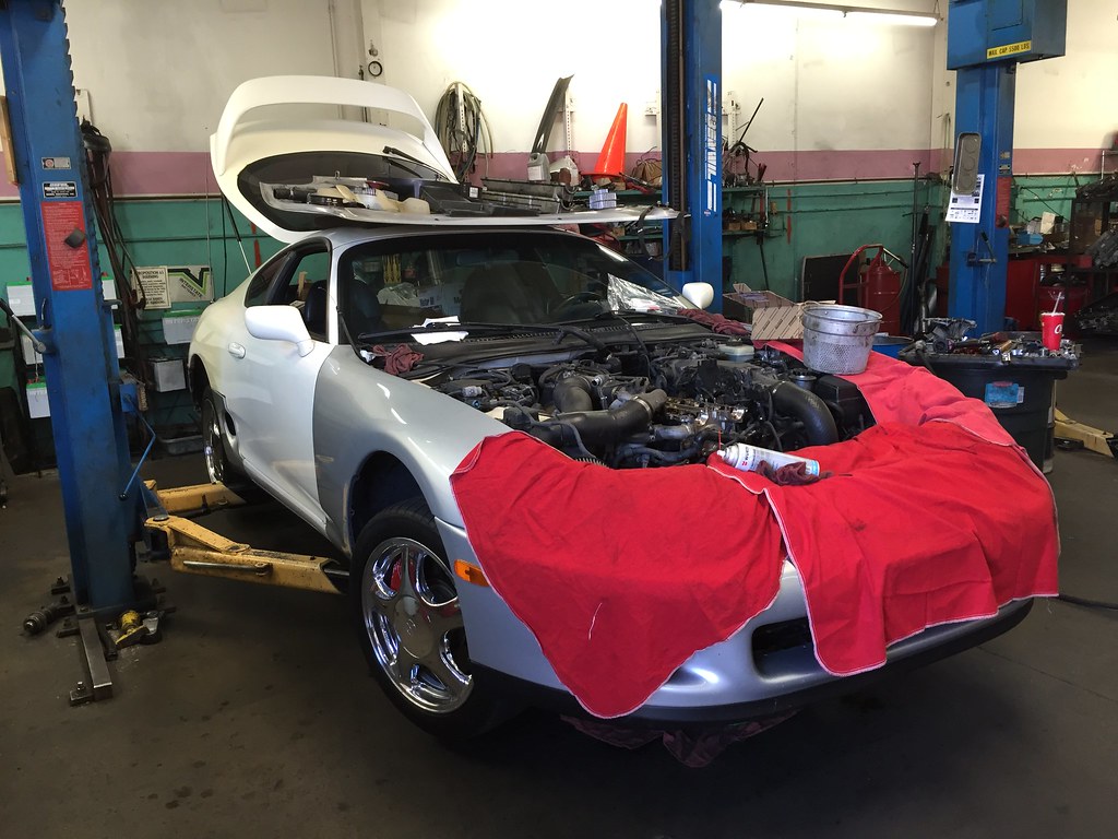

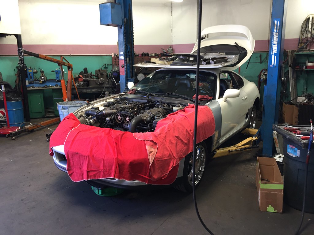

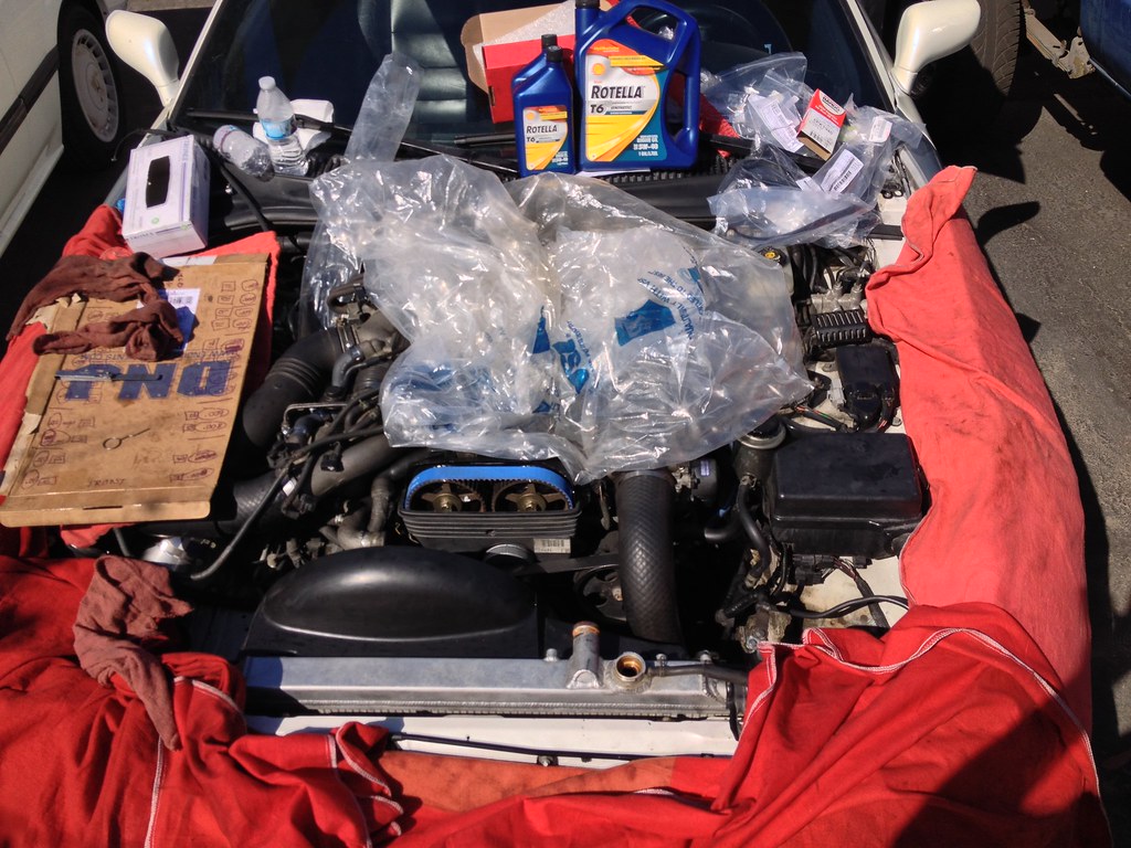

Lets get this show off the road and on the lift.
The hood is off and set atop the roof on some foam.
Coils removed
PCV hoses, bypass valve, serpentine tensioner, radiator, fan, and valve covers removed. Looks like previous owners didn't pay enough attention to the oil change intervals.

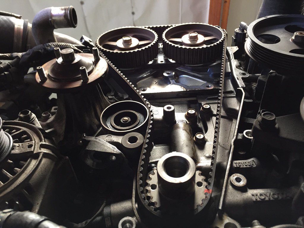

Timing belt covers and crank pulley removed

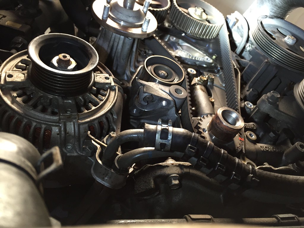

Timing belt tensioner out. Auto cooler lines have some zip-tie action going on. Of course, soon there will be no need for anything auto trans related :)
Fluidyne radiator sits beside the car for the first time in many years.

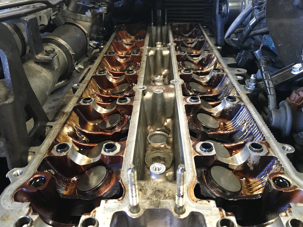

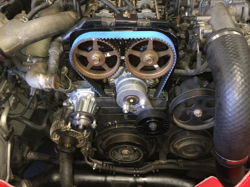

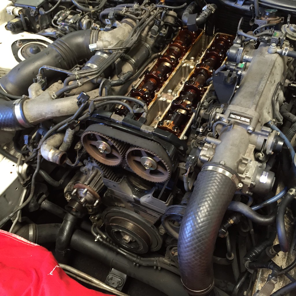

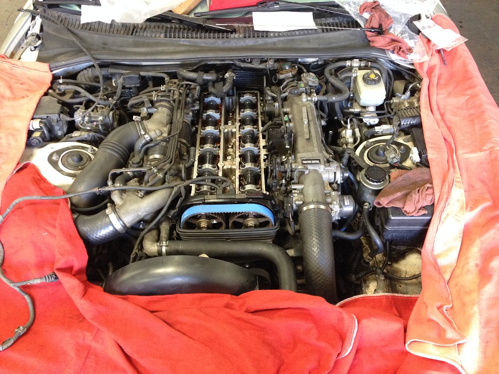

Camshafts and water pump removed.
These are headed for the parts cleaner.
That's all for today. Lots of cleaning and parts replacing in store for tomorrow.

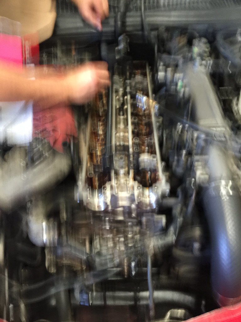

The photos are going to be limited more than I'd prefer to provide, for now. My only camera takes blurry images no matter what, otherwise there would be more photos of the stem seals going in, plus the camshafts going in and out for the valve adjustment. I actually borrowed two other phones just to get the photos for this post.
If your iPhone 6 Plus is producing blurry photos and falls into the eligible serial number range, Apple will replace your device's iSight camera, free of charge.

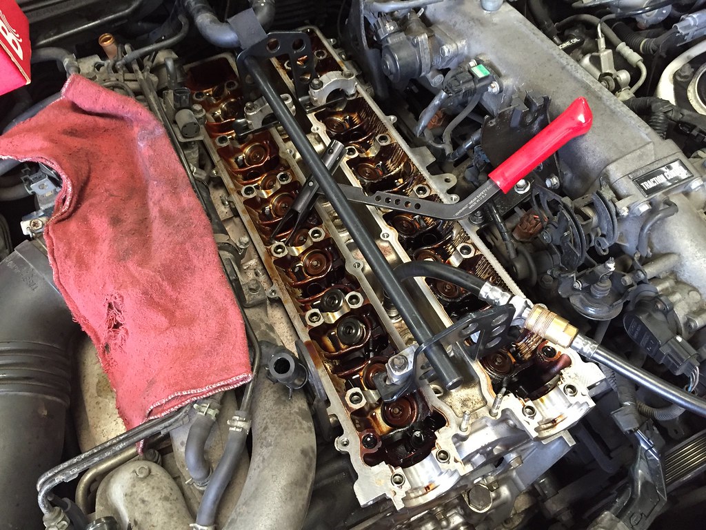

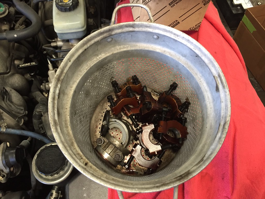

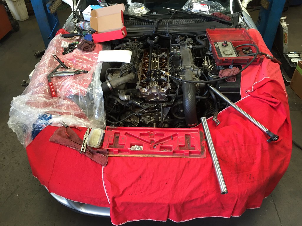

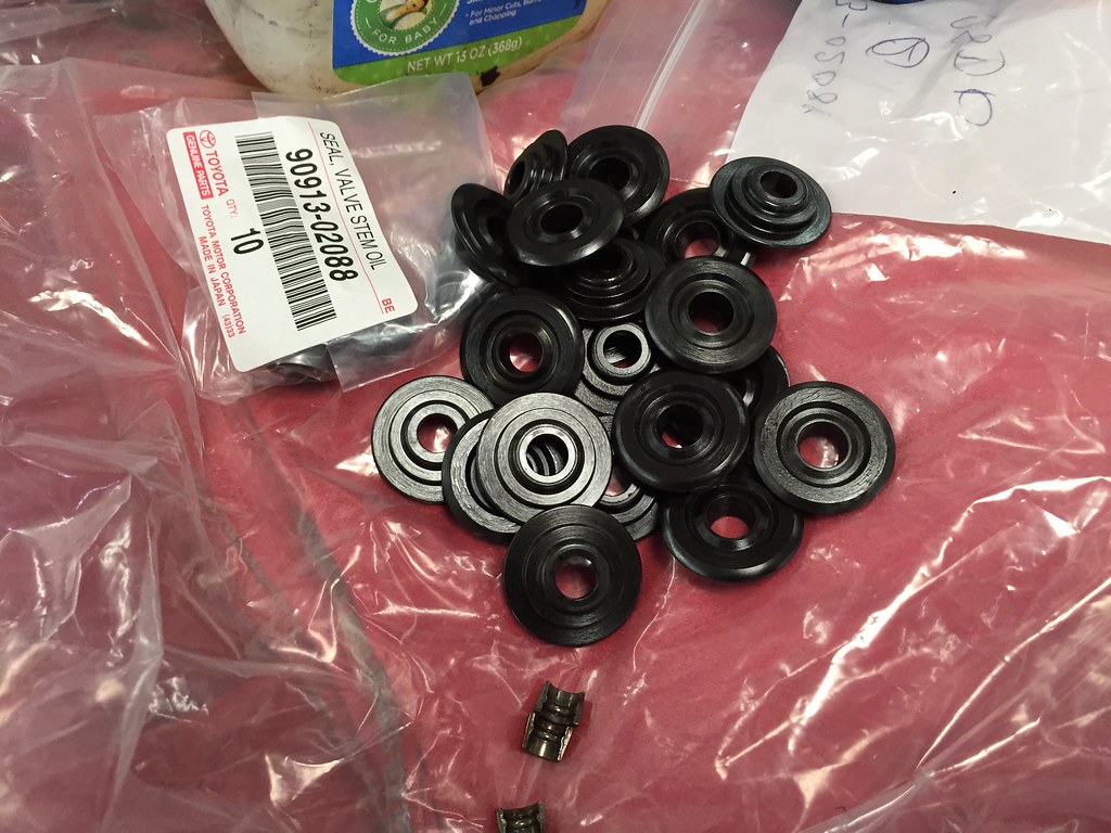

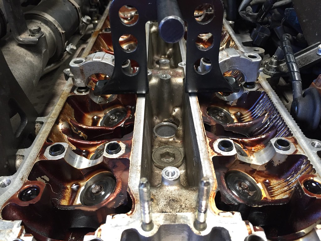

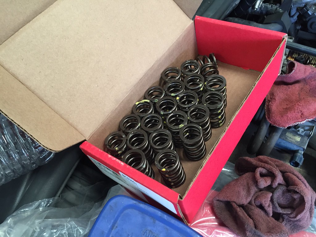

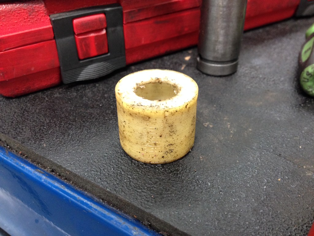

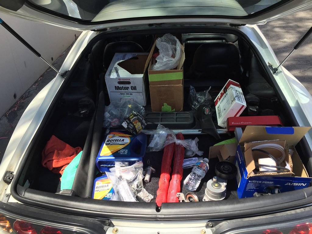

This manual valve spring compressor tool is interesting. The valve stem job took a few hours. Centering can be an annoying issue when trying to get the keepers back in, but we had a few extra tools. John owns a lathe, he rigged up a plastic bucket with a center hole big enough to keep the spring and retainer centered and slide the keepers in. He used a 90 degree bent metal tube with a rubber tip that holds the keepers, slide over the stem and listen for two clicks. The goop showing is petroleum jelly. The difference in strength between OEM springs and Brian Crower springs is definitely noticeable.
The plastic bucket
A leak down tester was used to keep the valves up. The motor has about 15% leakage across the board, which is good.

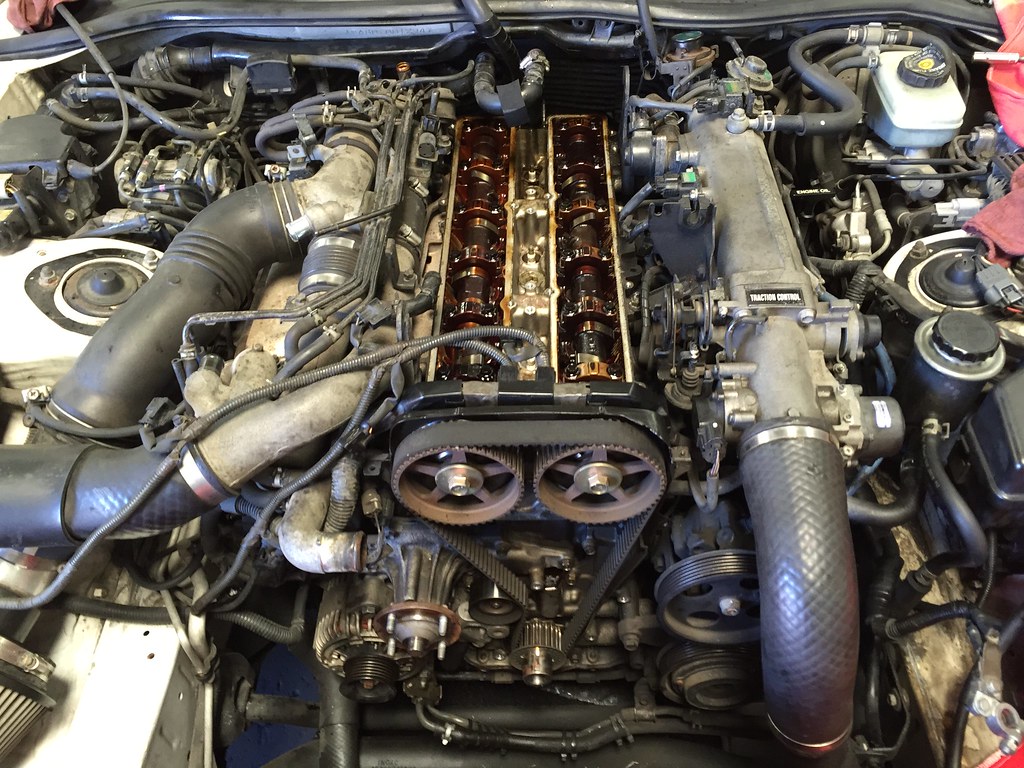

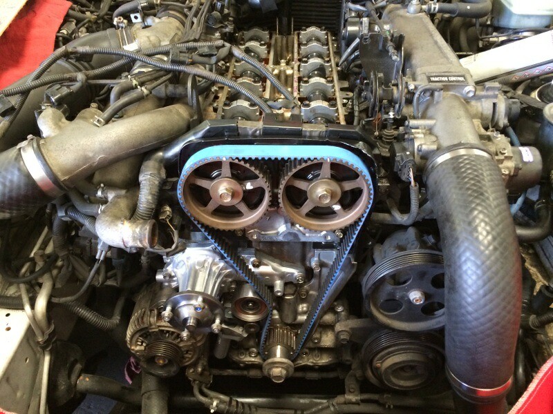

Was not able to get a picture of the first fitting of the camshafts, but the valve adjustment was completed using a variety of new shims. Valve clearance is now .012" Intake and .014" Exhaust.

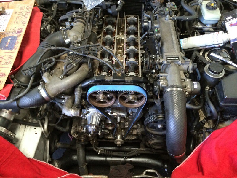

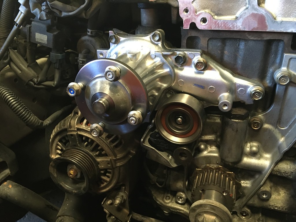

Brand new AISIN pump installed. PHR pulley bracket with Koyo idler installed. Crankshaft seal has been installed.
Valve covers, camshaft caps, timing covers, cam gear rear cover, and cam gears all cleaned up in the parts washer.
Tomorrow I will have some more time for reassembly, hopefully enough to get it driving :)
Using a lift is cheating, I thought this was going down in your garage again haha
Good work so far as always!
:bravo:
Nah, I don't own the tools to do this job. Lifts and proper tools are nice! Plus my stands are all under the parts truck so I'd never be able to get under the car.
Only downside is that I can't work on it at night :(

Here's the few pictures from today.

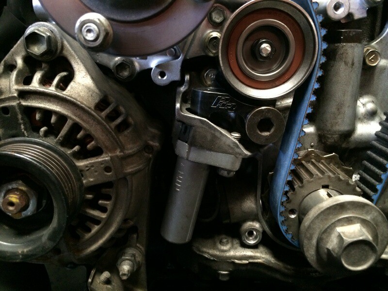

NTN tensioner installed
GSC S1 camshafts installed with cleaned up caps. New cam seals installed. Cam gear plate cleaned up and installed. Cam gears back on. Gates timing belt T215RB installed.
Crank pulley and lower timing cover back on. Koyo serpentine belt tensioner installed.

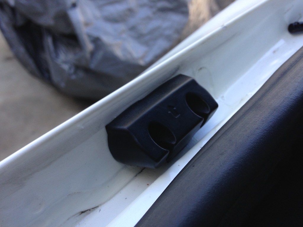

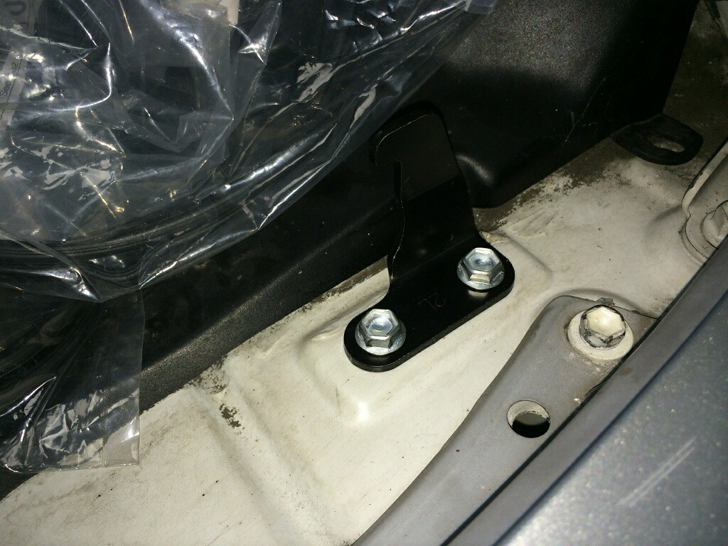

Last for now, the hooks for the hood hinges. These are what grab the hood and keep it from entering the cabin during a frontal collision.

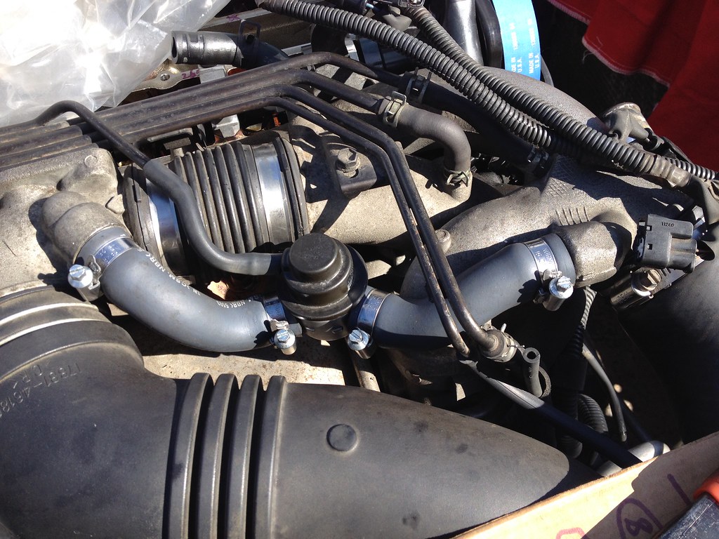

OEM bypass valve with new OEM hoses

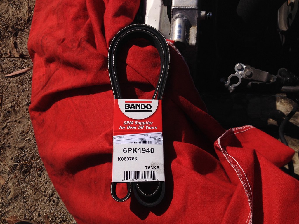

New serpentine belt

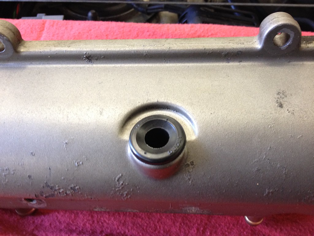

PCV Valve grommet installed in valve cover

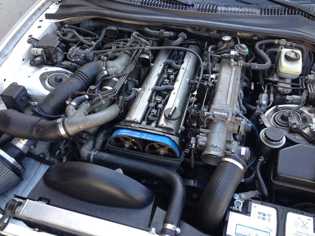

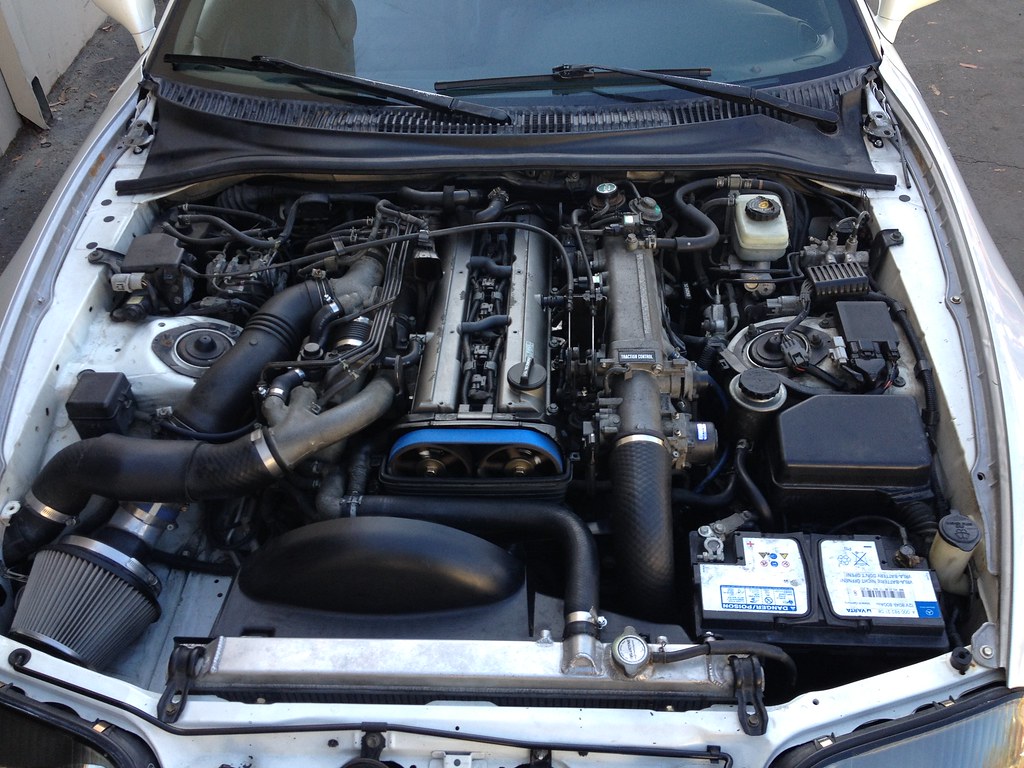

Filled up with coolant and ready for the new PCV hoses and valve covers.
Valve covers installed with new gaskets. Pain in the ass pipe reinstalled (if you've ever taken off the valve covers on a 2JZGTE, you know what pipe I mean). Shiny new pliable PCV hoses.

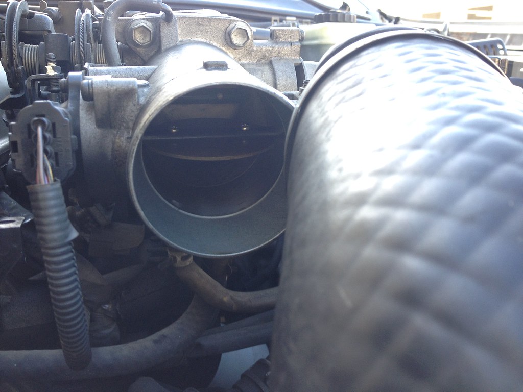

Throttle body is nice and clean.
And it starts!
<iframe width="560" height="315" src="https://www.youtube.com/embed/45SfKfeFvlI" frameborder="0" allowfullscreen></iframe>

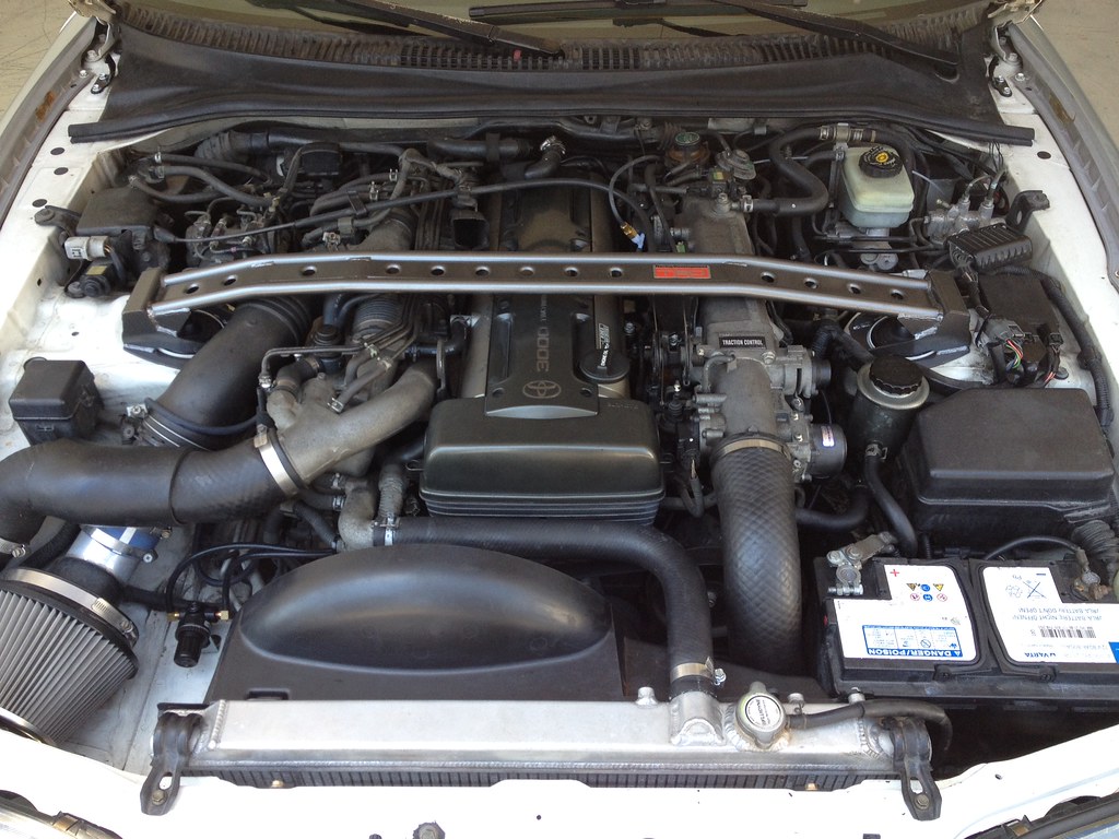

Back together plus TRD strut bar. The car has been a blast to drive, it pulls harder than ever. Manual boost controller installed next to air filter, set to 15 PSI. I will increase the boost to 17PSI when the wideband is ready to go.

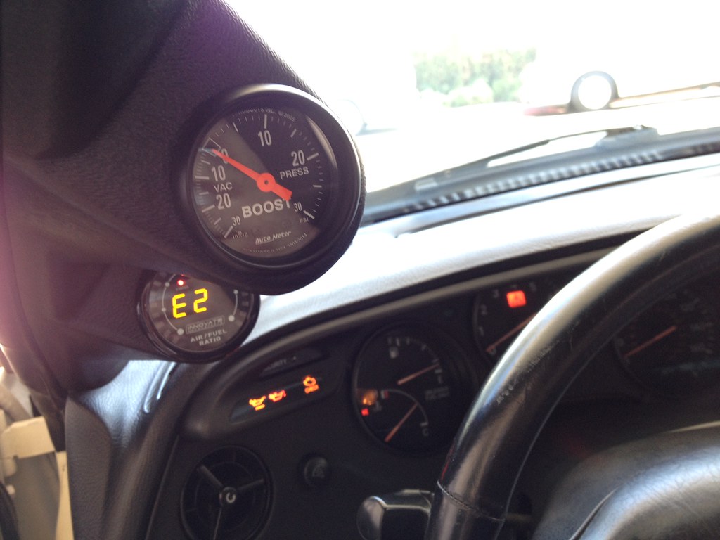

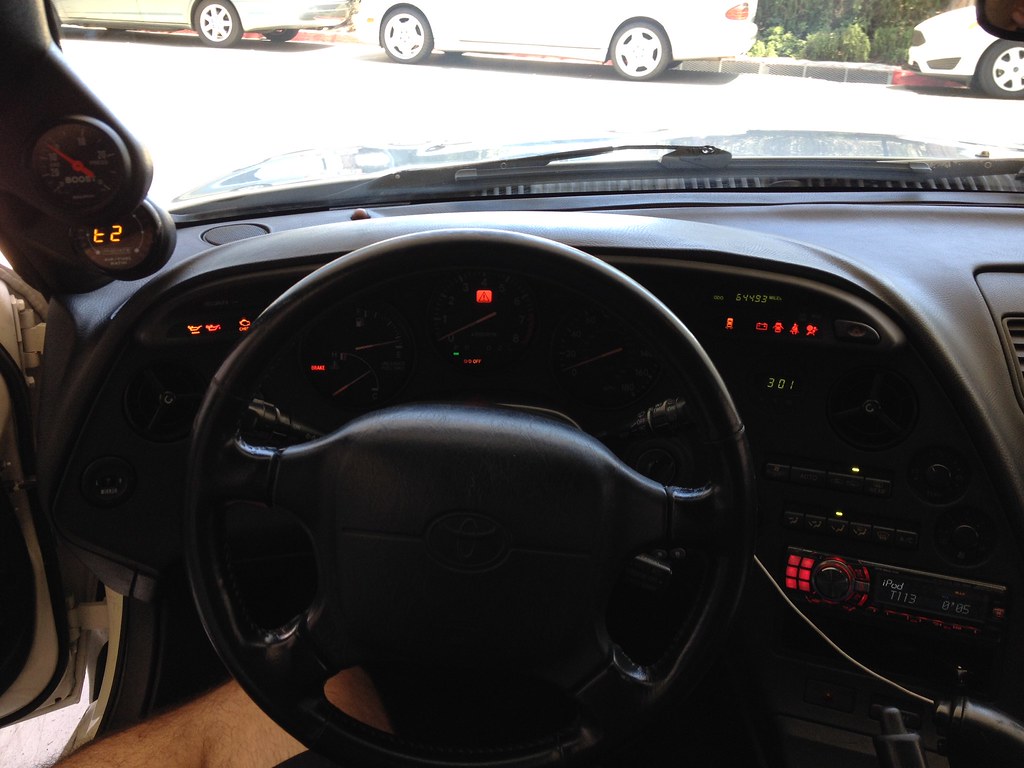

Lotek A pillar pod with Autometer boost and Innovate MTX-L wideband. O2 sensor + bung not installed yet so that's why E2 is showing on the wideband.

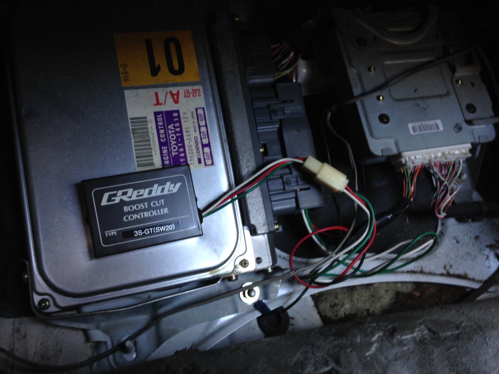

Pulled up the passenger side carpet and removed the ECU cover. There's already a Greddy Boost cut controller! How lucky is that? Now I have to return the one I bought.

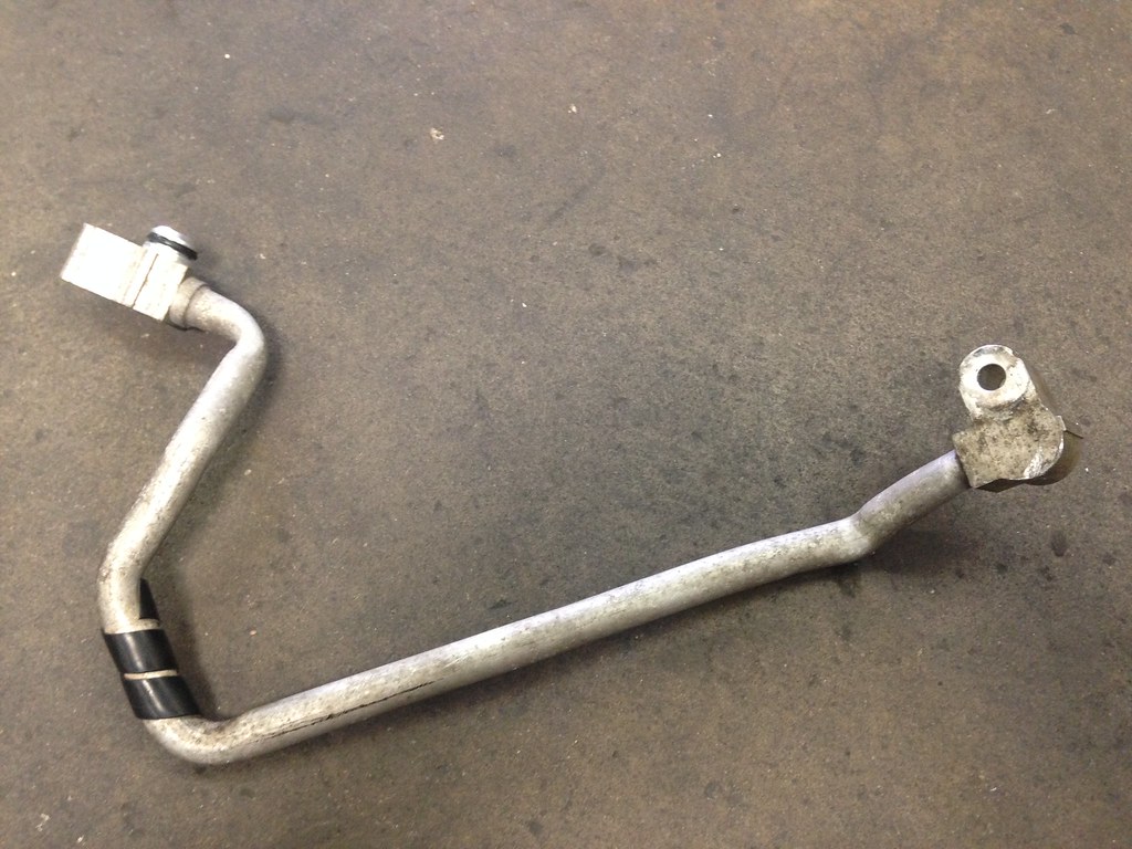

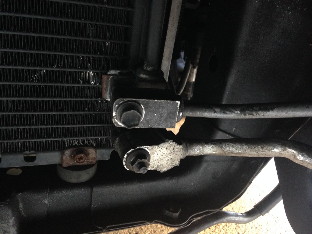

Got an AC line to replace the bent one that came with the car.
It showed up bent also, but my friend John bent it back with a vise and a small hammer.

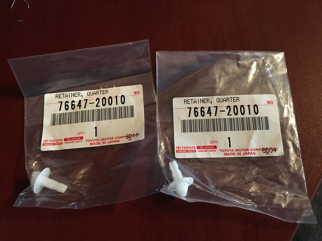

Front bumper retainer... again :( the other one flew off. This ones secured with nuts and clips :)

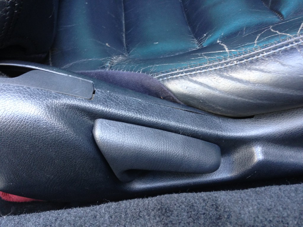

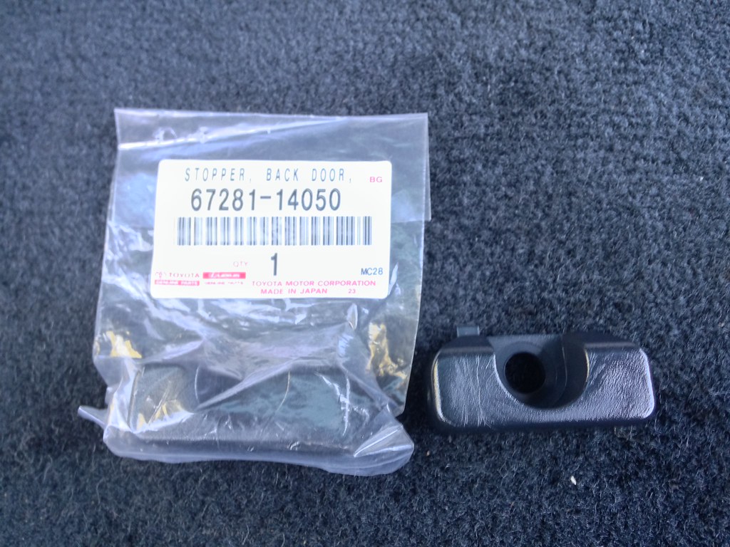

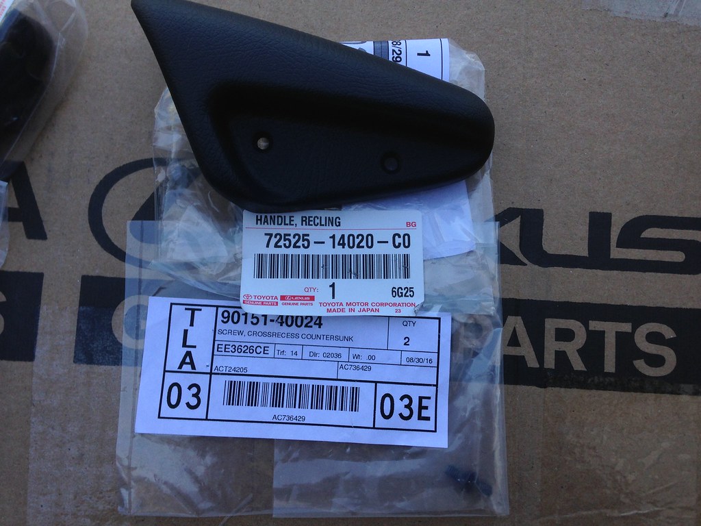

Both seats are missing the recliner handles. I got a passenger one from the US, but the driver side was discontinued. There was a surplus one in a warehouse in Japan somewhere, thankfully I got one of the last few left. Driver side is still on the way. Installed with 2 new screws each.

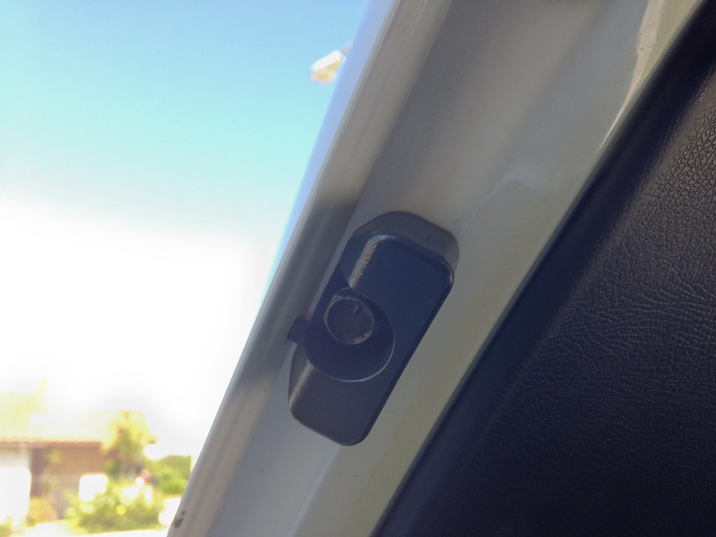

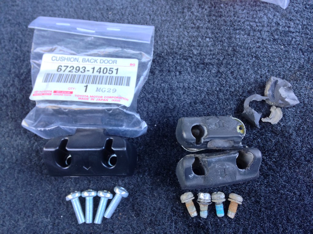

The rear hatch has been making some squeaking noises lately. It's definitely been exacerbated by the new camshafts vibrating the shit out of the car. I read up on the rubber stops going bad and had a look at mine. Both top ones were entirely missing, and the bottom ones were rotted and cracked.
The kicker was the screws holding on the passenger lower rubber bumper. They were stripped by someone in the past (not me, I promise). I had to rip the rubber apart and grab the screw with a vice grip, turning it ever so slightly until it came out. It was miserable, but I had a new set of stainless screws to replace them.
Top bumpers for the hatch side.

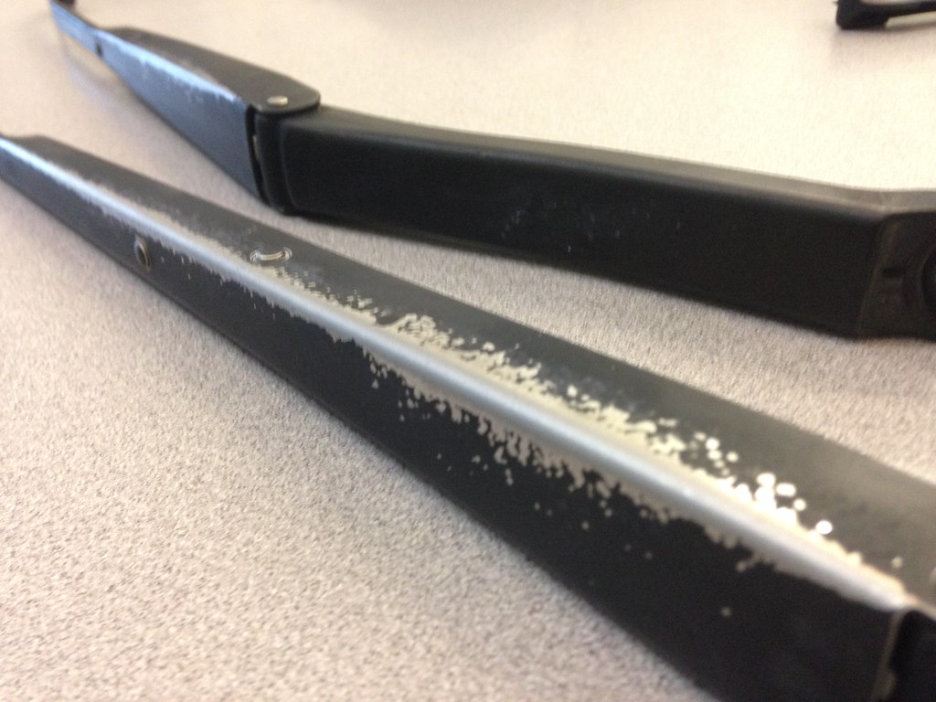

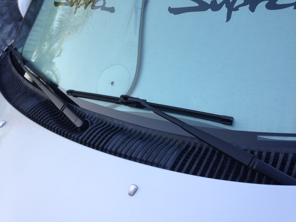

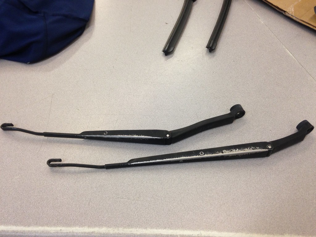

I had some cans of SEM trim black left over from past projects, just enough to repaint the wipers. First I sanded them with 220 grit, then moved up to 400 to smooth them out.

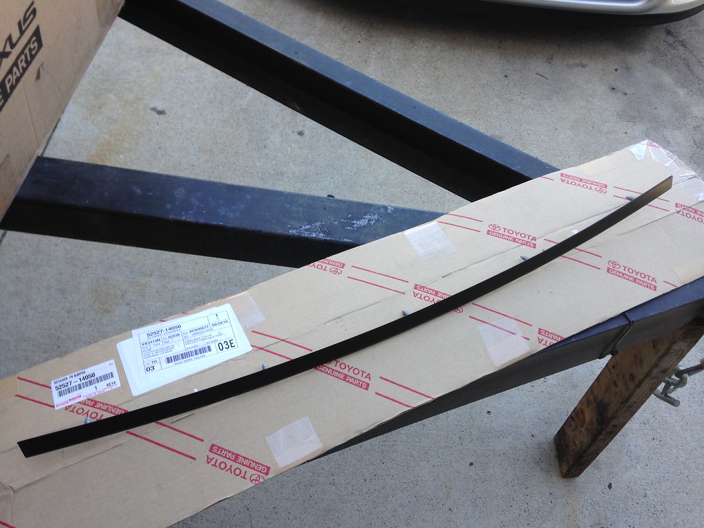

The cowl needs to be replaced because of the damage near the hood hinges.
