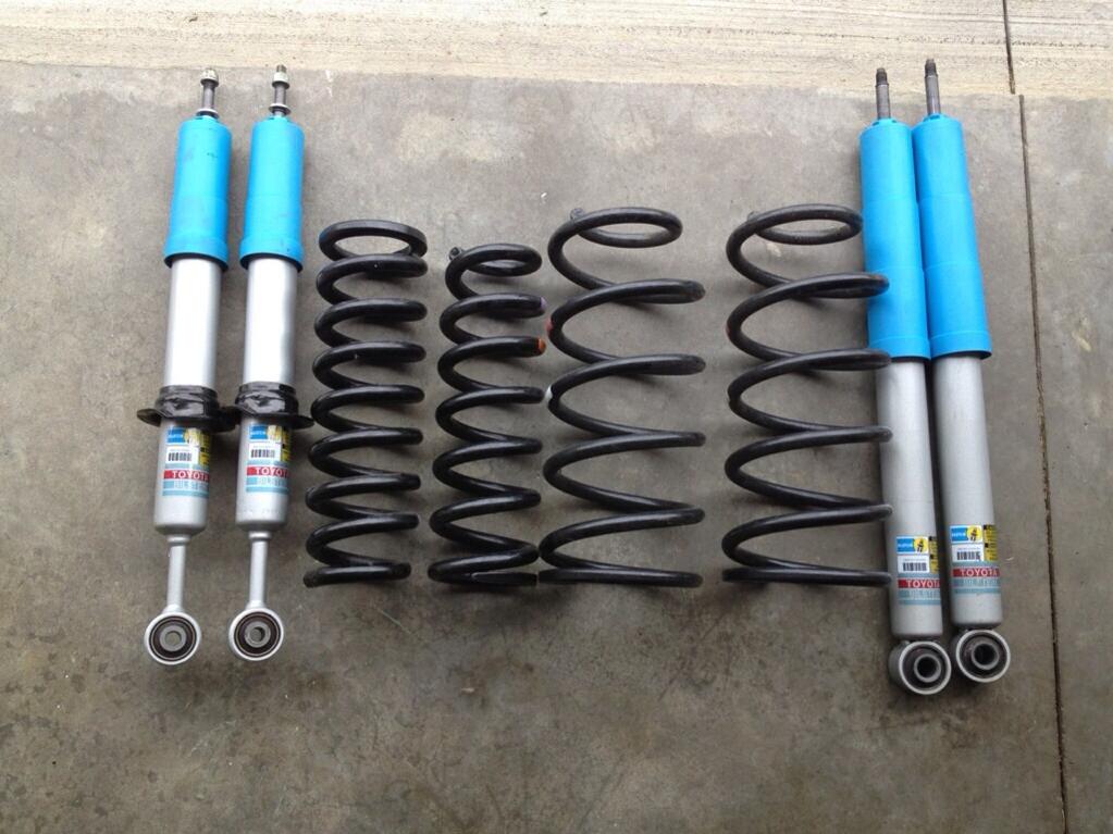

I have a 2003 SR5 4wd. I have a line on some springs and Bilstein TRD red shocks from a FJ Cruiser (2008 or 2009). Will these be a direct replacement? that height increase will they provide. How are the Bilstein TRD Red shocks? Thanks Phil
Has anyone used new FJ springs on their 4runner? I really don't want used springs and I can get a brand new set of Moog replacements for $133 out the door from advance auto.
