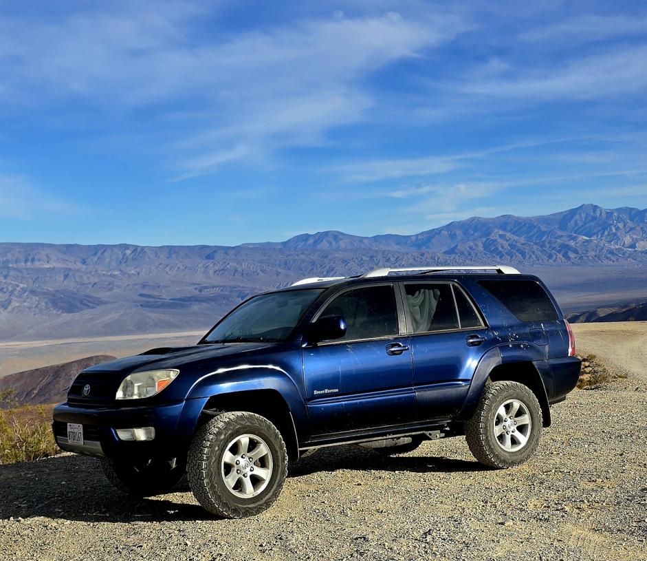

My rig. Bilstein 5100's, 2012 FJ springs off a 4 wheel drive model, small spacers in back and 3rd perch up front. I've been very happy with the height and ride quality.
